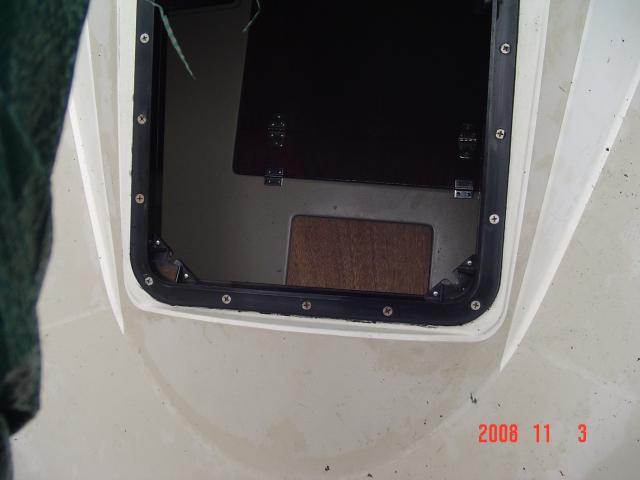

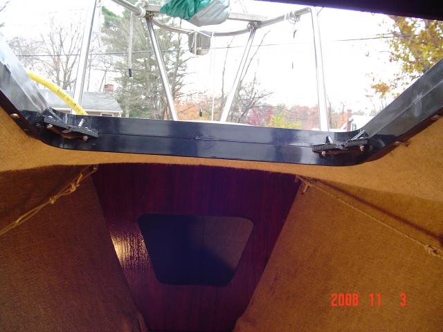

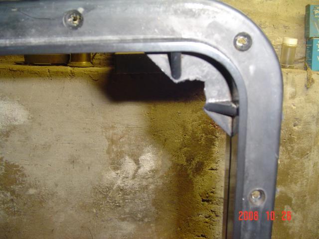

In 2008 I bought a used Gray Marine Mfg. forward hatch off Rudy to use as parts for the broken hatch on my 86 O'Day 222 and while I was at his store I asked him what kind of caulking is used for plastic hatches and he sold me a large tube of Dow Corning 795. The DC 795 caulking has the same adhesive qualities as polysufide caulking without the adverse effects to plastic hardware. Whereas the ingredients in silicone caulking is kinder to plastics, silicone really doesn't stick all that well. It acts more like a gasket than a true sealant. According to Rudy, most of the boat manufacturers use DC 795 for sealing plastic hatches, deck plates, and sky lights.
This morning I went down the cellar and freed the spout of that same tube of DC 795 that was still in my caulking gun, and much to my surprise, the stuff in the tube squeezed right out as well as the day I bought it. I've noticed that the 3-M caulkings have a long life span as well. Just keep them in a cool place down the cellar and they'll last a long time.
