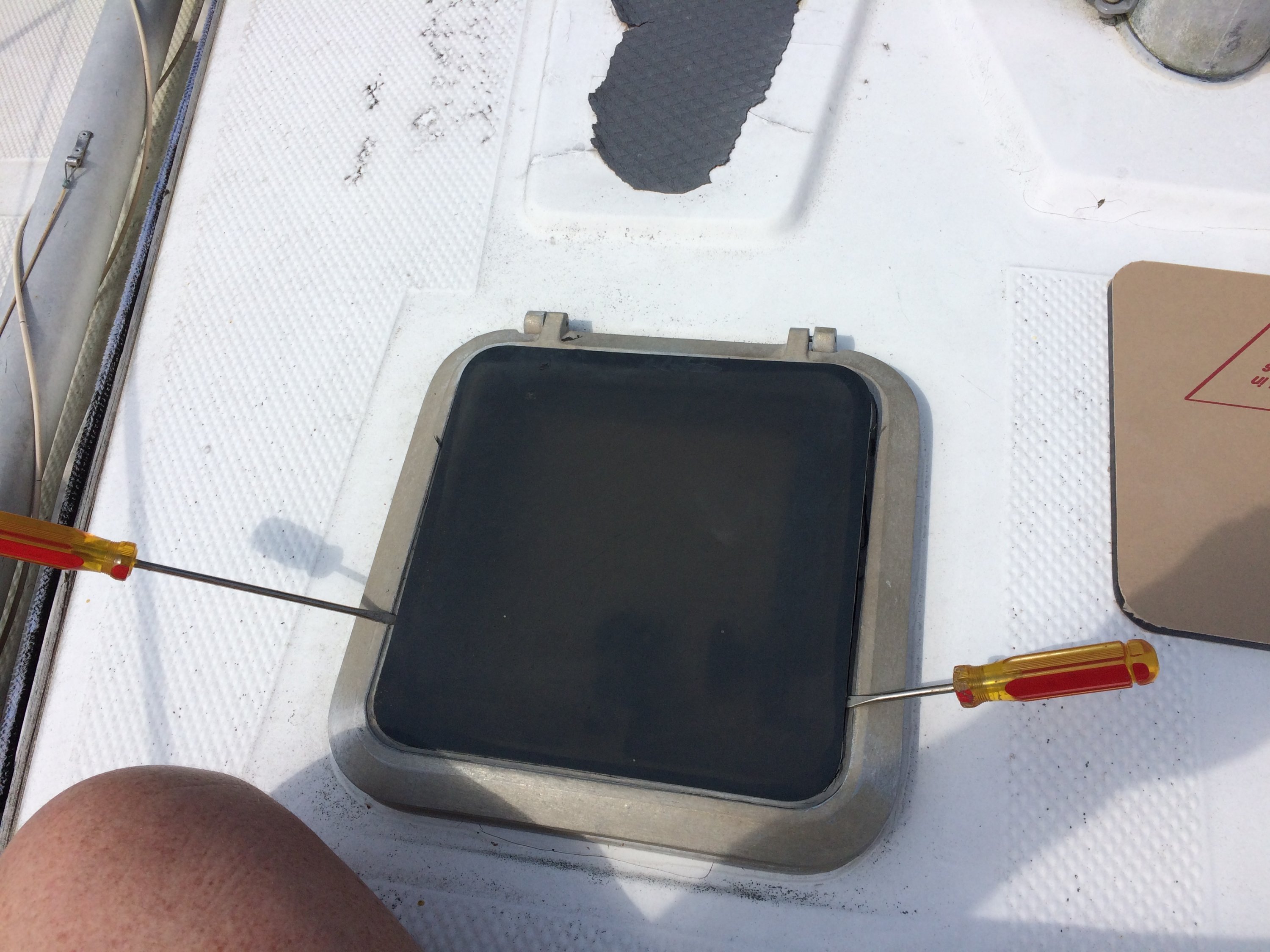

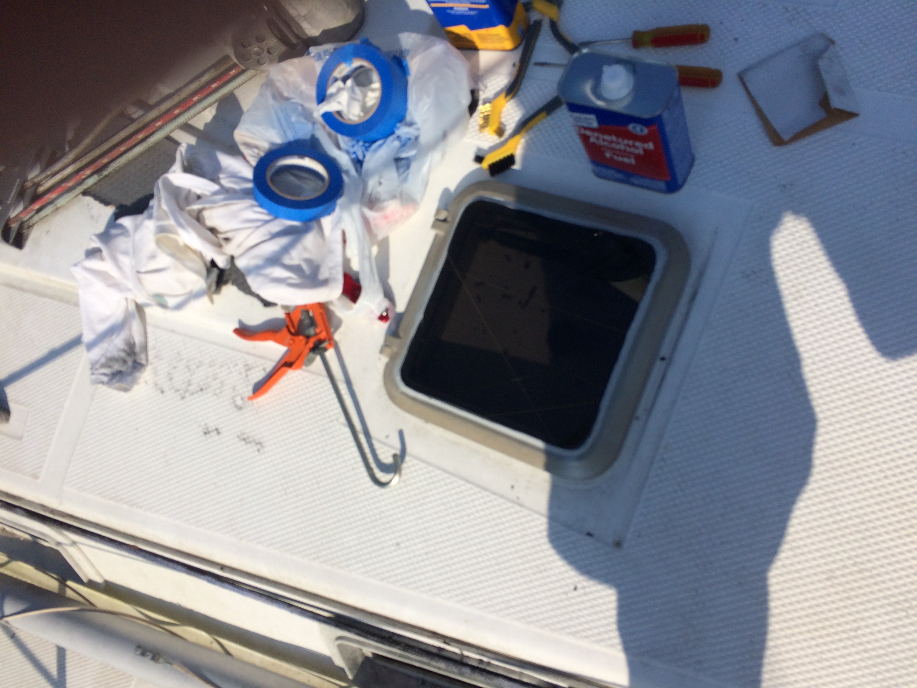

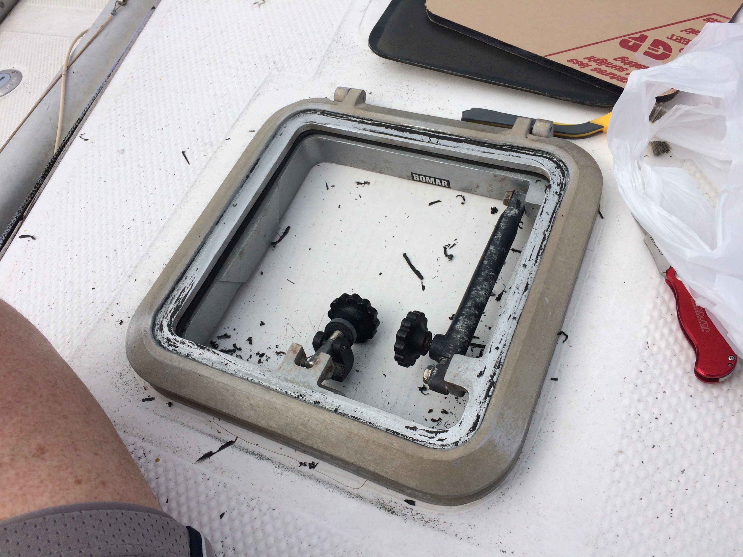

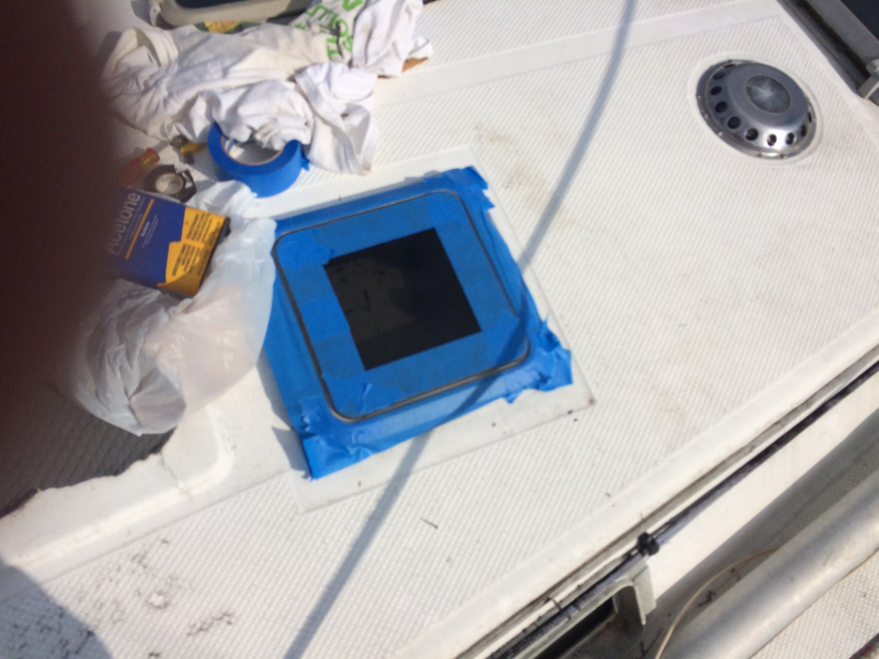

IMG_0375.JPG IMG_0372.JPG IMG_0373.JPG IMG_0374.JPG Got first Bowmar small hatch lens in yesterday. Much easier job than I'd thought it would be. Lens was easily levered out with screwdrivers.. After a good clean-up and some "Blue Tape" masking, the gray Dow 795 went in fine and new lens looks to be fine. The original lens was only 3/16" thick so my 3/8" replacement will be great. It stands a little proud of the frame, but does not look like it is too thick at all. Taped cardboard inside the hatch to keep the debris from getting into cabin.

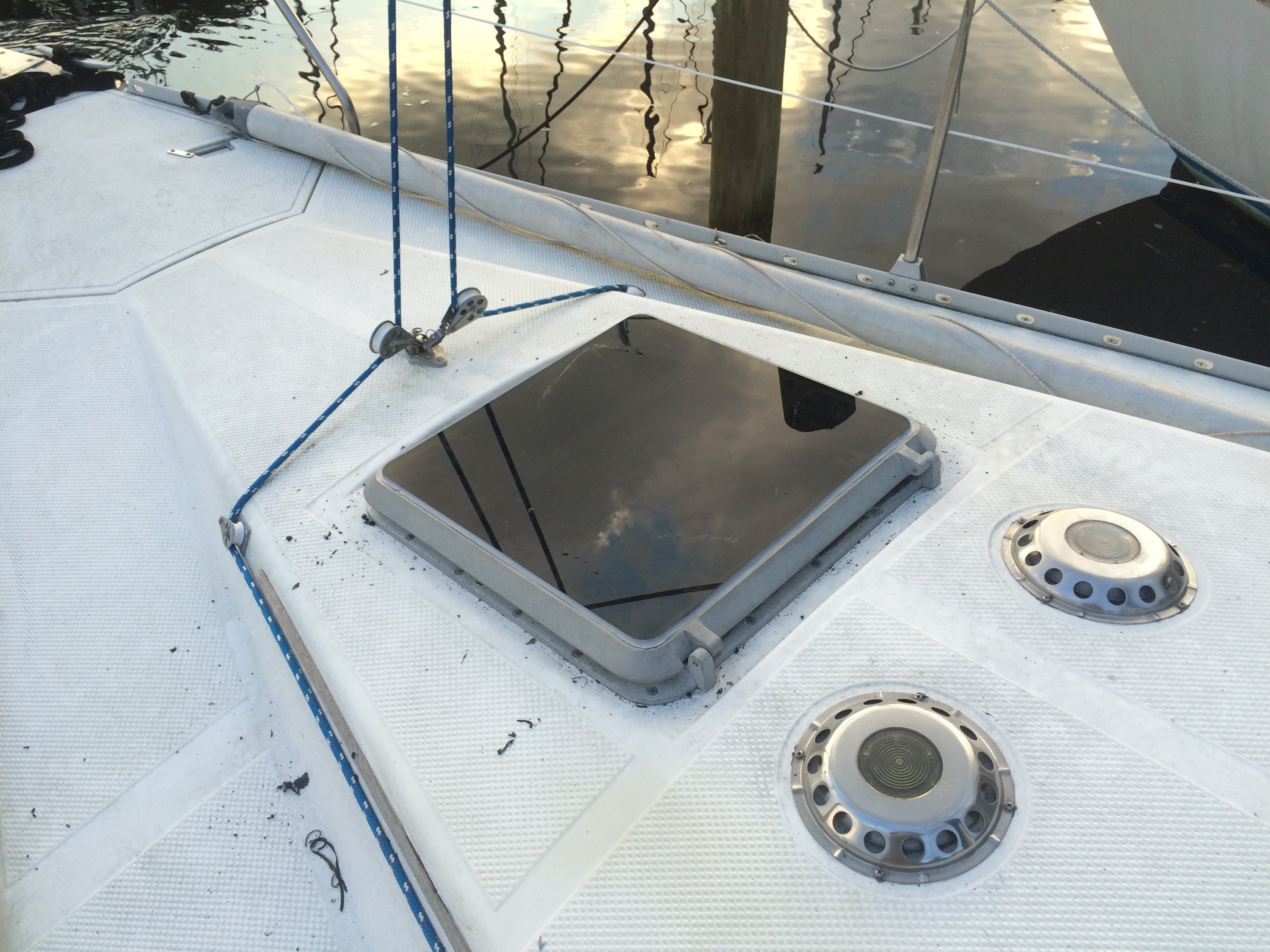

Finished replacing the lenses in all four hatches . Used just a bit less than one tube of 795 for the job. . Now the fixed ports look like hell.. Another project ..
