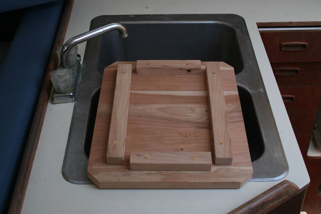

The sink bowls on my H34 are 13.5" x 9.5". I just made a cutting board to cover one of them. I used a 15 x 12" board and attached wood cleats to the under side to keep it from sliding off. The distances to the outside of these are 13 and 9". I haven't tried it on the sink yet – tomorrow.

Due to a change of plans I didn't get to the boat until today. The board I described earlier (15x12") does fit my sink. I only wanted to cover one bowl. Here are pictures so you can see what I have done.

Thank you very much, the pictures are very clear, this is exactly what I will do.
