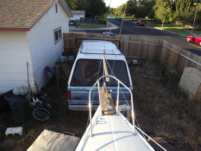

I spent a few hours today rigging my sailboat to fly two headsails. I have done this before, but now I have the time to accomplish this mod in a more professional way. Caution: this story involves Amsteel used as standing rigging. If you have a problem with Amsteel being used in this way, ignore this post. Also, if you have a water ballasted boat, and you are unable to remember to fill your ballast tanks, for heaven's sake do not imitate this rig set up, as you will no doubt drown untold innocent people. And you will give water ballasted boats in general a bad name.
Earlier iterations of double headsails on my boat has resulted in a couple of interesting effects. #1 is the ability to sail in very light air. This is due to a lot more square feet of sail area. Also, the effect of two headsails causes the mainsail telltales to fly straight out without a lot of twisting. It may be my imagination, but I think the boat points higher as well.
Anyway, I spent the morning and afternoon rigging my 26D for this project. Some of the design criteria were: the add ons had to be easily removed, the weight had to be kept to a minimum, the sprite had to allow use of the anchor and anchor platform.
The easy off solution involved snap shackles and egg hooks at all attchment points. Amsteel was used for the foremost stay, sprite sidestays and bob stay, the adjustable backstay was redesigned with Amsteel as well. And while I was at it, I installed Amsteel on the lifelines, which I have not had on the boat for over 5 years.
The sprite is made of wood laminations and was created by Joel of Ruddedcraft. The sprite needs to be bushed where the pip pin goes through it as well as coated with varnish. For the purposes of cutting and installing the Amsteel, it will work for this weekend.
There is a tensioner on the foremost stay, an overcenter type. There is a turnbuckle on the bob stay, and turnbuckles on the sidestays. The backstay opposes the masthead foremost stay, and has a 4 to 1 block and tackle. (there are pelican hooks on the lifelines to adjust their tension).
Tomorrow I intend to get the boat out of its storage spce and clean it up. I will fit the sails on it, and work on the sheet angles. I intend to go sailing early Monday when the catabatic winds are best.

Here is the sprite. It is attached to the bow pulpit, in the same holes that the mast is pinned to when in transit. I have a large diameter pip pin for this purpose, the same size as the one used on the mast base/tabernacle

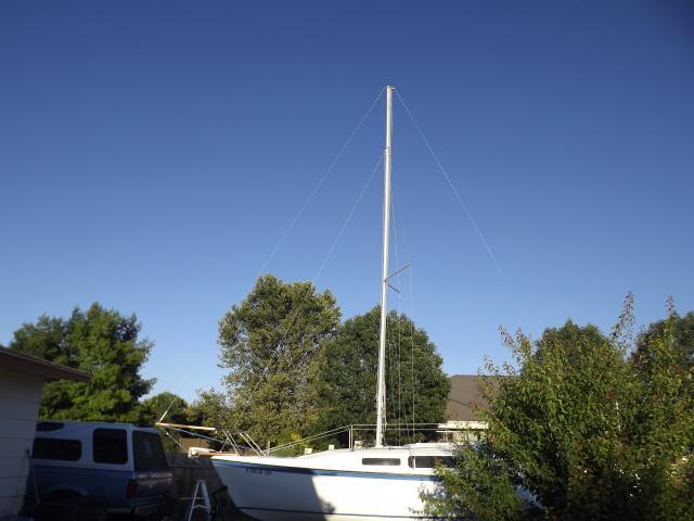

It is worth noting that the original standing rigging is all there in stainless steel wire, except for the backstay, which does not hold the mast up anyway.
I don't know if this pic will turn out, but here is the masthead and spreaders.
