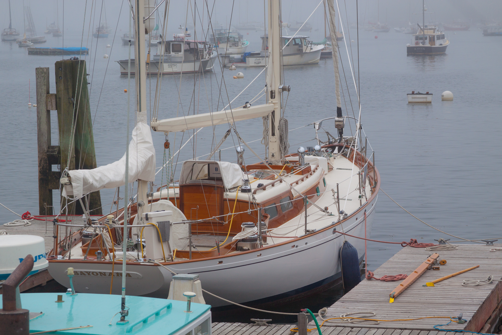

Here's an old ocean racer with the same locations and no guards.
After a hundred years of yacht design, the old stiffs in the Alden office probably knew ALL the wrong places to mount cowl vents on dorade boxes.
