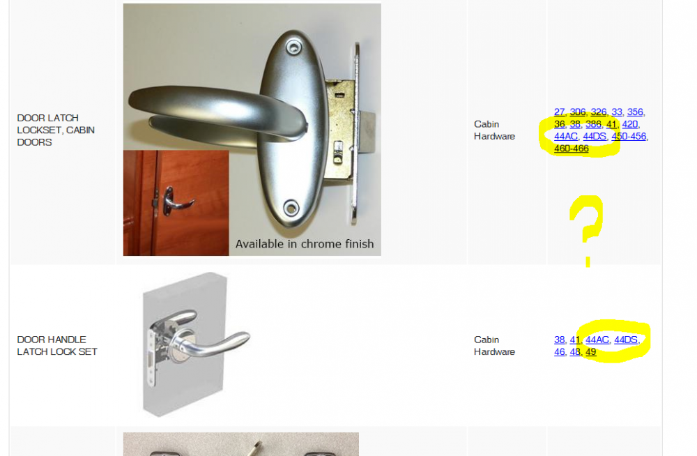

Thank you for the responses. I left the boat a few days a
go (without pictures) but here's a copy of the latch and handle set from the catalog. The door latch does lock from inside the aft cabin. To open, you press down on the handle then it springs back into the pictured position. That is no longer occurring. It droops and does not return to the position pictured. I'm rather familiar with the installation, replacement or repair of residential closet; exterior or interior doors but did not know if boat hardware is similarly designed. thought I'd post with the forum before disassembling the unit. I hope that clarifies the issue. A new set runs $170.00 + shipping. I'm hoping for a more reasonable repair option.

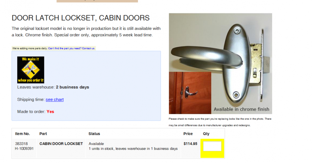

Big Red, It looks from the Hunter Marlow OEM site like there might be two different types: If you have the "top" one, there's only one left in stock (but it's listed at $114, I'm not sure if that taxes and shipping included).

Thanks for the research. We do not have the "top" one; we have the bottom one of the two pictures.
