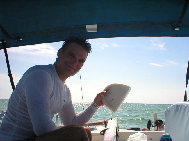

so there I was, sailing along... 10-15 knts.. glad I put the spare aboard... gotta say one thing... mac's tow like cr@p with no rudder.. http://i64.photobucket.com/albums/h169/ftldiver2/SailingOctHmstd/PA130013.jpg glad I had a spare: http://i64.photobucket.com/albums/h169/ftldiver2/SailingOctHmstd/PA130014.jpg

Mr Bill, Sorry to see that, have you been able to draw any conclusions about this failure?

MarkM has the best insight to possible problem/solution... it will be replaced free, and was about 1 yr old. I used it same was as always, and it sure seemed to be all the way down. (I looked for seaweed after about 20 min... when pulling the motor up, and it seemed down then...) I will be getting some more pins for sure... breakage aside, the high performance rudder is really great. when I sailed back with the stock rudder, it was sure hard to hold a course... Mark, what insights can you offer on pinning the rudder? ps: with no rudder in the water, the boat swings like crazy. the tow boat was only doing about 4 knots, and it was very uncomfortable. I was not sure if the tow eye would hold... (and I put the tow eye in) if the tow was longer we would have gotten out of the mac.

Does this seem to be an inherent problem with HDPE material being used for rudders? An IdaSailor rudder is at the top of my list of winter improvements. I'm not questioning the quality of Ida's products, I've got one of their tillers and I'm very impressed with their quality control. My concern is whether or not the HDPE material the rudders are being made from will weather well in the sun.

I'm pretty anal about keeping the rudder down, but I'm only using a low strech line with some blocks for advantage... In the wind and sea conditions, on saturday, I think I would have noticed if it has moved up a little... the boat was handling great. (the Ida rudder really changes the boat! for the better!!!) what I'm wondering is if pinning the rudder would stop the breaking? (survey says???) on the last (breakage) trailer sailor thread (chris ?) it looked like the S bracket was comming apart... I've got the D, so thats different, but it looks to be in about the same spot... (sheer) anyway, if you do have the high performance rudder, put the stock one back on the boat! (under the aft berth) if you had to get towed any distance it will be miserable... and in a heavy sea, could pull out the bow eye. (IMHO) installing the replacement was easy once in shallow and calmer waters... but offshore it could be tough. (maybe an extra pivit nut and bolt too!) ---Oh yeah, MarkM what can you tell me about that broken stock rudder? I'm thinking of adding some Fiberglass to the leading edge of the stock rudder....

Hey! I heard my name mentioned! Yes, we have the S model but the bracket was not the issue. There is a huge thread on the "other" Mac forum about the S bracket. Bottom line with that seems to be the pivot nut backing off. Some talk about it "shearing" but since the same size SS bolt holds the forestay to the mast, I can't see that happening. But, locknuts only work for so many "on - off" cycles before the insert gets chewed up. In our case, the pivot bolt was still in place and tight. One thing I remembered is a conversation with Joel at Ida Sailor. There are thin "cheek blocks" welded to each side of the rudder head. Early models had these welded all the way around. They stopped welding the bottoms because it was weakening the material - and some breakages did occur. The rudder I broke was this earlier model. Other than that, ensure it's fully down or it will be overstressed (any rudder). Slight rearward movement at speed is what people mis-diagnose as weather helm... In any event, I carry the original under the aft berth and don't lose any sleep about rudder breakage! I'd also buy an Ida Sailor rudder in a heartbeat. Their customer service is the best I've ever encountered. - and their product "performs as advertised". Mr Bill is not kidding about how the boat handles without a rudder. We had to motor back 5 NM when ours broke (didn't have the original on board then - DUH!). Our motor can pivot in the well and it was a continual "back and forth" effort to make progress. Talk about blisters! Centerboard up/down didn't help either... Chris
