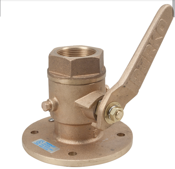

I've a Perko sea cock that's got a slight leak from the handle when open.
20210528_134533.png What I'd like to do is remove the handle to check the o rings. Sea cock closed, of course.
Anybody know if seawater will start gushing in if I pull the handle and nut underneath it?

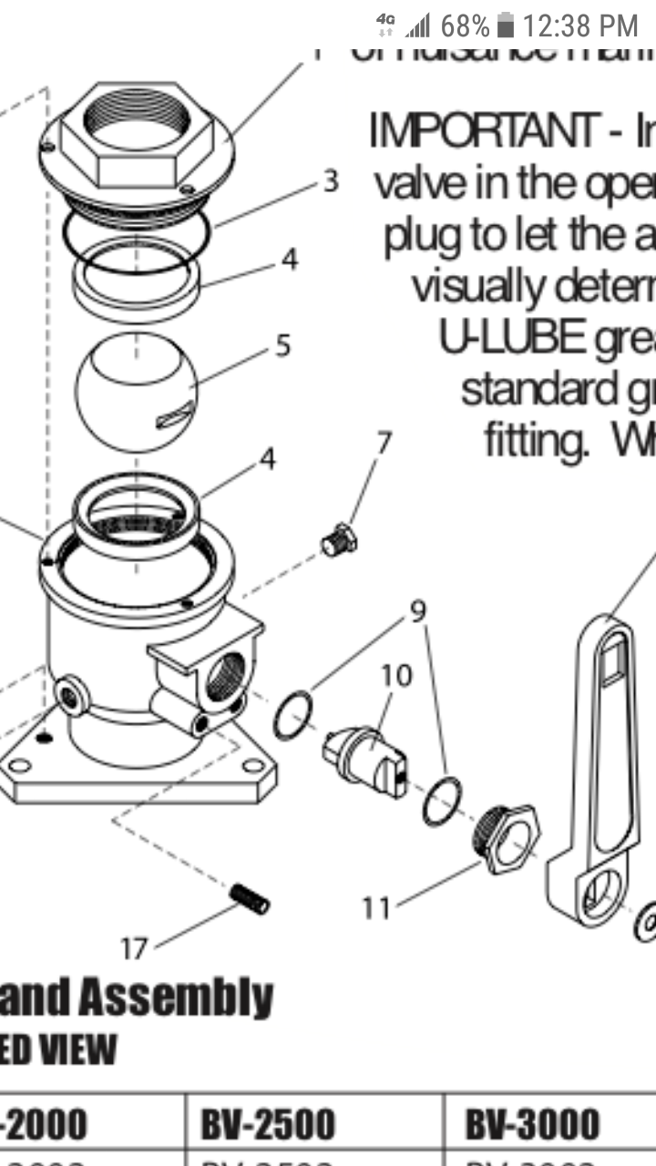

This might help you see the parts that are leaking.
No. Been to their website and they offer a rebuild kit, but very little on specifics wrt my issue.
My guess Part #9.
Not a problem. The handle only turns the ball. The ball is what blocks the flow.
True and maybe not the issue.
But the source of the water has to come by that ball seat.
Not a "sink the boat" type flooding.
Jim...
PS: Note the phone number for Service Calls at bottom of Picture.

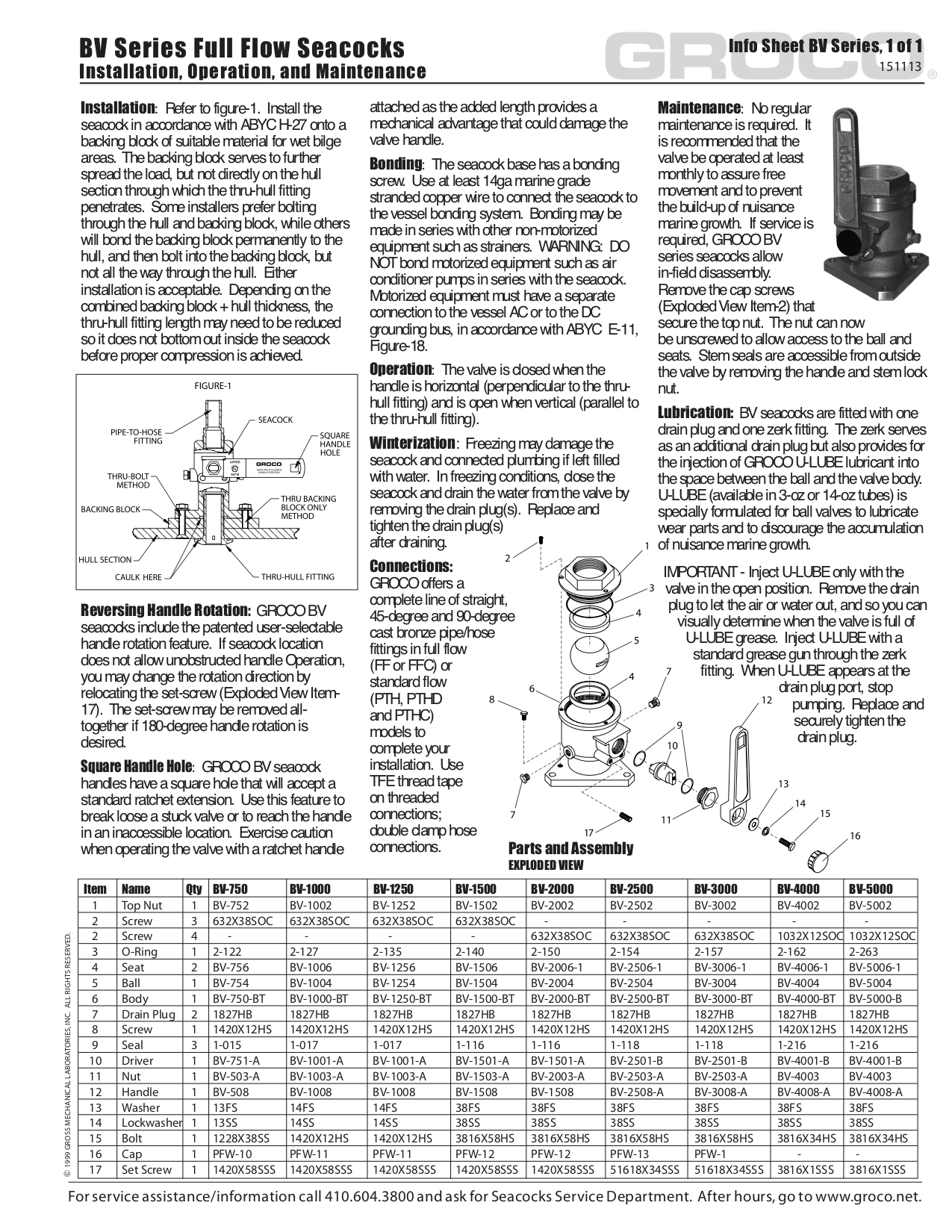

Very helpful! My google-fu is weak. Muchos gracias!
Por Nada.:biggrin:
Not from current web searching.:badbad:
I got most all Sea Cock's information, Drawings, Repair Kits and this specific Groco info, when I was deciding the best design and service a few years ago.
I am replacing all of my seacocks soon, and will share in SBO the final decision and reasons for my Engineering/Boater pick.
Yes I am looking at Marelon
But I am not liking the lubrication maintenance required.
Jim...

Well, thanks all. Success was had in stanching the drips. Seems that part number 11, a sort of packing nut, was rotating along with the handle.
It would slowly unscrew as the handle rotated.
It's been sparingly greased and tightened to where the dripping has quit and will keep an eye on the rotation.

Think they'd care if it's a Perko?
I saw Perko, but got side tracked [ no coffee] to Groco :facepalm:
But as you noted Part #11, most of these types of SeaCocks are built the same.
Read the Groco Maintenance section for why lubrication needed.
