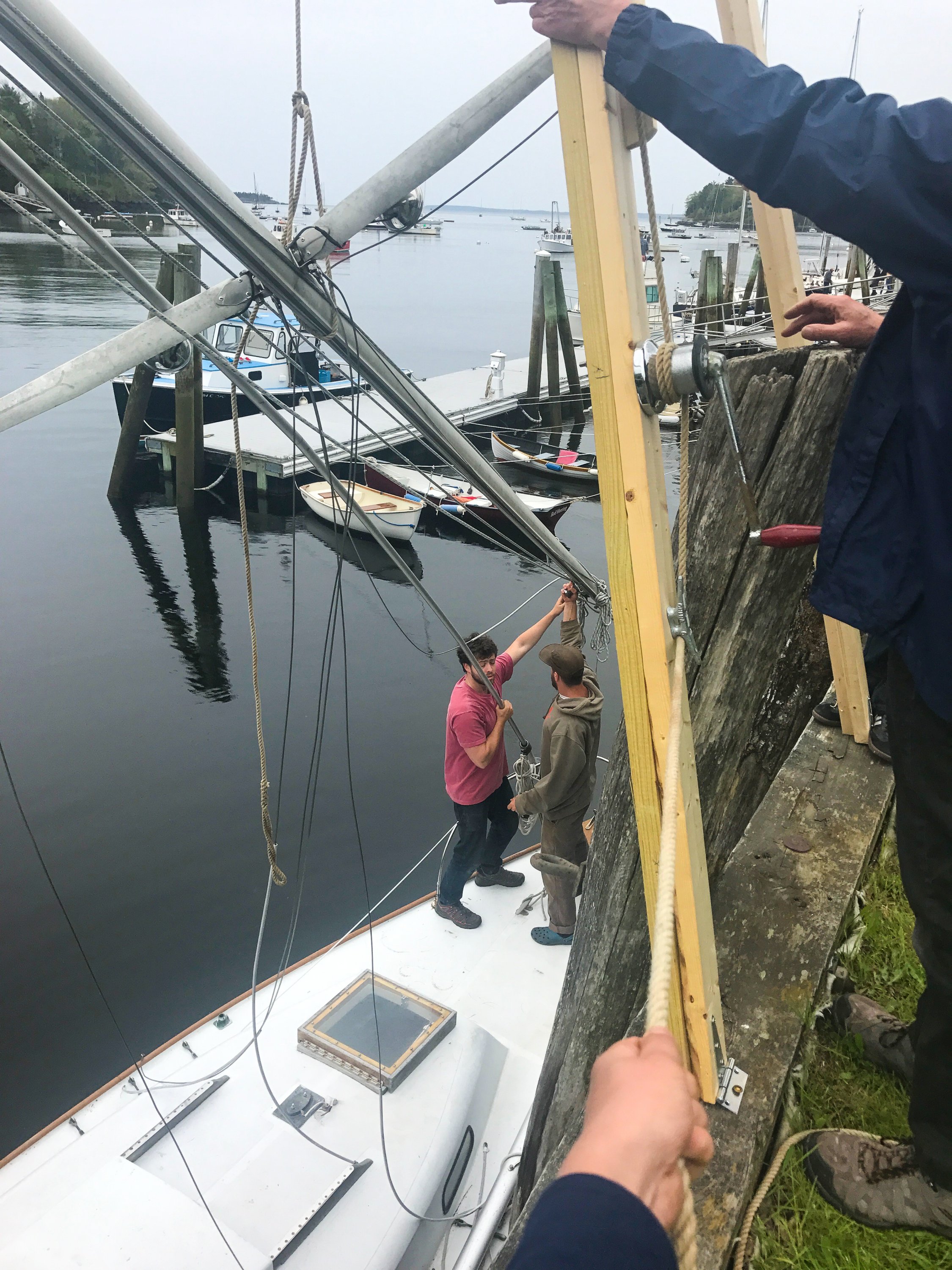

Last week we launched our sons $1 dollar boat. We built a wooden A frame to step the mast which stores on saw horses, on deck. We've used 'Sky hook Jr." several times, with no problems. The boys, on deck, stay out of the way incase the spar drops (we assume that could happen).
This time,...I was in a hurry rigging the A frame, and swapped the two lines we had. One the 'guy' and two, the hoist. Shouldn't be a problem except, the hoist is nylon.
With plenty of help above and below, I noticed the stretch seemed excessive but we carried on. The spar lifted off the deck and the boys below, were trying to steer it around, but it wasn't getting much higher.
At one point I thought the bumper was coming off my truck. The A lowered, and lowered. Finally, the leg attachments at the wharf, pulled out and the spar ended up going away from the boat,...and into the harbor. "Splash".
Embarrassed but no one hurt, despite being a little gun shy of our rig, I ran to my boat for a length of dacron,... We re-rigged, and up she went, without a hitch. I thought it was best to do this immediately. Sort of like getting back on the horse after he throws you.

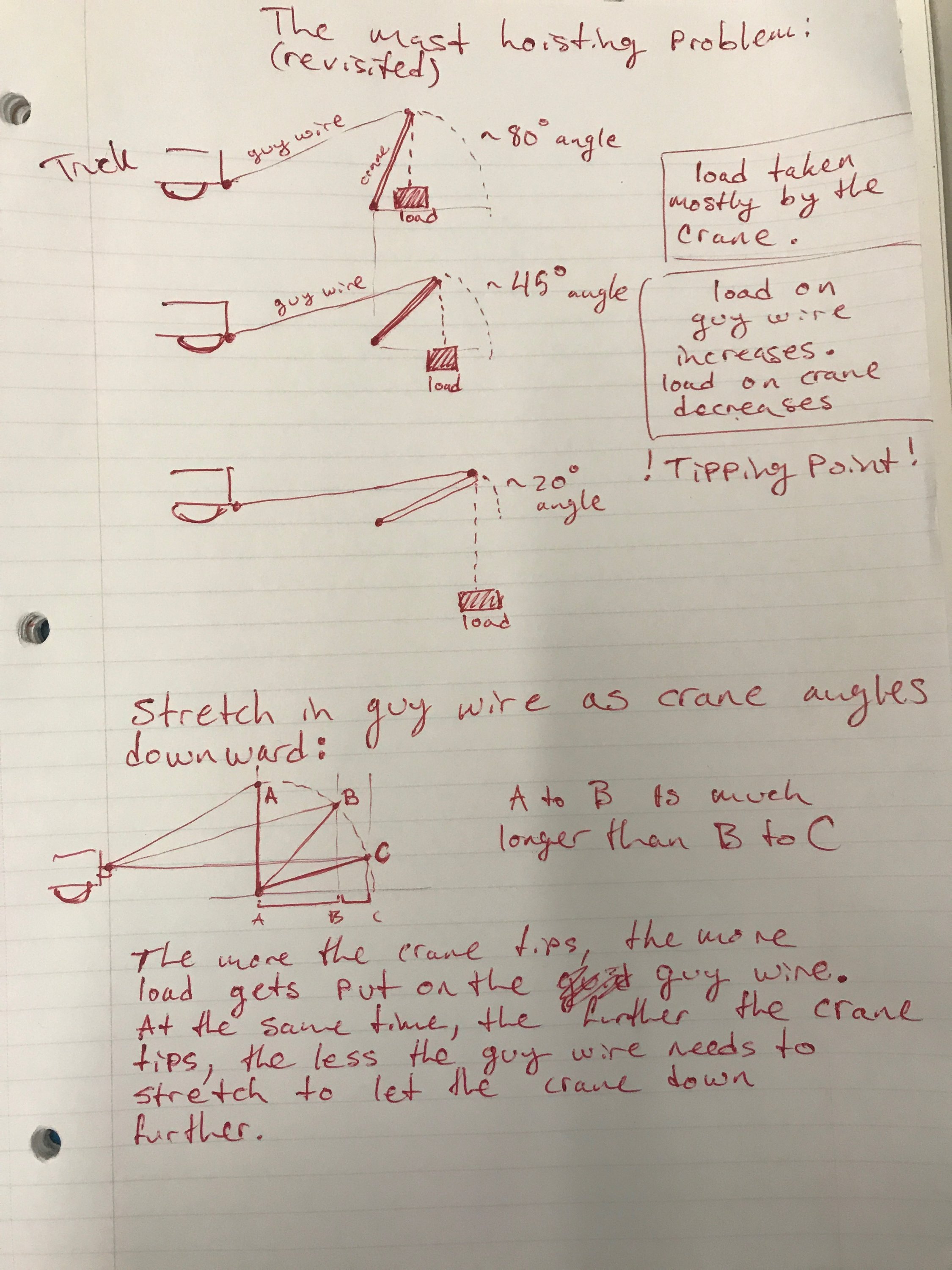

My son, who is newly hired a financial analyst in Boston, did a little analytical work on Sky Hook Jr. He sent me this little sketch. Yep, that's exactly what happened.
The guy is now a piece of easily recognized yacht braid, the hoist 3 strand dacron.
Plus I think in his analysis he's found: It's best not to trust Dad, unconditionally,... :)
