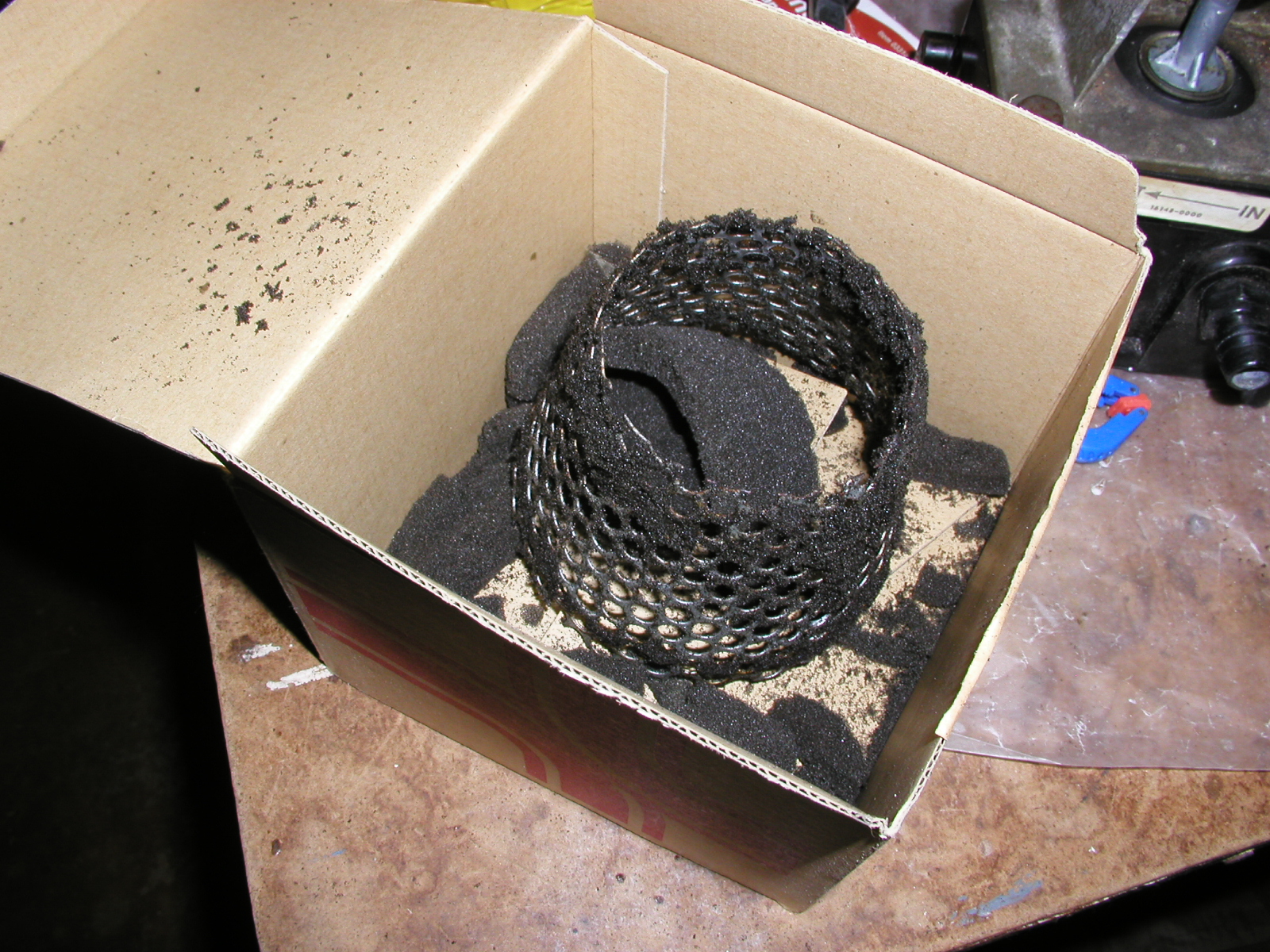

I used to be religious about changing the foam rubber filter element in my Universal M12, first yearly then every 2-3 years and I would see it did not have much wear and I did not use the engine so much so I figured "what the heck, why bother" until I was reminded by some owner who brought the subject up on this forum. Good thing I took a look as mine was 1/3 disintegrated, gummed up on the steel mesh frame and of course some had to have gone into the engine. Gotta love Diesels, they take a lot of crap. Anyway, I say this as a reminder to those who might be as cavalier as I was that you need to pull it apart every once in a while and replace it or more appropriately in line with how many hours you put on the engine, maybe more often.

10,098
The Yanmar is known for disintegrating.. I replaced the foam with a nice open cell that does not disintegrate..

Oct 29, 2005
2,362
After having several Yanmar foam filter disintegrated and suck into engine, I gave up replacing the filter and run engine with just the metal cone (silencer?) For couple of years now. Couldn't figure out where dust gonna come from in boat and at sea.
And same thing happens to my genset foam filter. No point replacing the foam, just use the paper type.

There are two types of foam apparently. One is alcohol resistant, one is petroleum distillate resistant. Wonder if the Universal Marine folks picked the wrong one. Anyway, I ordered three from Toad's and they did not have that many in stock, so guess it is not a big mover. That says it all about how often we are changing these out I guess................
