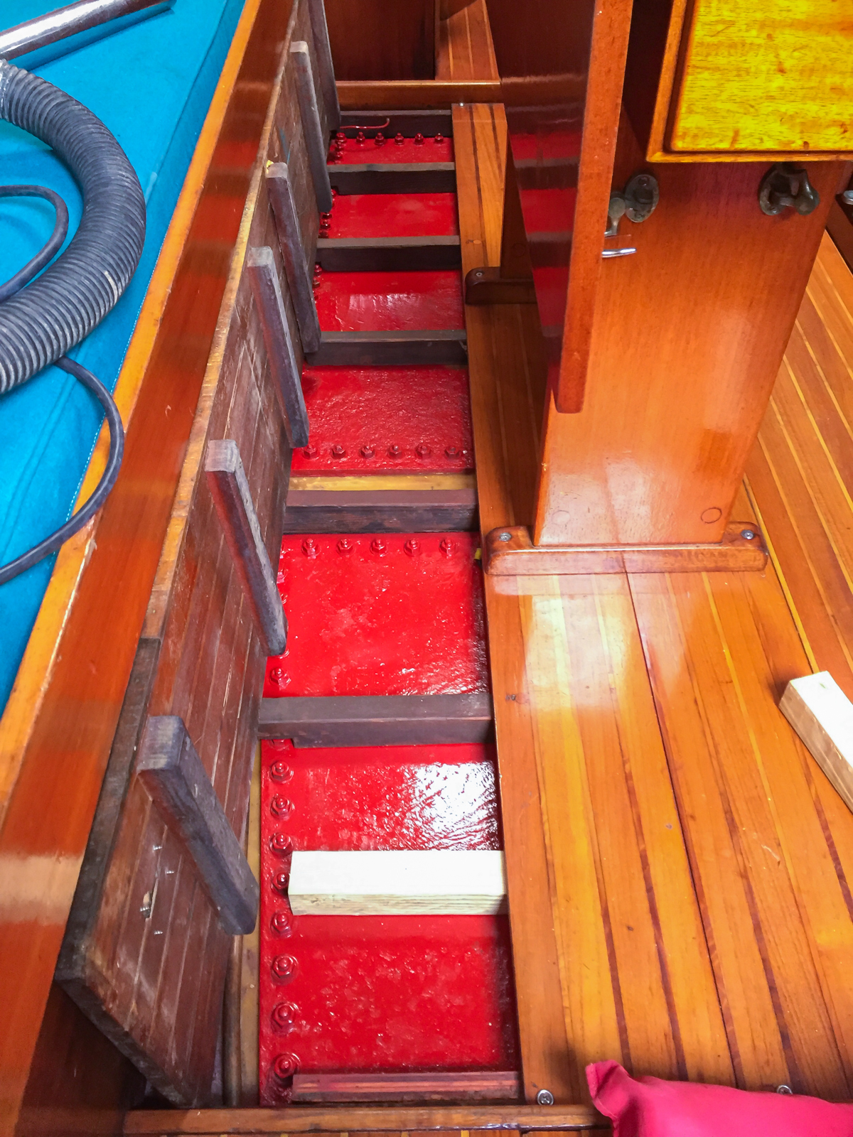

You're right about low. My old boat has 80 gallons of fuel tankage below the cabin sole. The tanks are integral to the glass hull but above the lead keel which is bolted on to the hull. These tanks were designed for the prominent gasoline engines of the day (50-60's) that required big fuel tanks.
Integral fiberglass pipes at the bottom lead any bilge water from forward to beneath the tanks and into the deep sump so these spaces would stay dry. You could place batteries here that would be below the sole yet easy enough to maintain beneath the lifting cabin sole.
The trick would be what batteries would fit the space?
I'll mention this to the next owner. :)

You could build a LiFePo4 bank in there with prisimatic cells.
