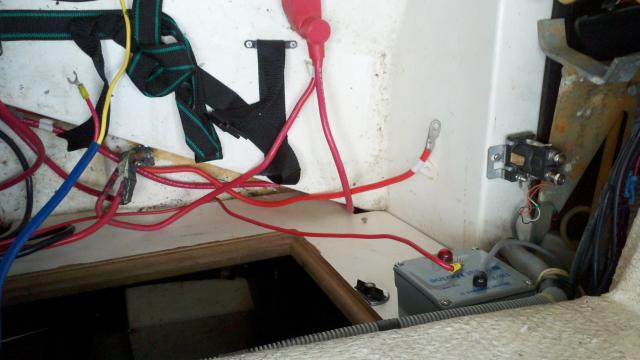

Don, do you have a wiring diagram for your combiner? I have always wondered if mine is wired correctly. I did find this PDF manual and printed it but the one schematic is pretty useless(http://www.yandina.com/acrobats/C70Manual.pdf). You can see mine in the picture.
The small red wire from the control box was attached to a house battery ground because it was the closest ground. The starboard most(top) post of the combiner(by the anchor) was connected to a positive terminal of a house battery. And, naturally, the other post was connected to the positive terminal of the start battery. This seems correct but I am unsure.
What is confusing me is that the house is dead and the start battery is fine. The Heart Inverter/Charger was connected to the same house post as the combiner.
23,526
Ed, that sounds right. Look at the link I posted on your ACR topic, it includes wiring diagrams. You mentioned that your original setup had the AO going to the C post of the switch. If you were running the alternator with the switch in the Both position, the combiner could, maybe, possibly, have been chattering because the AO was going to both banks through the switch as well as the combiner trying to "do its thing."
That's why we keep repeating the mantra: take the AO DIRECTLY to the house bank. Use an echo charger, ACR, combiner, or even the B on the switch (as backup!:)) to parallel the banks only when charging.
You can check if the combiner is working by turning on your shorepower and seeing if it engages and sends charge to the other "leg."
23,526
Ed, that's the same combiner I have, we have the 130A model. In the manual, near the end, is a hidden little gem: you can put a toggle switch in the negative wire to turn it off.

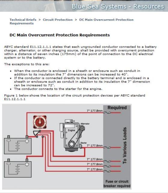

What jumps out at me in a quick look is that the fuse for the house bank should be in the positive cable and not the negative.

this is what blueseas has to say about where to put the fuse....

Add In-line Fuse to ACR Battery Negative Connection
Automatic Charging Relays (ACRs) are connected to engine and house battery banks through large conductors. In the unlikely event that there is a fault in the ACR internal circuitry that allows fault current to flow from the high powered positive leads to the negative reference wire, the negative reference wire may have to carry more current than it is capable of and can overheat. The wire is typically rated for 20A; the normal current in this wire is less than 1 ampere.
A 10-15A fuse in the negative wire can prevent excessive current from flowing in the wire leading to overheating or possible fire. In-line AGC or Blade fuses are suitable. Place the fuse in a location not subject to flammable gas and use a sealed fuseholder.
All ACRs are vulnerable to ground faults flowing through the negative connection. This includes ACRs from other manufacturers. Refer to the wiring diagram for the location of the negative wire and install an in-line fuse in it.
Follow these specific instructions for each Blue Sea Systems’ ACR:
7600
Connect Terminal 3 of the ACR through a 10-15A in-line fuse to the main negative bus or the negative terminal of the nearest battery.
9112
Connect the negative (black wire) from the ACR through a 10-15A in-line fuse to the main negative bus or negative terminal of the nearest battery.
7610/7650
Connect the quick connect terminal marked GND (ground) through a 10-15A in-line fuse to the main negative bus or negative terminal of the nearest battery.

That calls for a fuse in the negative reference wire of 10 to 15 amps. ABYC calls for positive main cables to be fused within 7" of the battery post. Fuses in negative main cables are not required. You do have a breaker but I am guessing it is not within the required 7".
The charger positive output should be fused as well.
This is from Blue Seas (and ABYC) as well.
Woody,
That negative ACR fuse is "in addition to" the fuses that are required for an ACR within 7" of each bank to meet US standards. In the US and Canada, they too follow NMMA & ABYC guidelines, all fusing is in the positive DC lead not the negative unless you also have the pos lead fused also. Donalex is in the UK where they may use a different standard.
This is straight from Blue Seas instruction sheet for the ACR:
* It is recommended that the ACR be connected directly to your battery positive terminals through appropriately sized fuses. Connecting in a different location such as a battery switch may affect accuracy because of voltage drop along current carrying conductors.
Excellent schematic.
It really is much simpler than all this.
In common with all boats of that era, my H376 came with no fusing on the DC power cables whatsoever.
When I installed the Heart Interface combo inverter/charger, I thought it wise to include a 150 amp fuse.
It is a great brute with no insulation at all and was obviously intended to mount inside a mains power distribution cabinet. Again, in those days covers were not available.
There was no space for the fuse in the battery locker so it had to go in an adjacent locker, though still within a few inches of the battery bank.
It was anathema to have exposed +12V terminals in a locker filled with all manner of other junk so I installed it in the negative power return line next to the 500 amp shunt.
I made a rudimentary cover for the fuse and now my risk assessment relies on there not being TWO simultaneous faults. i.e. a main power blow out AND something breaching my cover AND shorting across the fuse terminals.
