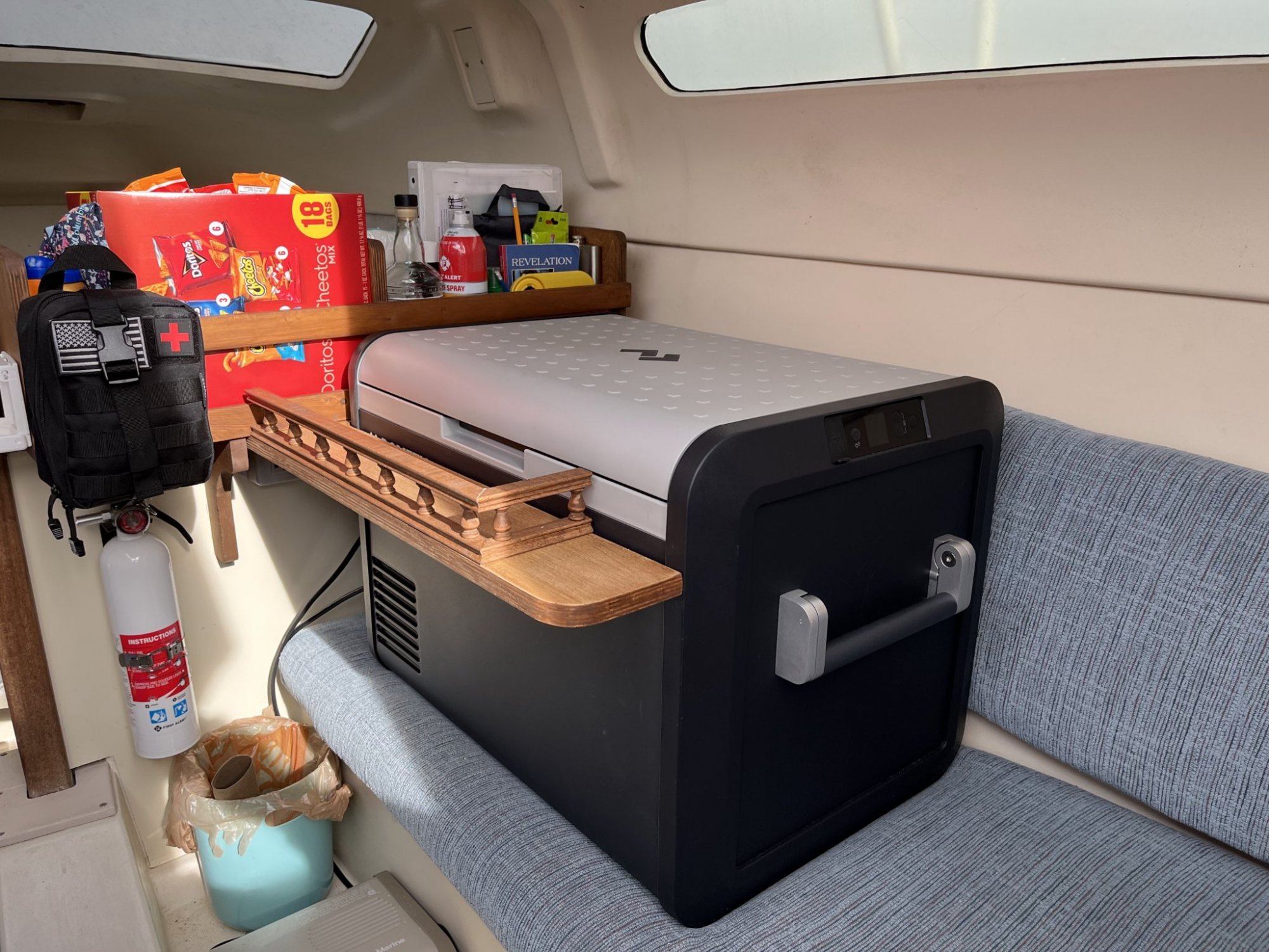

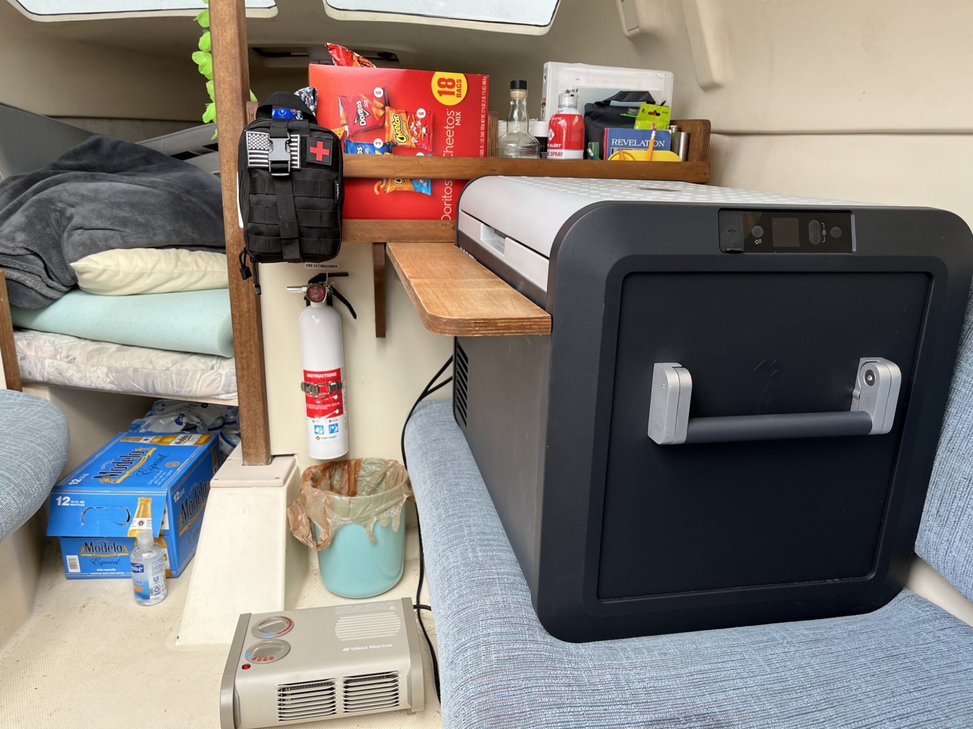

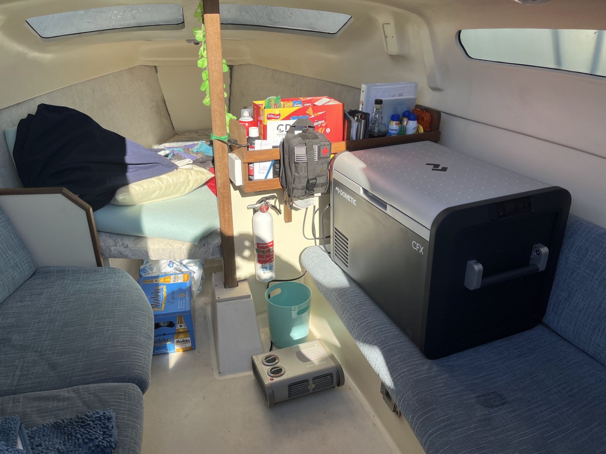

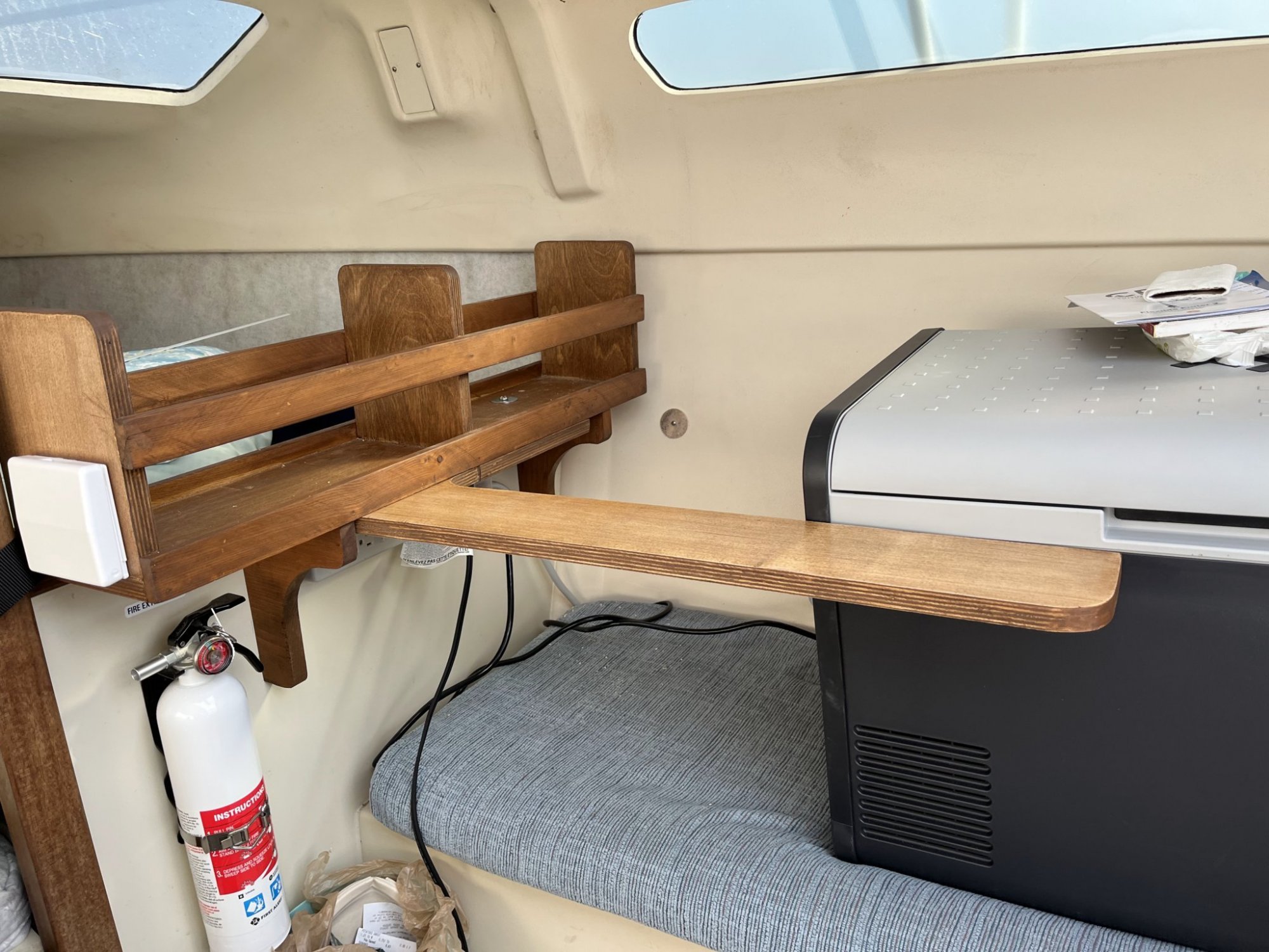

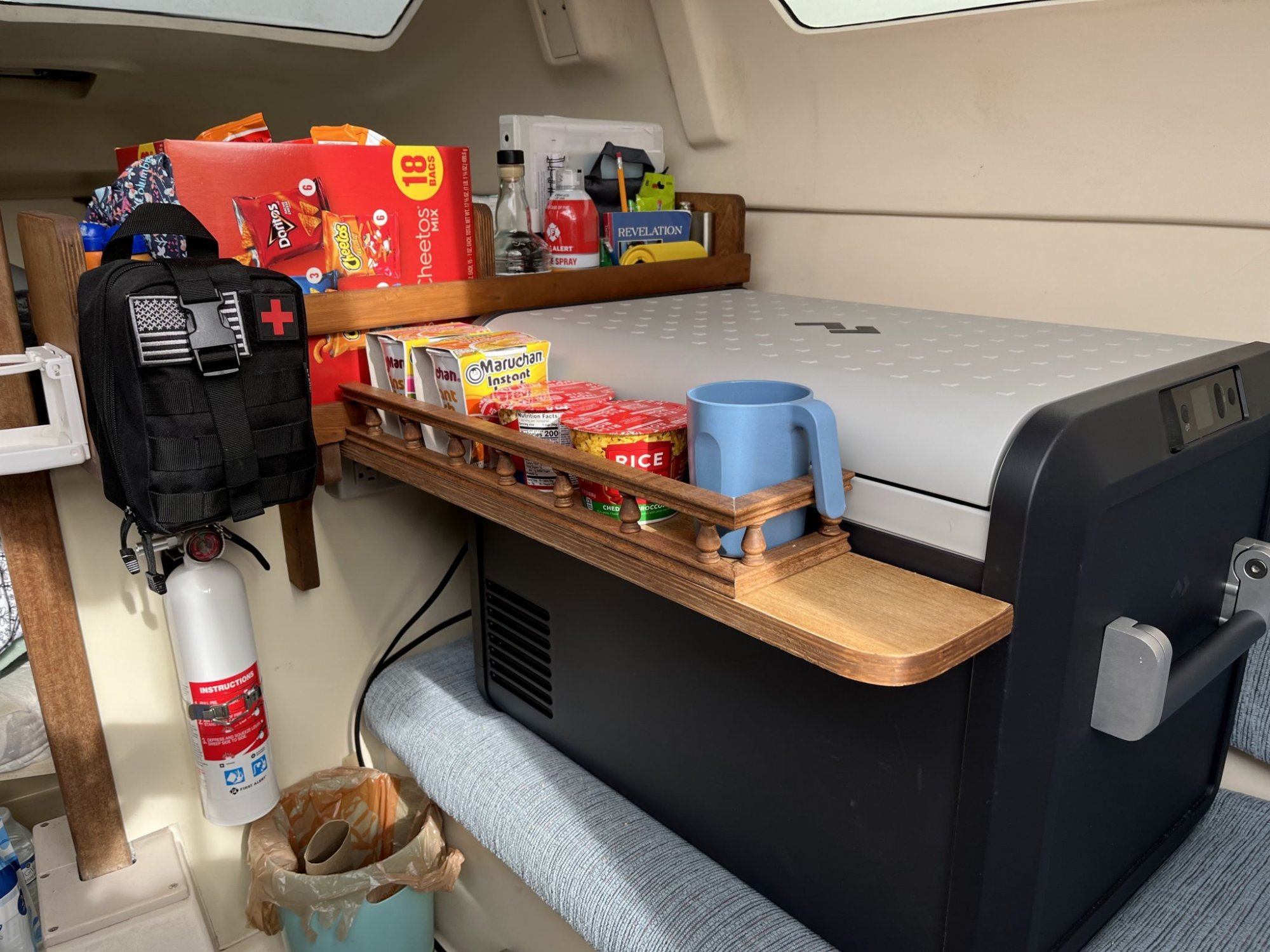

The new refrigerator is almost perfect. It was a little too tall to keep under the cockpit on my H240. Jessie and I decided to put it in the main cabin on the starboard seat, effectively turning the cabin into a galley. It fit and did not move around at anchor but I was not going to sail with it there. I moved the backrest cushion aft to provide compressor air flow. Having earlier added a shelf on top of the privacy bulkhead I fabricated an "L" shaped bracket to hold the refrigerator on the seat. The cushion is velcroed to the seat and the only movement issue is the refrigerator rolling over on to the deck. The forward carrying handle is under the edge of the shelf and will be lashed there. The bracket is removable by taking out two bolts. I have stained galley rail and will add to the edge of the brace effectively turning it into a shelf.
