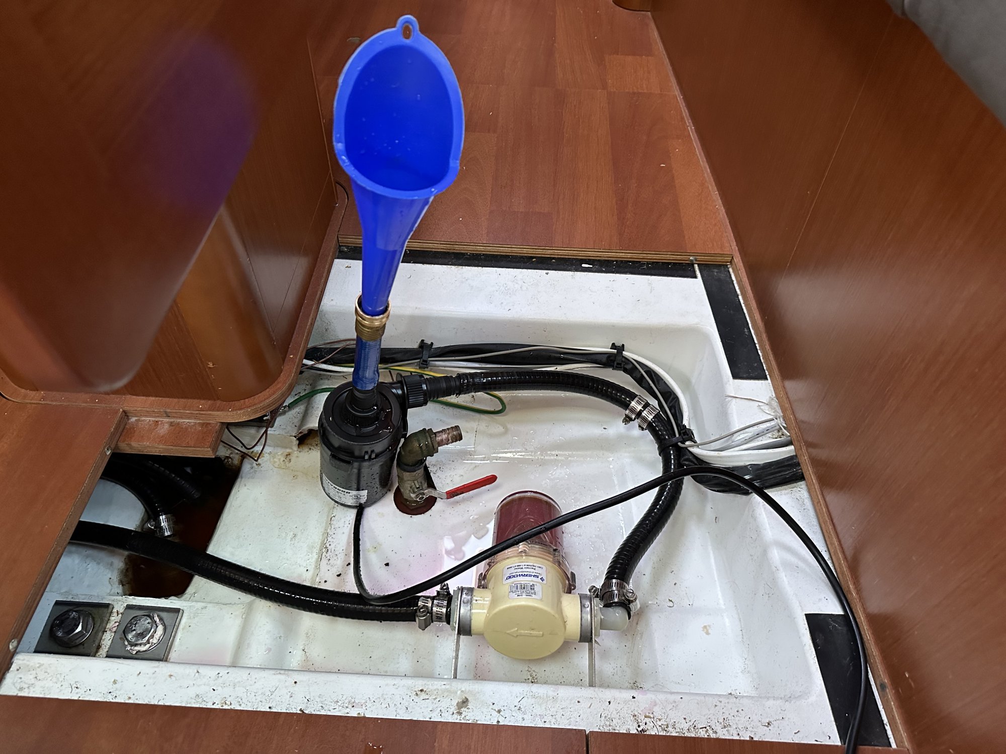

It’s a 2005 16,000 BTU unit. I can’t get antifreeze from the input to the output through the unit. Have disconnected both hoses right at the unit but can’t get flow either direction. Any ideas? Does anybody have a technical support number for Dometic. Their website seems to direct me to a vendor. Thanks.

Air conditioning pumps are not self priming, and getting them to pull antifreeze can be tricky. When the boat is in the water the pump is usually below the waterline, so water naturally flows into it. Even then it’s often necessary to open a bleed valve to let the air out of the pump so water can start flowing. When out of the water it’s even harder to get antifreeze through to prime the pump.
If you have two people you can try having one pour antifreeze into a long neck funnel and into the intake hose, while the other person turns on the AC and opens the bleed valve long enough to bleed the pump, and then close it while AF gets circulated.
I usually winterize by myself, so I use an aquarium pump to help push the AF through. I put the pump output onto the AC input, and pour AF down a funnel while the pump and AC run. With that the aquarium pump generates just enough pressure to keep the AF flowing.

Thanks, but I’ve tried pumping from the unit itself both ways from the input and outflow connections. Antifreeze won’t go thru the unit.

I believe that you have a air-lock in the pump. The solution is to attach a hose to the intake and raise it several feet higher than the pump. Use a funnel and pour AF into it as previously suggested. Alternatively, you could attach a hose to the input of the strainer and use a drill-powered pump to push AF into the system.
If everything was working prior to haul-out, I think it is unlikely that you have a blockage.
For future winterizing, get a 5 gallon bucket and install a hose barb near the bottom. Then run a hose from that barb to the strainer input. With the bucket several feet higher than the strainer and pump, fill the bucket with AF.

Thanks but I’ve tried pumping using another pump directly at the input and outflow on the unit itself both ways. So something within the unit is preventing flow.

Was the pump you used a positive displacement type or a centrifugal type? The centrifugal type will not build pressure, just like the A/C pump.
If you have a bicycle pump with a gauge, try attaching that to see if you can build pressure. If pressure won't build, then you do not have a plug. Or at least not a total plug.

Thanks for all of your support. I tried Kloudie1’s suggestion and was able to dislodge whatever was in the way using a length of 10 ga wire. I was then able to blow the remaining water out and ran some antifreeze through the unit. Problem solved. Cheers to those who took the time to help.
