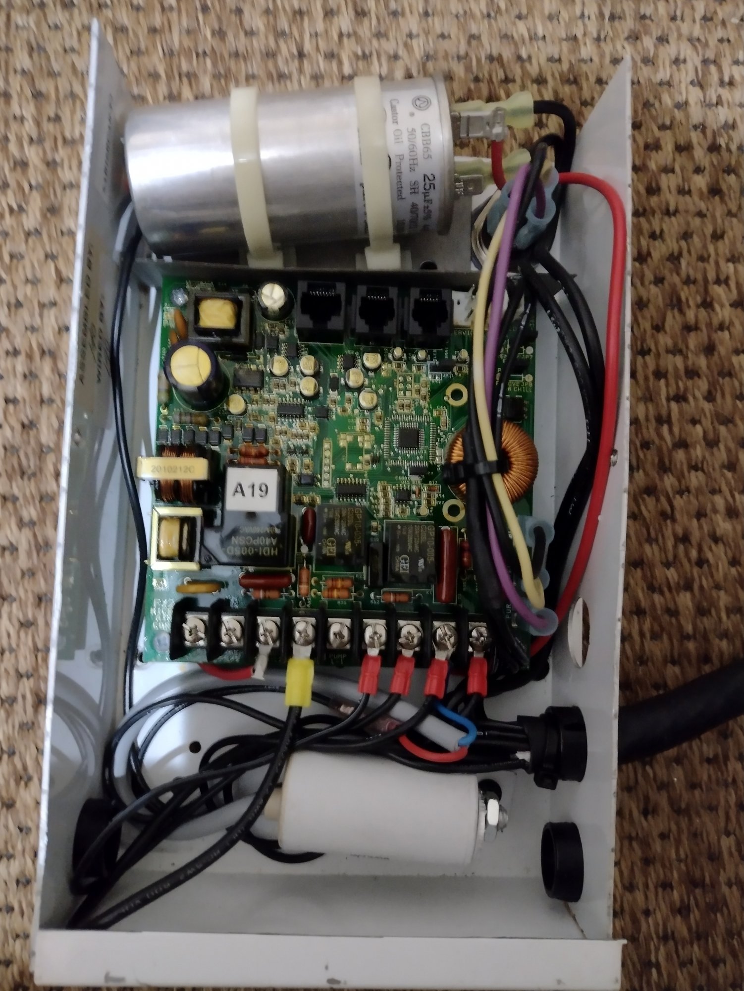

Have you removed the board from its mount and had a look at the back side? Often when components go bad you will be able to see evidence of their failure on the back of the circuit board. - burn marks, cracked, melted or failed solder, missing component pins etc.
All of that being said if it is a single relay that has failed they can usually be fairly easily replaced.

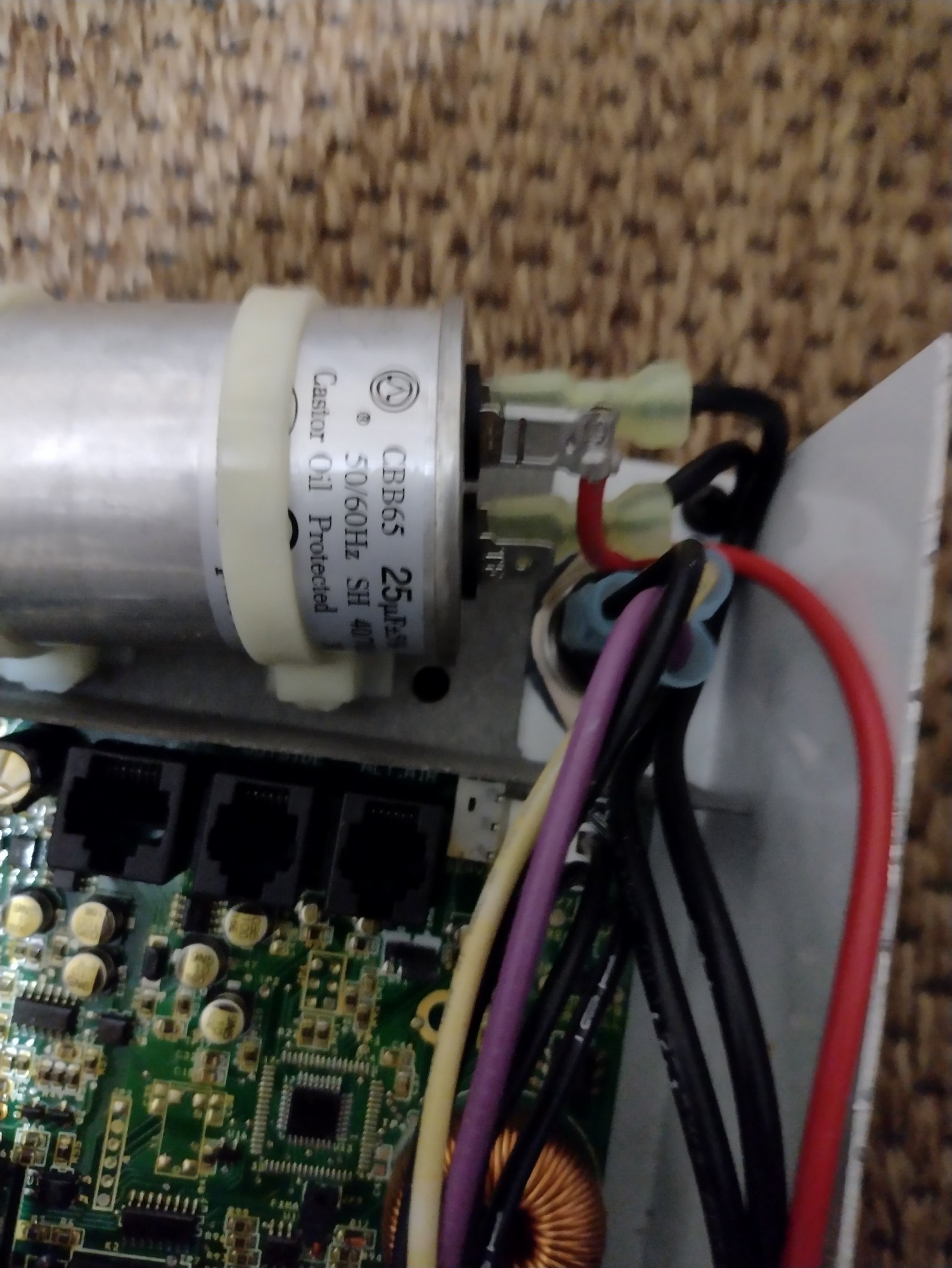

  • I first suspected the run capacitor since these fail frequently on the home AC unit.
  • I check the capacitor with a meter and it was within specs.

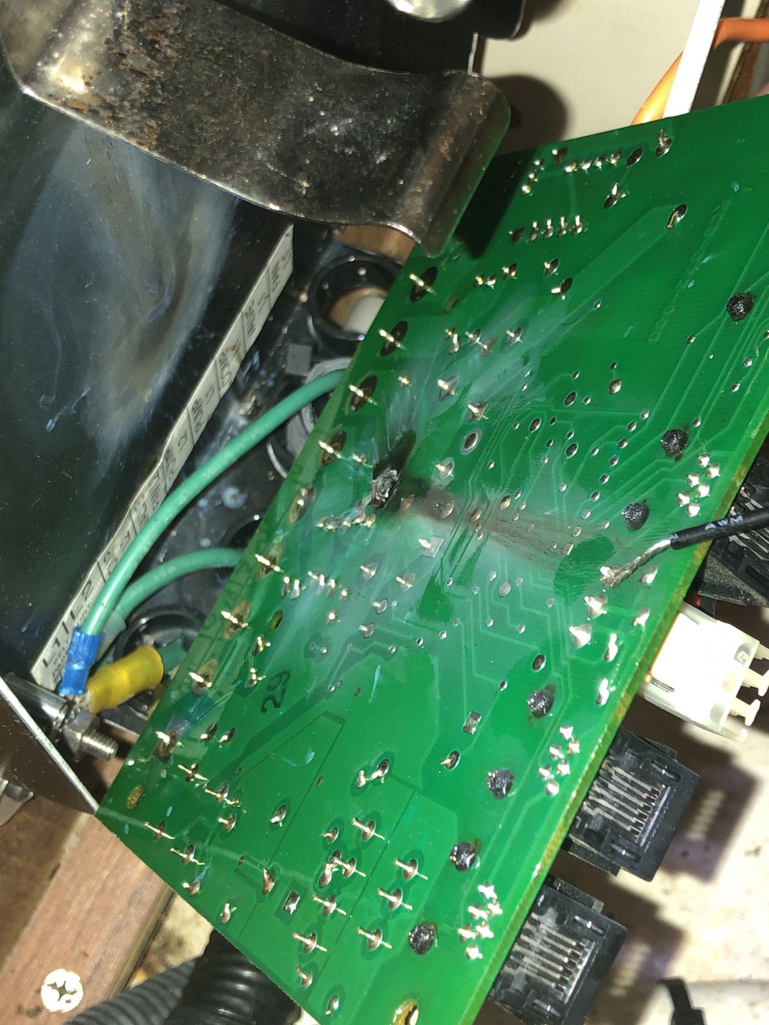

  • I inspected the back of the board and found the relay which had lost it's magic smoke that makes it work. (see pic below)
  • I search for a direct replacement using the P/N on the relay (HD1-005D-A40PCSN) and found none. No datasheet found either.

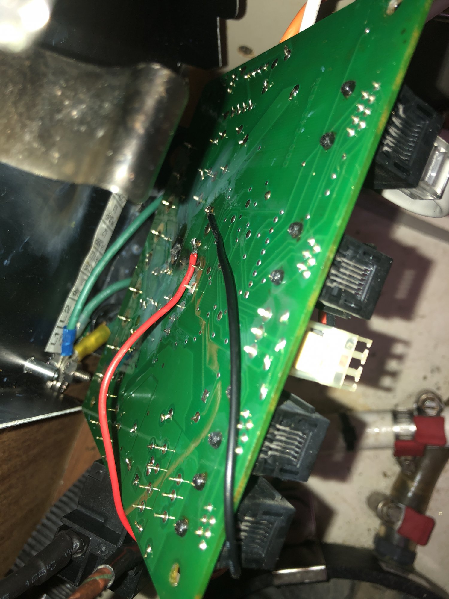

  • Used meter to find the 5v DC control pins on the control board. Verified it was compressor by sequence of startup Fan->cooling water pump->compressor
  • Soldered jumpers to control voltage pins and the relay control. Polarity didn't matter for the relay.
  • Made jumper wires for 120v side with male and female spade connectors on opposite ends.
  • Female spade connected to the relay. One male u-spade connector connected to input L1 the other connected to Comp L1.
