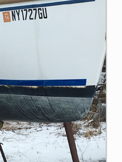

do you think the bow on your Capri rides high? Is the boot stripe factory painted? What does your trim do while under way? What is your helm like? Are you fighting lee helm? I wouldn't change anything unless it feels like it needs to be changed.

I moved some of the heavier stuff (2 anchors and rope and chain) to the forward lockers to counteract all the weight at the back with the outboard and me and crew.

Thanks, I will see what I can move/store forward to balance the boat better

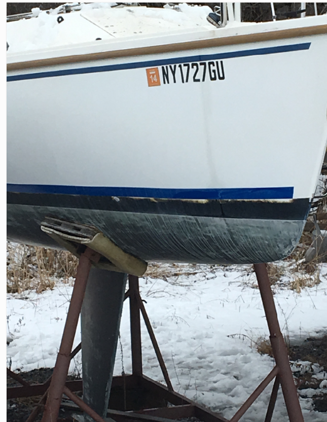

If you look at the boat it is designed the rocker in the hull at to just forward of the keel. This is by choice by Catalina. I used to sail with the in house designer/Naval Arch. engineer in Calif. One of the biggest problems with Catalina yachts
is the boat very full forward close to the waterline in front of the mast. This is why the boat struggles in choppy water. But it helps when reaching and running conditions as it helps keep the rudder in the water and improved righting moment.
This can best be seen when comparing a Capri 22 to J 22 there is approx. 14-16'' difference at the same stations about 4'0'' aft of the bow. See below
