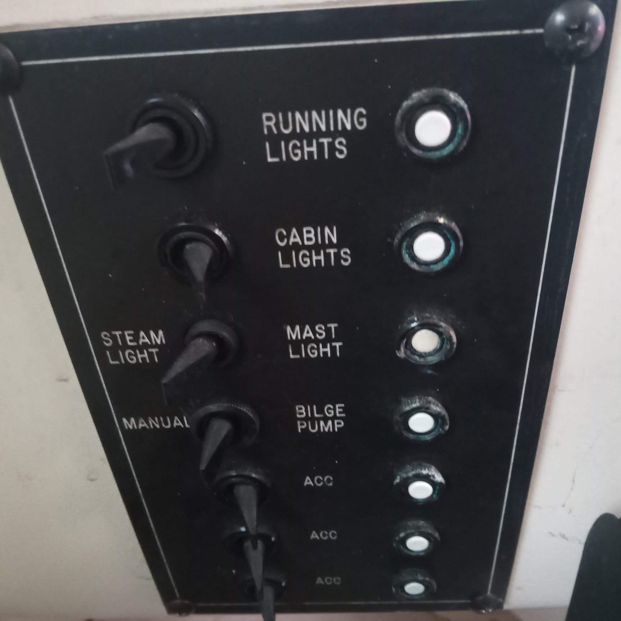

Now am trying to get anchor light and front running lights to work. They're not working..
The electrical panel has on 1 switch the option to flip one way for anchor light and other way for steam light. But does h260 have steam light like maybe at top of mast separate from anchor light? Or does setting to steam just turn off the anchor light since when moving/steaming the anchor light should be off?
Sigh. Power ain't getting to anchor light and front nav lights. I sorta think the wires in switch panel are bad. I will rig up the anchor and nav on panel on diff switches as first try at fix. Man the wiring is confusing back there.
What does ACC on switches mean?

I don’t know about the steaming light, but the ACC switches are probably “Accessory” - switches for various items like instruments that weren’t installed at the factory but may have been added over time (or may still be unused).
Jun 2, 2004
3,676
Quick answer is yes.
The light on the top of the mast has two bulbs. With the switch in the "Mast Light " position both are on to give you a 360 degree white light. With the switch in the "Steam Light" position just one is luminated showing a 225 degree light.
First place to check to see what is wrong if they do not work is the three pin deck connector. It is notorious for getting corroded and keeping the light from working.
Lots of stuff in the archives on addressing this issue which is common to the 23.5, 26, 240 and 260.

Both @Davidasailor26 and @Rick Webb are correct. First, use a tester too to see if you are getting power to the lights. If so, look at the light bulbs to replace.
Your switch for the combo steaming and anchor light is a on-off-on three way position switch.
The deck plug is either a three or four prong fitting. The big pin is generally your Dcc ground. Did you ever read on line the manual for the 260?

Thanks. Sorry if seem amateur. The bulb top of mast lights up if at base of mast give power, that's good.
Not all of us are good at wiring diagrams. And by definition if switch does nothing then something has broke or loosened, so gotta track down broken bit not just understand.
An anchor light is really my main goal, I've given up risky night boating so who needs running lightsg. In reality if can't fix I can hang light somewhere medium high, the regs are from 70s and days when some literally hung a lantern halfway up foresail. In small bay top of mast is hard to crane neck up to see, and not think light is a star so medium height better, people boating look near water not up where planes are haha.
UPDATE: Pried front bow light off, broken wire. SO THATS FIXABLE. Tested mast lights using a lil 12v fan to show power, and power is coming from inside to top, wow good, but the 3 pin wasn't working to send power onwards till brushed and really screwed it's connection tight now get power. Yeah!!! Thank God it's simple I admit I'm dumb and bozo. ....
If curious when switch set one way seems 2 wires send power up the mast to power both lights up there, I guess this is "anchor" mode, 1 powered line is "steam" mode to power I guess a 270 degree light up there. Sigh. Any light up there is good nuff for anchoring, I have solar white lights around deck to see where I step that really is main way people spot boat at night. Thanks.

The light bulb three pin plug, check the inside of the plug for corrosion and clean it depending on what you see. If not, then You will have to drop the mast to remove the light bulb. There is write up how to lower and raise the mast of the 260 you will find in the downloads under boat information for the hunter 260.
As for the switch you will need a Phillips screwdriver to remove the four corner screws and see how many wire are attached and the color of those wires

Got mast light sorta working. But it throws light mostly backward, maybe the 270 degree arc of light is facing back and the 90 degree bulb is burnt out. ?????? Did Hunter put the 270 bulb aftward. When under way steaming this way doesn't throw white light forward to compete with the red green lights.... What kind of bulbs are up there????
Boy the 3 prong connector is finicky. I don't trust it. I plan on hanging solar lantern halfway up jib. I also don't like draining 12 volt battery so lots of mastlight use when at anchor seems bad.
The mast/steam light has a resister at the panel which I ll not even try to grasp. Ain't it nice 12v ain't enough to zap, makes tinkering low stress. I guess 24v will zap ya. Thanks.

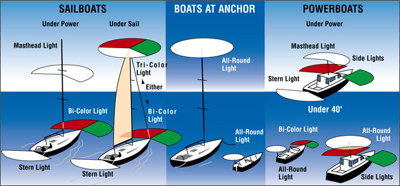

It sounds like there’s all kinds of wonkiness going on. A steaming light should shine forward through a 225 degree arc. The stern light should be visible through a 135 degree arc. Maybe your masthead light got mounted backwards or spun around over the years? I see no reason for a resistor at the panel in the circuit for the lights. If it’s actually in that circuit all it’ll do is reduce the brightness of the lamp and convert some energy to heat. Neither of those are great outcomes. 12V, 24V, and even up to 48V are considered safe, and a resistor is not considered a way to make an unsafe voltage safe anyway.
24,949
In those “20 years self taught mostly motoring the Mississippi and Tenn-Tom canal”, the rules for lighting on a boat have not changed.
Being “self-taught” and motoring if you used the waters not following the regulations you either would be caught and instructed or now that you are sailing learning the rules for the first time.
Pictures are easy to decode.
If the white light shines forward it is steaming. If the white light shines aft it is stern navigation. If white light shines all around the boat it means anchored boat.

The "resistor" on the back of the switch I believe is a diode so that you can control both bulbs with one switch.
To one side is just the forward "steaming light" the opposite direction is the "anchor light" with both bulbs illuminated for 360 degree visibility.
