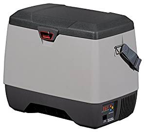

For whatever it's worth, we're looking at about a 40qt model, maybe this one https://www.engelcoolers.com/mr040f-u1-mr040f-u1-ac-dc-fridge-freezer.html We are near enough to their HQ in Jupiter, FL to go take a look at them in person for the final decision.

I have the Engel 40 qt you referenced to. I haven't had a chance to use it alot on 12 volt but when I checked for power consumption it started up around 2.3 amps. When it cycled on it was just over 2 amps. As I stated I have not used it on 12 volt for any length of time but have used it mostly at home for extra storage on 110 ac. It runs very little and mine is reasonably quiet when running. It will reach temps of 0 degrees at ambient temps of 80 degrees. So far I am very pleased with it. Friends have an ARB and they are telling me it is drawing 4.5 amps.
