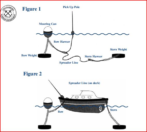

A Catalina mooring coil is like a big split-ring cotter in that it is a coiled piece of stainless with an eye on one end to which you shackle a line. The coil is open about an inch. So, you run it outside the lifeline to the bow. After you pick up the mooring and attach the bow eye, you slip the coil over the sand line and walk it back so that you don't get filthy.
In my case, I use an anchor retriever ring (see link) which I spread apart and put a big, heavy, cheap shackle on one of the rings and then attached some 3/8 cheap poly line, about 50'. The poly line is because you don't want to store a wet line. Anyhow, that combination works well. I take the line to the ring and bring it back to the cockpit so that I can pull it from there.
I have used it for three seasons so far and it works well. The weights they use on the sand line are squared off; they used to be tapered, so you can get a momentary hang-up sometimes, but it is no big deal. I did wonder if the anchor retrieval coil might slip off since it isn't coiled over itself like the Catalina mooring coil, but so far, it has never happened.

what is a sand line? never heard of this mooring arrangement before... here on the east cost, and in the BVI, I've never seen a mooring ball with more than just the 2 pendants, and sometimes the wand with a small line attached to one pendant.
Rick D
Jun 14, 2008
7,206
Catalina moorings have both an aft and bow mooring. They are connected by a 'sand line'. So the drill is, as Rick said, to pick up the bow line which is attached to the mooring can and wand, hook up the bow eye, and hand-over hand the sand line astern until you get to the stern eye. Sometimes if the mooring is too long for the boat, you just tie off to the sand line. The best practice, however, for longer stays is to run dock lines through the mooring eyes, forming a two-point bridle at the bow and a single point at the stern. This helps the boat not hunt so much, especially boats with bow cleats set a ways aft of the bow stem and the ability at the stern to play out or take in line as wind and tide changes. Way more than you wanted to know...
Apr 8, 2010
1,606
Frers 33 41426 Westport, CT
are they bow and stern moored so they don't swing (seperate moorings), or does the stern line also go forward to the mooring ball?
Rick D
Jun 14, 2008
7,206
Both the bow and stern lines are attached to separate moorings.
