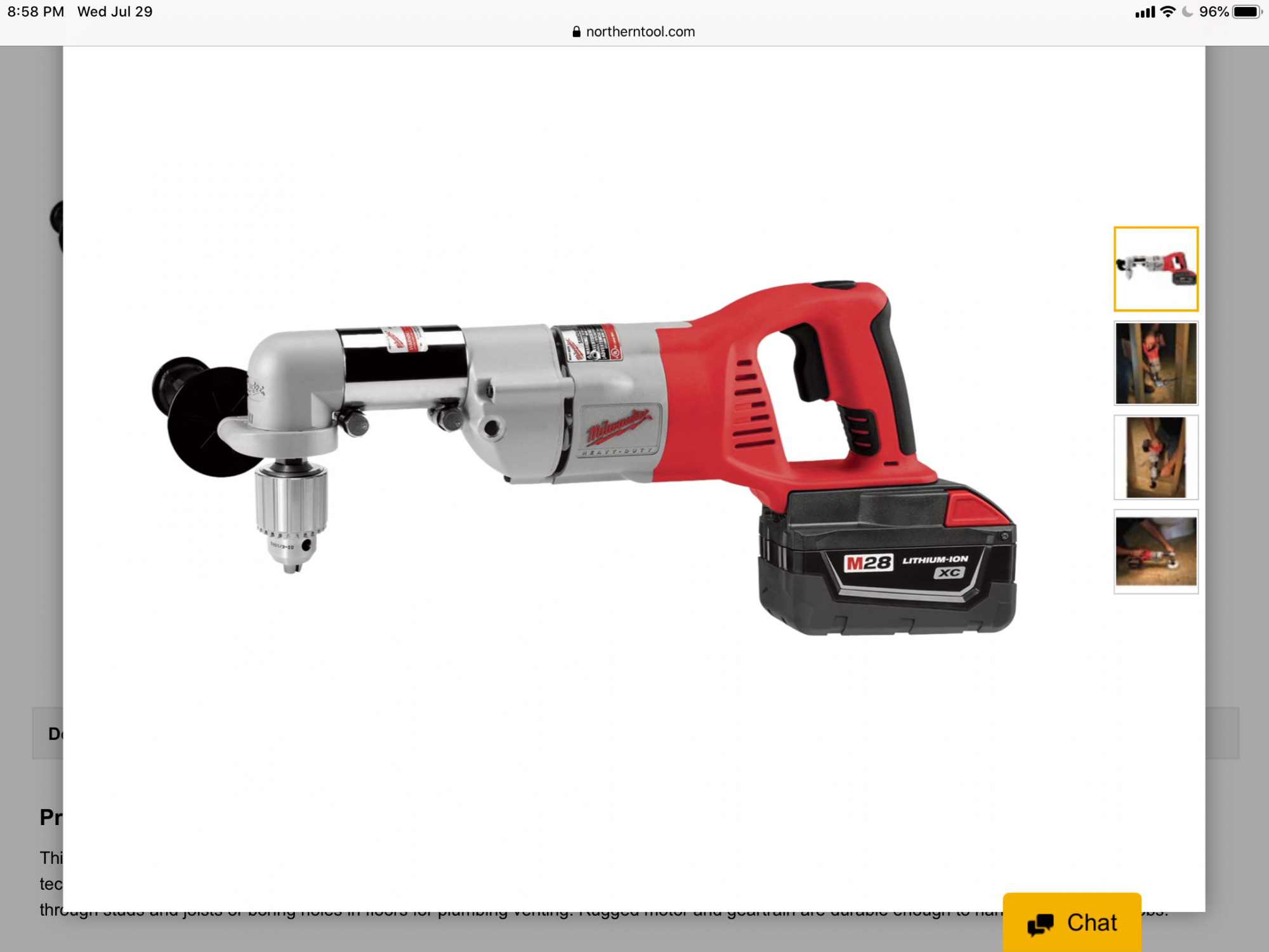

Winchrite is not awkward to use. It is much easier than the Milwaukee 28v rite angle drill I used to have. I hear there is a newer drill that is lighter

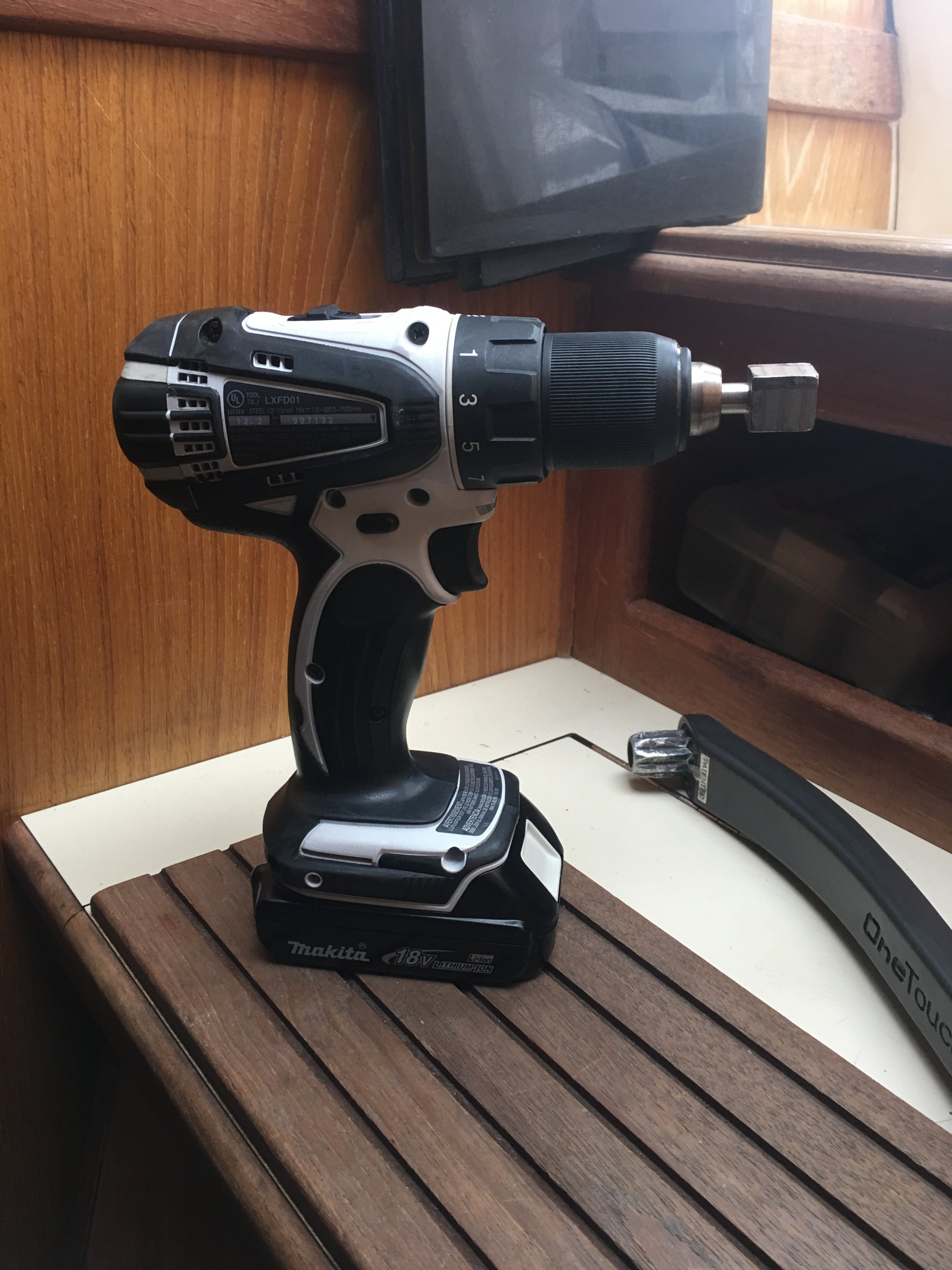

I had just taken this photo for a friend that sailed with us and watched me raise the main on my Hunter 340 with it. He wants to use the same set up. It will raise the the big main on my boat to within 6” or so, you have to hand crank the rest to get good tension on the halyard.
But, it will hurt you if you try to hold it by hand and aren’t strong enough or you don’t release the trigger if the halyard jams and the drill keeps twisting. It can hurt you a lot, like broken fingers or wrist. I brace it against my leg while it’s turning. I really do not recommend it for someone who does not use power tools on a regular basis and is familiar with and can handle the torque a drill like this can produce. A guy was using this same drill on a 12’ ladder at work and the bit jambed in the ibeam he was drilling and it twisted him and the ladder over on to the ground, only bruises luckily.

I like your set-up but agree I might hurt myself with it. I'm leaning toward the WinchRite because it's light and looks easy to hold onto if I get myself set-up and braced. Thank you!
