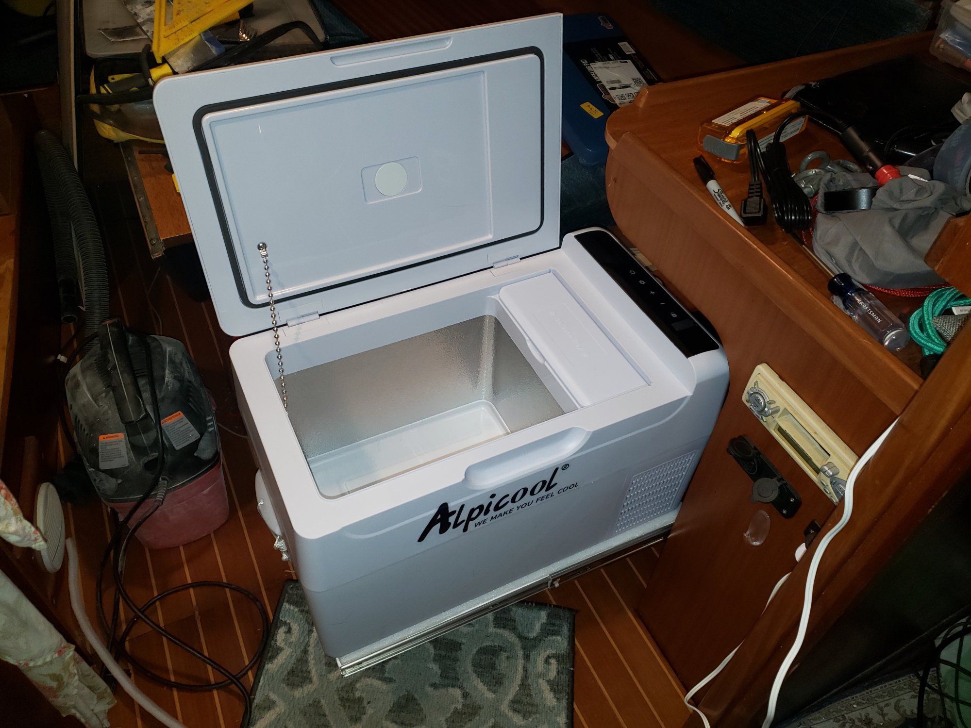

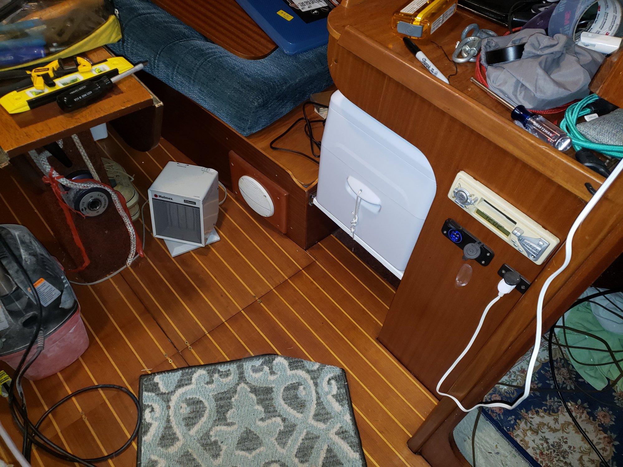

For what it's worth, I have a much smaller single zone Alpicool C22 that is rated at 5A, but actually draws 3A with a 30% duty cycle for about 24Ah/day. I leave it running while sailing with no problems though I rarely hit 30° heel. I have a 100Ah LFP and can run for 3 days without solar. With a 100W partially shaded foredeck solar panel I can almost break even. With a 140W panel on the Bimini I have plenty of power to spare.

I've had it three years so far, but my 22 liter is much smaller than any of the dual zone dometics. I choose it because it was inexpensive and fit my space (plus Sam Holmes has one!).
