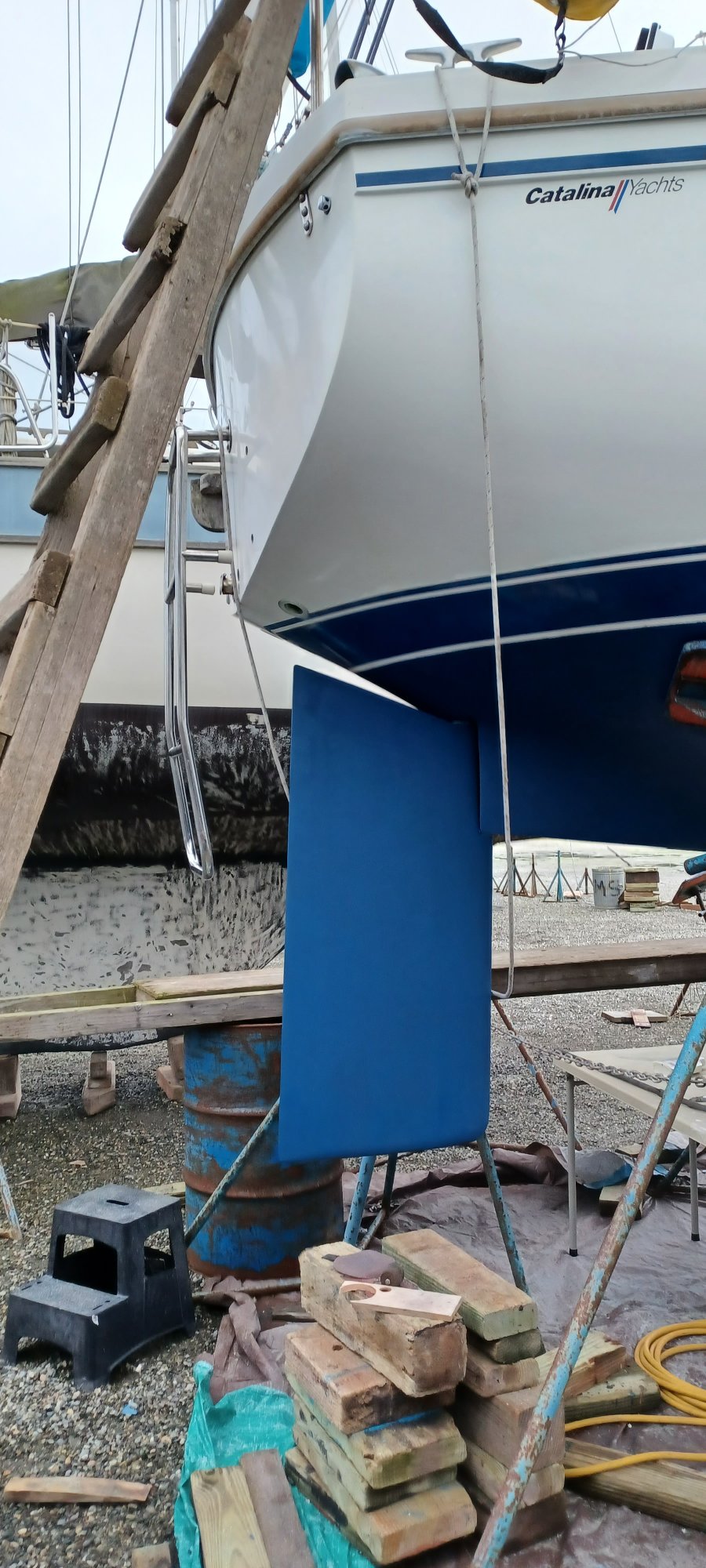

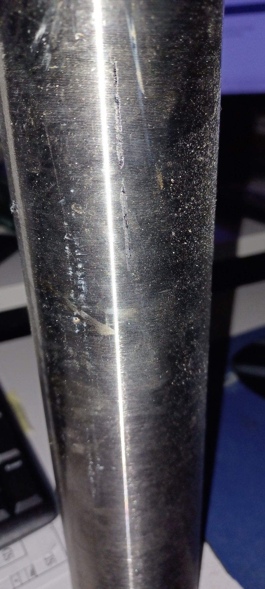

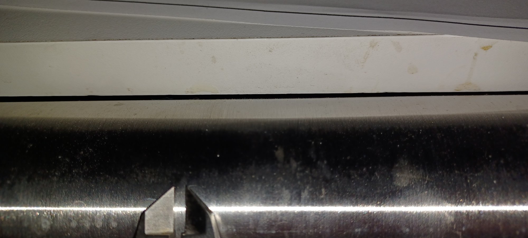

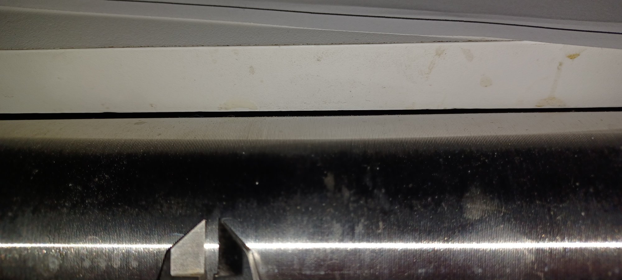

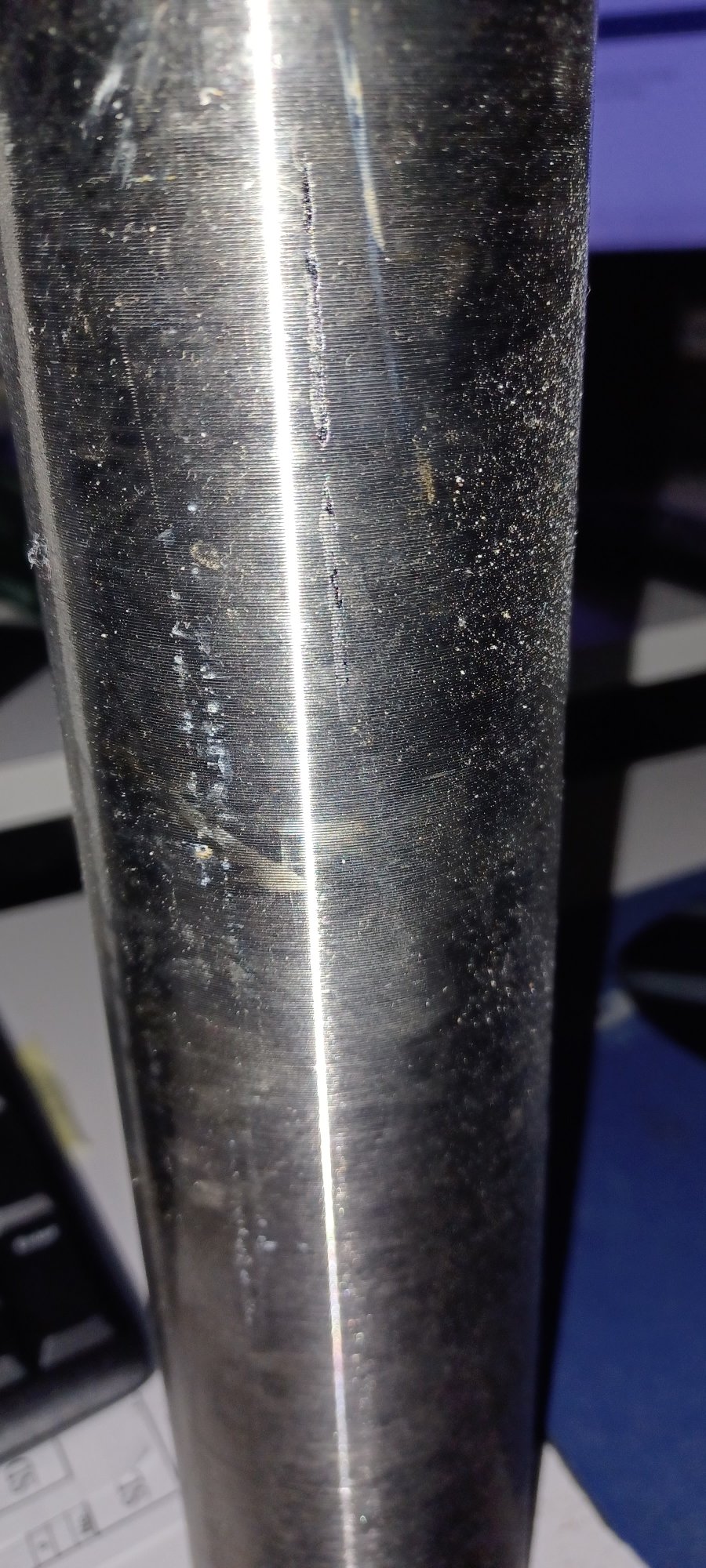

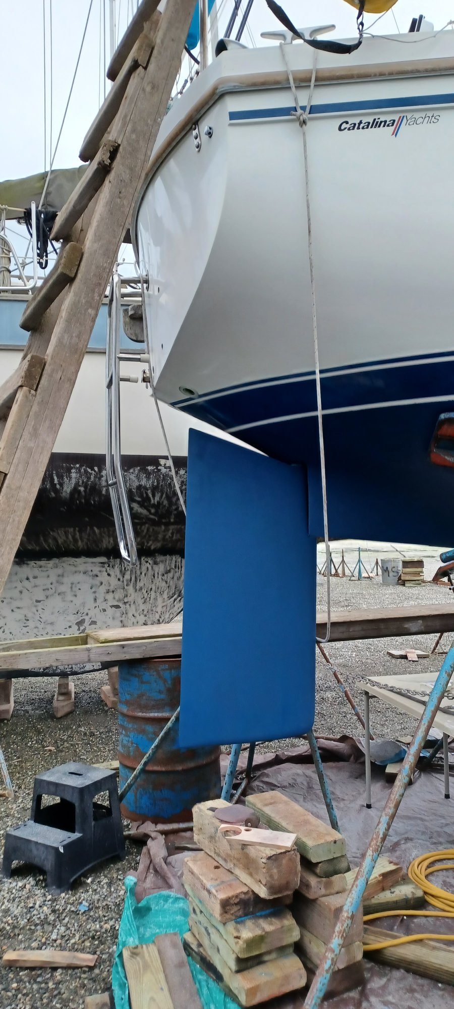

I installed a Ruddercraft rudder on my C30 in 10/21 and like it. It significantly reduced the weather helm when motoring and has given me good performance. My only complaint is that when they turned the shaft, they did not do a final smoothing cut and there are tiny ridges in the shaft. The second photo has the tip of my calipers set at 0.100" and I cound 9-10 grooves so the shaft is bacially a 100 threads per in screw. It is likely that this would not cause a problem except that I did the graphite / epoxy repair to my rudder log at the same time I installed the rudder. The epoxy formed to the threads, and it was stiffer than I liked when I finished the repair but figured that was because there was no water in the log to lubricate it. That was not correct, and the steering is tighter than I like. At the time, I figured that the tiny grooves would quickly wear down and the rudder would be easier to steer. That also was not correct. In 2.5 years, it has not gotten any easier which speaks well for the hardness of the epoxy / graphite bearing repair.
This coming week, I am going to drop the rudder and use my cylinder hone to lightly sand the inside of the log until the rudder turns freely.
These pictures are of the cut off end of the shaft. I spent several hours sanding the shaft in the area of the log bearings which took the points off them but not enough to really make it smooth or polished.

All of their rudders are made to order so can be costomised. I had them upgrade the shaft from 304 SS to 316. Were I to do it again, I would insist on a clean pass on the lathe so that it did not have the threads. It is obvious that they used a single point 60º tool for the final pass which cuts fast but leaves a very rough finish.
