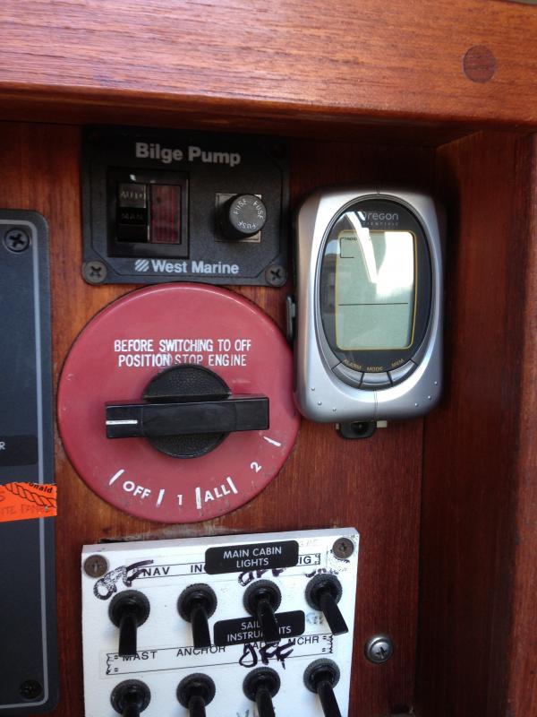

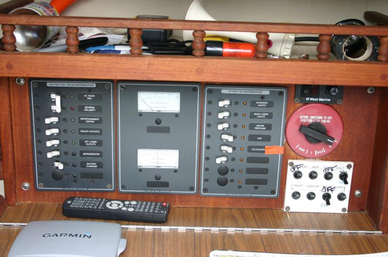

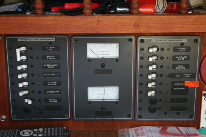

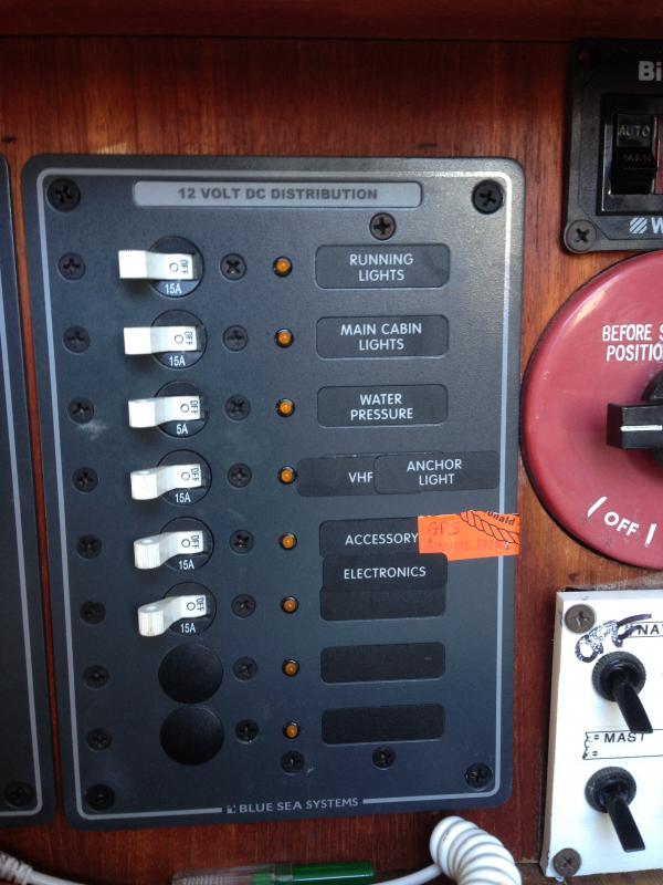

and I have a replacement Blue Sea breaker panel. I tested the breaker switches which appear to have good continuity. One problem though is that the P.O. left an older toggle type switch panel in place & wired up, as well as the new breaker panel for some unknown reason. Both banks of switches control the mojority of all circuits. The new panel appears to have all new wiring to the 12 volt & seperate 110 volt circuits. But the lights have older wiring where they meet the terminal connections in the forward anchor locker & at the indivdual cabin lights that appear to be daisy chained wired.
Since this wiring is sealed between the cabin top fiberglass sandwich layers it is a bugger to replace, so I'm hoping I don't have to pull new wire for the cabin & bow lights. There is power at the positive bus bar wiring connection but the negative lead end has bad continuity somwhere in the circuit, where it exists the breaker panel & runs in the main wirining harness exiting from the nav station under the cockpit floor. Not sure if it goes back to the instrument panel first or to the alternator.

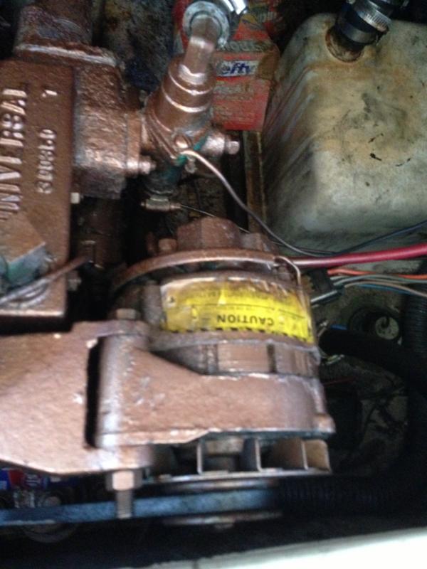

I am wondering if I have corrosion occurring at the R.V. type connecitons at the main wiring harness. Does anyone know if the main harness that connects from the cockpit mounted instrument panel to the engine alternator, etc. also has the lighting circuits included? I have traced a similar blue wire to the main harness at the alternator & am assuming it does connect here. But I am not sure why, as I assumed all interior lights were powered by the battery bank, which is charge by the alternator.
