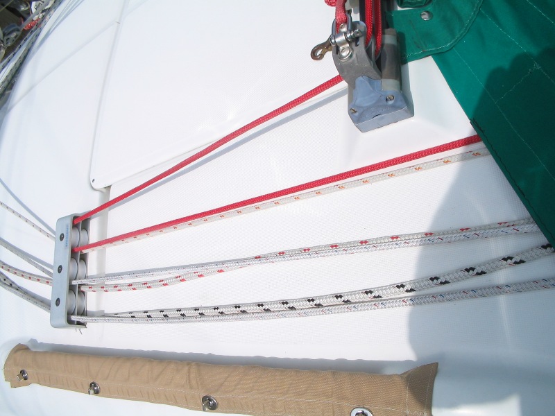

Dan, here's what I did with my B323 so I would not have to go through the dodger
- especially the glass. I took the cam cleat off the end of the travelers, re-routed the traveler line on both ends, led the line through a spare line organizer, then under the dodger to a couple line stoppers I added in line with the OEM stoppers. Some 323s have the cam cleat on the cabintop, where there are two dinples to locate it.
