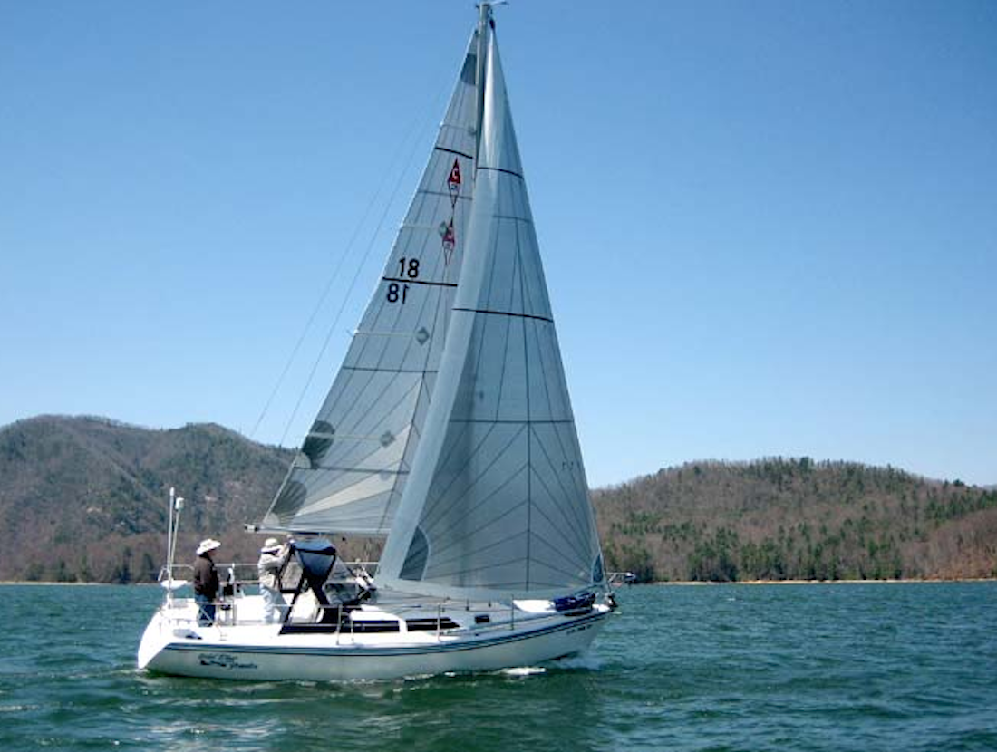

We are crafting a dodger for the C270. Currently the bows are being fitted, and they are, more or less, at about the same height as in the attached picture. While this gives great access to the companionway, and the winches, it appears to be limiting the forward view from the helm.
Here's the question: Which activity gets more weight in the height decision, view or access?

You should be able to see over the top of the dodger if you're standing behind it. IMHO the one in the picture is too tall... besides looking out of proportion to the boat it limits your ability to see forward while standing. If you want to stand under something and still see... add a bimini. The dodger's two main functions are weather/spray protection and keeping the cabin shady/dry with the hatch open. Ask yourself how often you would actually need standing room under the dodger... you're not steering from there.... so NEVER. If your sitting down at the helm, you can see through the window. If you like to stand you won't be able to see the tell tales with the dodger at that height.

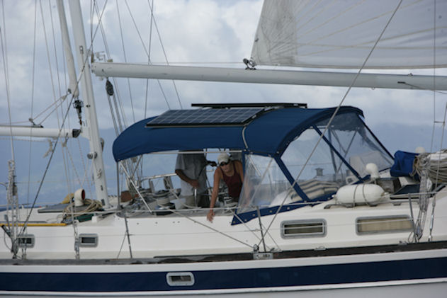

I've been on several other boats like ours with lower dodgers and biminis and I'd NEVER trade my set up for theirs. We can stand comfortably in the dodger in a squall to watch the action w/o bending at all and access below is standing up straight all the way.
However, I can see just fine through the dodger from the helm, so it's not like I have to choose one or the other.

Way too tall dodger. High performance sails and all that windage don't go together. I want to be able to see over my dodger from the helm. Can't see over that dodger from anywhere behind it. Dodgers with spray and rain on them have poor visibility through the windows.

Thank you all for the opinions. I thought the installation in the picture was a little tall, the test fit yesterday was too tall, a bit got whacked off this morning, and it's a good compromise, there's no way it's going to hit the boom, standing gives a clear view over, and it's high enough that it's easy to get in and out of the cabin.
