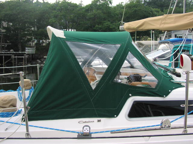

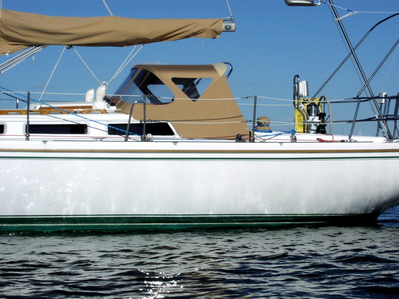

Hallett Dodger:
There are soooooo many options that it gets mind boggling. The best advice I can give is to find the best canvas guy you can. Dodgers are one of the toughest canvas items to do well and many fail miserably at it.

A very poor & pathetic example of a dodger:
The well made and well executed replacement for that dodger by Mobile Marine Canvas:

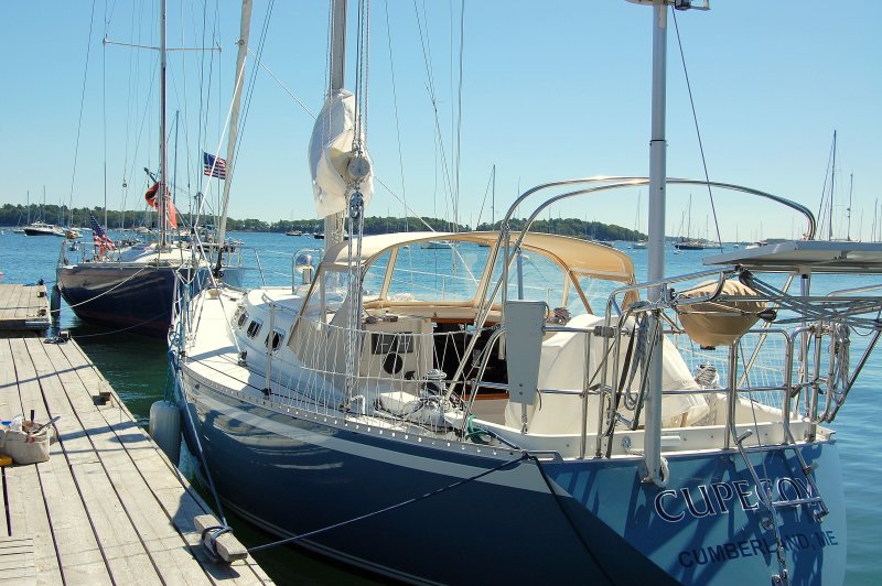

+1 on Mainesail's comments. These are tricky pieces of craftsmanship and not cheap. The narrow coach roof of an Elan 31 will also be a challenge but you really will want the protection of a good dodger for New England cruising.
A few lessons I've learned over the years:
Most people never take their dodger down.
Use strataglass (or better) for the windows. Regular vinyl goes too quickly. Use only strataglass cleaners.
Use the 316 SS tubing and oversize it (e.g. 1" or bigger) for any major pieces. The rust on 304 will drive you nuts.
Always have the dodger fabricator test mount the tubing on the boat before the canvas is made. I really like to have all of the following (not always possible). 1) Is it comfortable to stand on a step of the companionway under the dodger? 2) do I not hit my head on the dodger when going up or down the companionway? 3) When I stand at the helm can I see the jib furler drum over the top of the dodger? 4) When I sit, do I have good visibility through the window. 5) Make sure no winch handle hits any part of the dodger (check this last item also on the bimini bows.)
