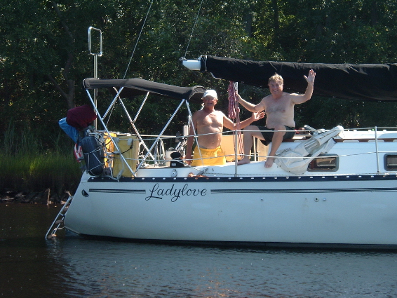

How did this old thread get resurrected? Funny how these things happen.
Harry, my H37C still has the original 1979 dodger. It is the short variety because my mainsheet is on the bridgedeck(where I want it by the way). It was made by Island Nautical( http://www.islandnauticalcanvas.com/ ). They have the exact patterns for both versions of dodgers and for the bimini.
The custom biminis here on SBO are a good buy also. They no longer show a premeasured for the H37C but you could go with a custom coaming mounted. No dodgers on the SBO store however.
I made my bimini from a Sailrite kit. I chose aluminum against all advice. Eight years later it looks better than the stainless rails. I chose a kit because I wanted to keep my boom height the same while still getting a large amount of cover. It goes behind the rails and forward to the mainsheet. To do this required having the front bow lower than the middle and aft bows. Best feature is easy fold up when we don't need the shade. I really dislike being enclosed. I sail to commune with nature, not be isolated from it. But the Atlantic requires a solid dodger.
