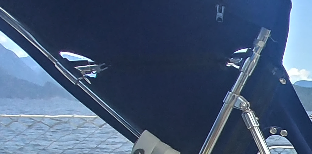

Making some progress here. Receive a few quotes. But the one I like most has one irregularity. The dodger frame is in place and they are happy to work with that (other have insisted they use their own frames) but has quoted $700+tax for the grab rails. Apparently the angle brackets need have to be made custom (I wanted to ask by who!). Does this strike anyone else as a bit extreme? I've attached a pic with our current grab rail viewed from the mounting side of the dodger. I see that yes these do look like rather custom items, but $700?
It seems the rail itself can be purchased for much less in various formats. And isn't this something similar to what we are looking for? https://www.amazon.com/Stainless-Polished-Fitting-Connector-Handrail/dp/B0CYLSX8NR?th=1
Perhaps I am over simplifying? Maybe the angles are very tough to work with? Anyone DYI'd this themselves? (just talking about the grab rail, not planning on taking on the whole project)
24,949
The issue is set up, matching your existing hardware and making the time expended worth the shop's effort, which is factored into the quote.
