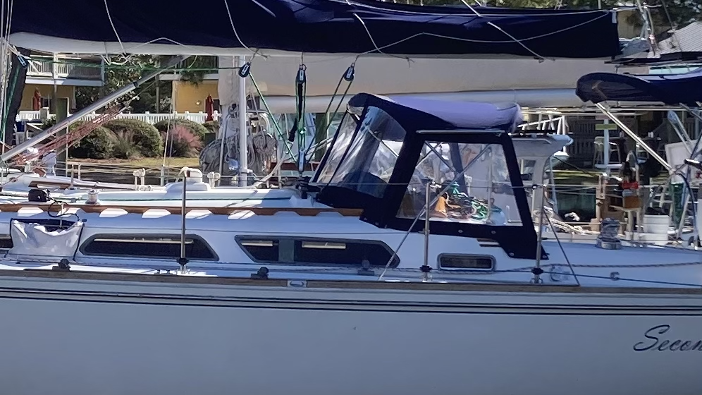

The connector can be a tricky issue. On my boat (also Catalina 320), I believe the dodger and bimini were custom designed for the previous owner. The back frame of the dodger is just below chin height when I'm standing in the cockpit (I'm 6'). The bimini was designed for a short guy who could stand on the seats without crouching. I'd say it is about 6" taller than I need it to be. I do love being able to see clearly over the dodger but my wife and I both frequently hit our head on the back frame when climbing out the companionway.
The connector spans the space with a new, clear vision panel, but it droops so much that it does not provide a clear view. We are looking through a near horizontal film of vinyl. It's not possible to stretch it tight enough to improve the angle, but we have realized that if we can support it with battens to make a concave vision panel (bowed upward), we will be able to see thru it clearly. It's a modification that we haven't completed yet but looking forward to how it may help. We only put the connector on when overnight in cool weather or raining so it is typically not an issue when sailing.
