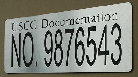

I noticed this being advertised.... don’t fall for the hype.
FYOwners, this is bull$h!t. Don't fall for it.
The official # DOES NOT need to be displayed in the cabin as the ad implies. It DOES NOT need to be ”CLEARLY” Visible to everyone. It needs to be visible w/o removing a structural member, cabinet, equipment, etc. etc. (e.g. could be inside a cabinet door or engine compartment) and IT MUST BE on a structural member AND applied such that removing or modifying it would be readily noticed. (e.g. engraved into a structural member, or numerals applied and epoxied over would comply.)
Screwed inside a cabin with #6 screws, as the ad implies, does not meet that requirement. Gluing it in place MIGHT meet the requirement, unless it could be peeled off and replaced with another plate/number.
Documentation Placard
Who says a documentation placard can't be beautiful?
All documented vessels must have their ID numbers displayed on a clearly visible, structural part of the interior of the hull. As boat designs have changed over the years, especially production boats such as Hunter, Catalina, Beneteau, etc., the large wood placards aren't necessarily what you want displayed in your cabin.
A sleek, brushed stainless steel documentation placard designed to meet all US Coast Guard standards
The numbers meet the required 3 inch height and are permanently fused to the surface of the stainless steel with a laser. They won't scratch or fade over time.
The placard measures 15 inches wide by 5 inches high. It can be purchased with holes sized to accept #6 screws, or no holes if you are going to use glue for attachment.
8,050

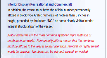

Hype and bull$h!t? I think that's a little over the top. Here's what a cursory Google search turned up:
From the USCG brochure "A BOATER’S GUIDE TO THE FEDERAL REQUIREMENTS FOR RECREATIONAL BOATS"
From Boat US:
The vessel must have the official number permanently affixed in block-type Arabic numerals of not less than 3 inches in height, preceded by the letters “NO .” on some clearly visible interior integral structural part of the vessel.
I agree that screws are not the best way to mount it, according to the regs, but it can certainly be mounted in some other way.
They're not sold as mandatory safety equipment, it's positioned right up front as a nicer looking way to display the numbers. It's offered with screw holes or without; how it's mounted is up to the owner.

Phil,
I think my point did not come across. It's truth in advertising (rare these daze in advertising and a lot of other things.)
The advertisement implies that one needs to have the NO. displayed in the cabin (in plain view,) so ipso, buy ours because it will be beautiful when you display it. That is plain and simple B.S. As I said there is NO requirement, despite the ad, that it be in plain view of guests, or the Admiral, or spotted during an inspection. As I said it can be clearly viewed if it's inside a cabinet, or engraved into an engine stringer, or whatever, so long as it's PERMANENT and on a structural member.
And affixing their plate with screws DOES NOT meet the regs, so I call that plain B.S. (i.e., a lie, but not hype.) That is not PERMANENT (i.e., be obvious if removed or altered.) A screwed-on plate is not permanent. Period.
Whether a Coastie or Aux member will ask to see or comment on the NO. was not challenged. I don't have an interior NO. and have never had an issue either.
