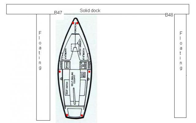

Hello all. Now I have a question about docking. I'm rereading my sailing books but was looking for info from others. My boat, 1982, 34' O'day, is in a single slip where I can tie lines out both sides and keep it floating in the middle. I will be moving the boat to the Saginaw River where I will only be able to tie up on the port side. I should be able to angle the boat to starboard with a bow line but the stern will be free to hit the dock. This is a floating dock well below my rub rail. Any opinions on dock guards or another way of protecting my painted sides other than hanging out a fender? As this dock is on the river, there will be a lot of wake, including wake from 400+ foot freighters sometimes, and I'm sure the boat will be moving around a lot more than where it is now. Also, as I am still new to this sailing stuff, my third season, I am going to pay for a licensed captain, who is an expert sailor, to sail with me for the 2 or 3 day journey. I am sure I will learn more from him than in the week long sailing class I took a few years ago.

I'm not sure I'm understanding you correctly. How are you going to angle the boat to Starboard if there is no place to tie a line to ? Trying to picture this but can't. Is there a Pile there to run a line to ?

Can you make a drawing to show us,I added fenders a long the dock with also some rubber bumper guard.

Many thanks to all who replied. Here is a bad pic. The cleats on my boat are shown in red. Sorry but don't remember where they are on the dock. I'll install my own if I have to. I'll be in B47 and B48 is empty right now.

Seems to me to be simple, your going to need a few good fenders to protect the Midship area and the Stern. Stern line will keep the bow off the solid dock and a Bow line to the solid dock will keep the Port bow off the floating dock.

What about a spring line from starboard to the solid dock?
I was in a similar arrangement with my old boat.
Just on the other side (like the B48 slip).
Also it may sound dumb, but before leaving I always lashed the tiller to port (starboard in your case). With even what little current there was passing the boat, it seemed to help somewhat in keeping the stern off the dock.

Jack Klang's instructions are quite good and well worth reading.
As for how to tie up the boat... use the following lines:
Two bow breast lines—magenta lines in drawing
Two amidship springlines—cyan lines in drawing
A stern breast line—Yellow line in drawing.
The bow breast lines will keep the bow centered. If you can use longer lines for this, that would be better, since the main pier is fixed by the sounds of it. Longer lines will help the boat deal with the tidal height change better. If you can't use longer lines for both bow breast lines, you could tie the port bow breast line to the floating finger pier instead of the fixed dock, and try going with a longer starboard bow breast line.
The spring lines will keep the boat from hitting the main pier or backing out of the slip.
The stern breast line will keep the stern from swinging out. If you have large enough fenders, you might be able to slacken the bow breast lines, since the fenders and stern breast line would keep the bow properly centered. Adding an amidships breast line would help with this.
Remember that you want to tie the lines to the cleats so that the loads on the cleat are almost parallel with the cleat, rather than perpendicular to the cleat. Cleats are generally not very strong at resisting loads parallel to their long axis.
