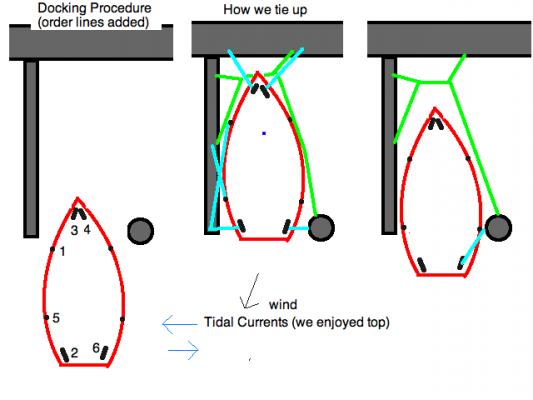

I made a diagram - the first image is us coming into our slip ideally, and the order we attached the lines. Our forward spring acted as a break, although I would reduce head way to a crawl, we docked into prevailing winds so I needed to motor against something as we got the others attached. The second image is how we are in our slip now, with the green showing the harness and light blue showing our dock lines. / diagram cleats and * show horns.
Whether pulling in or out, we hit 1/3 forward from the stern on the port side - the currents push us into the pier before we get settled. Pic three has my idea, but I'm not sure how the bow will respond. If I hold the starboard stern line on as I back out, the bow should swing to port (which will counter the strong prop-walk). In addition, I can feed it out as I back against it and it'll hold the boat against the piling correct?
My concern is
1) the prop walk is keeping the bow off the finger pier, so I don't want to cancel it completely
2) I think the bulk of the rudder is forward the cleat, so the current would push the bow towards the finger pier as well correct?

Andrew - I think if you approached it into the current, you'd have more control. If the piling is upstream, then a forward spring to the piling would probably work, once you run against the spring, either the bow or stern kicks out depending on where you turn the rudder, so you could catch it - hard to port to kick the stern upstream and then let it off as you pull in. I think I'll try that when I come back in next time.... hmmm..
