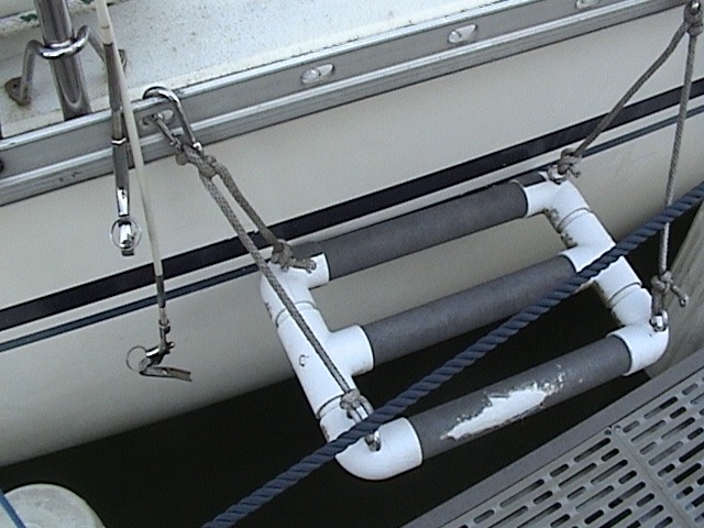

2. Built a portable boarding step the stays with the boat and is suitable for either side. It clips onto the toe rail. This step is half way between our gunnel and the average dock.

4. Clip on the boarding step.

Semiahmoo, a very nice marina. Belle-vie was in slip C3 when we purchased her in 2002. Remained there for two years, but got tired of the long drive from southwest Everett (Mukilteo). It was when we moved to Port Gardner marina that I installed mid ship cleats and built the boarding step. Before that it was always a monkey drill docking even with crew.
Now most docking is a breeze, even solo.
