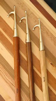

Doesn't anyone know how to use a boat hook for what it was designed to do?
23,526
Joe, those telescoping boat hooks don't work as well as the old-style solid wooden ones! :)

Please Joe, tell us idiots how to use a boat hook properly. Thanks.

Joe
Jun 1, 2004
8,351
That's my point... a traditional boat hook.. i.e. six to eight foot solid staff with a bronze hook end.... is an invaluable tool. The $20 teloscoping, lighweigt, plastic tipped poles don't really offer the same utility. And, thus, are not used with the same effect. But the main reason is few production boat sailors, myself included, would fork out $178 to $199.... for one, no matter how magnificent the product.
