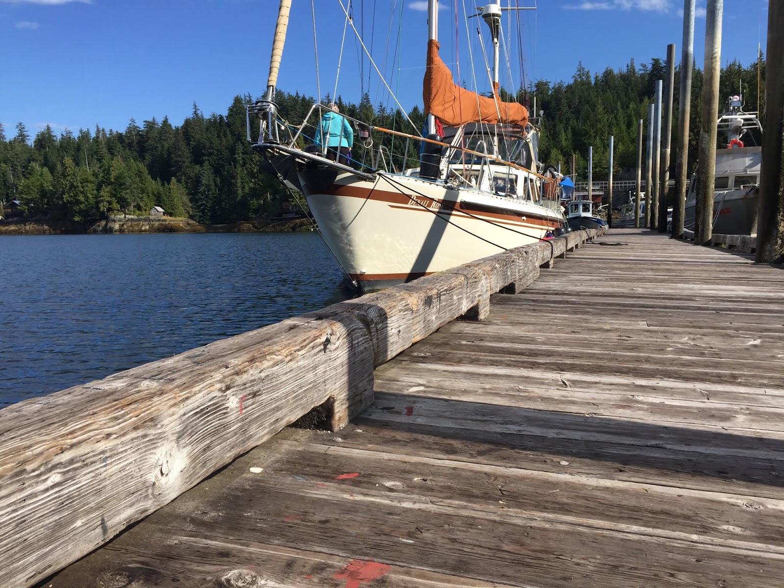

Up in the Northwest, we have what is called a "BullRail". It is a 4x4 or 6x6 that runs along the slip. Looks a little like this.

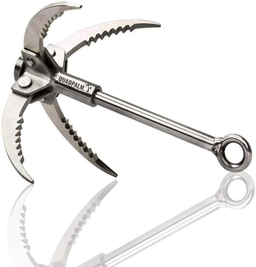

One way of grabbing the rail is the use of a foldable grappling hook.
The docking procedure remains pretty much the same. You just toss the hook over the rail and let it hang on.

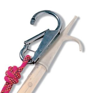

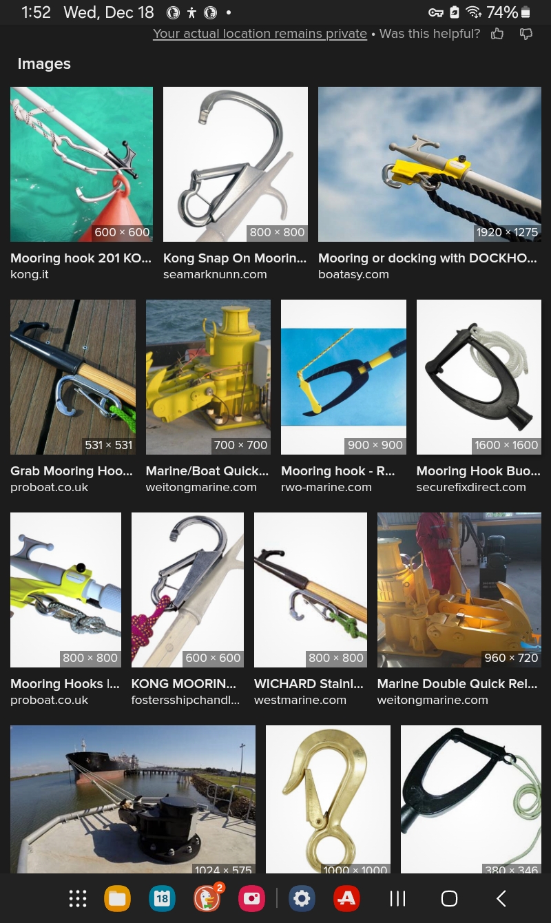

There are a variety of mooring hooks you can use to grab the ring with a line.
