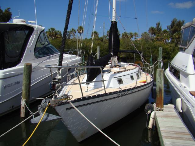

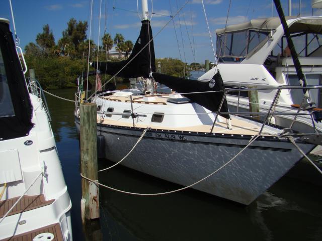

Wow, brain overload!
Thanks guys, great info. And yes, I can splice three-strand and that's a great idea. Friday or Saturday we may test again depending upon the weather. Of course there is that flea market on Saturday in Gulfport. :) Meanwhile I will continue to try to absorb all the new ideas.
So far I have only used two old halyards and those are between pilings. My docklines are all 5/8" x 25' nylon but the expensive prespliced. My springs are also good docklines.
Yesterday I moved the stern lines to be permanent on the aft pilings. I experimented with springs and think I will continue to try and use those on the windward "side" pilings. Port is good because it is at the end of the finger pier. It is right by the big black and small white fenders in the pic, barely visible. On starboard the post is well forward but worked OK the last time.
So I think the challenge is to get the stern close enough to the aft windward post to pick up the line. Once the forward crewmate gets the spring over the forward post it is too late, the aft line will be unreachable.
My idea is that I will bring the bow close to the windward aft piling so crew can retrieve it and hand it to me. Then as we move forward he snatches the forward piling and I can manhandle the boat to windward with the stern dockline. Sounds easy until you see how this boat gets blown about in this channel.

Much appreciated docking help.
The previous post is one example of the excellent ideas that you all have provided. As I reread them though I feel like I need a lesson. Pretty odd I admit having been on the water for most of my 67 years.
What bothers me the most about the slip is the distance from the stern to the aft pilings. It is a full eight feet or more from the cleat to either aft piling when the boat is forward far enough. If you miss a spring or getting the newly secured docklines then the stern will go where the wind wants it to go. Unless, of course, I pin the boat forward with a spring line as suggested. Then there is no way to get back there to pick up a stern line.
So the test will be to see if we can design a fail save method for grabbing the stern lines. There are lots of good ideas previously mentioned to try.

Ed, could you get part way in so you could set the port spring line bt still leave your stern out far enough to grab the docklines? Once you have the stern lines on you could have a crew member "slip" the spring line until you're far enough forward to tie up the bow. Also one word of caution when using a spring line. Once you have it attached and tensioned you may find you have to steer the boat to STBD to avoid having your bow pivot into the port side dock.

The previous post is one example of the excellent ideas that you all have provided. As I reread them though I feel like I need a lesson. Pretty odd I admit having been on the water for most of my 67 years."
Were you in a boat those 67 years? It is pretty odd, in that you have not even mentioned having boat hooks to grab lines off the pilings or to even keep you centered in the slip. Do you have boat hooks?
Quote>"What bothers me the most about the slip is the distance from the stern to the aft pilings. It is a full eight feet or more from the cleat to either aft piling when the boat is forward far enough.... Then there is no way to get back there to pick up a stern line."
Didn't you pass the stern pilings on the way into the slip? Pick up the stern lines as you come into the slip. Have crew on the beam to grab the stern lines and throw them into the cokpit for you to deal with while they do other lines.
Quote>"So the test will be to see if we can design a fail save method for grabbing the stern lines. There are lots of good ideas previously mentioned to try.
Get the other slip.

Lot's of good advice but I don't think that anyone advised you to run lines between the forward and aft pilings. That is one set of lines between the starboard pilings and another between the port pilings. This way as you start to back in the lines actually act as a net and help guide the boat back. You can also pull on them as necessary to keep the boat centered in the slip as you head back. Must of the slips here at our Marina incorporate this method.
Another option if you still want to bow in is two tie two lines from the main dock or other location to the pilings in a cross pattern. This way when the bow comes in the lines act like a pair of scissors that catch the bow and keep it centered as you head in.
