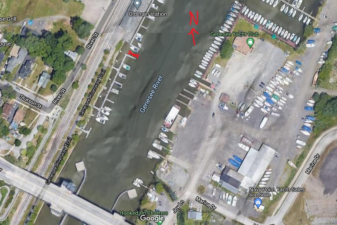

But now I am facing a dilemma that I am lost on. The boat is so much bigger that my original C-22 and the the C-30.
I am docked on the Genesee River which empties north into Lake Ontario. Normally, winds come from some northern point and a southern wind is always appreciated. It comes with warm air and since we're on the south side of Lake Ontario, there is no fetch and the sailing is perfect.
South..north, east or west, it has never mattered to me with my old C-30. My dock ran North-South and my finger was on my starboard (west side) of the boat.
I would come in, bump the finger, get off, hook my line to the aft starboard cleat, get back on and drive the boat into the dock, leave it in gear and secure the rest of the lines. Even with a heavy west wind, I would always be ok.
Now I am on the river and the finger runs east/west and it is on my port side. So that means ANY wind from the south along with the river's current pushes me off the dock.
I cannot for the life of me figure this out. The port side aft cleat is too far back to work my old method of hooking it up and driving into the dock...doesn't seem to be enough length to make that happen.
If I drive to power straight in, once I get into the wind shadow of docked boats, my rear end is still hanging out and it gets pushed north (possibly into the boat to my starboard).
I have tried to drive in at a 45 degree angle, but, there isn't enough time to do that and get off the boat and even hook the midship cleat.
Each and every time, I have had to back out of the space and try again. The last few times, I just drove the boat into the mud at the end of the dock, get out, hook up the fore lines and then back out of the mud.
I would hazard a guess that isn't the right way. The sad thing is, there is a Yacht Club almost directly across the river and I just know they can't wait for me to come up the river. My next step is just go over and ask them what they think I should do.
I enclosed a pic of the river and my spot (RED X).
I have watched countless videos about cross wind docking, just looking for some wisdom for folks that have seen it all and done it all.

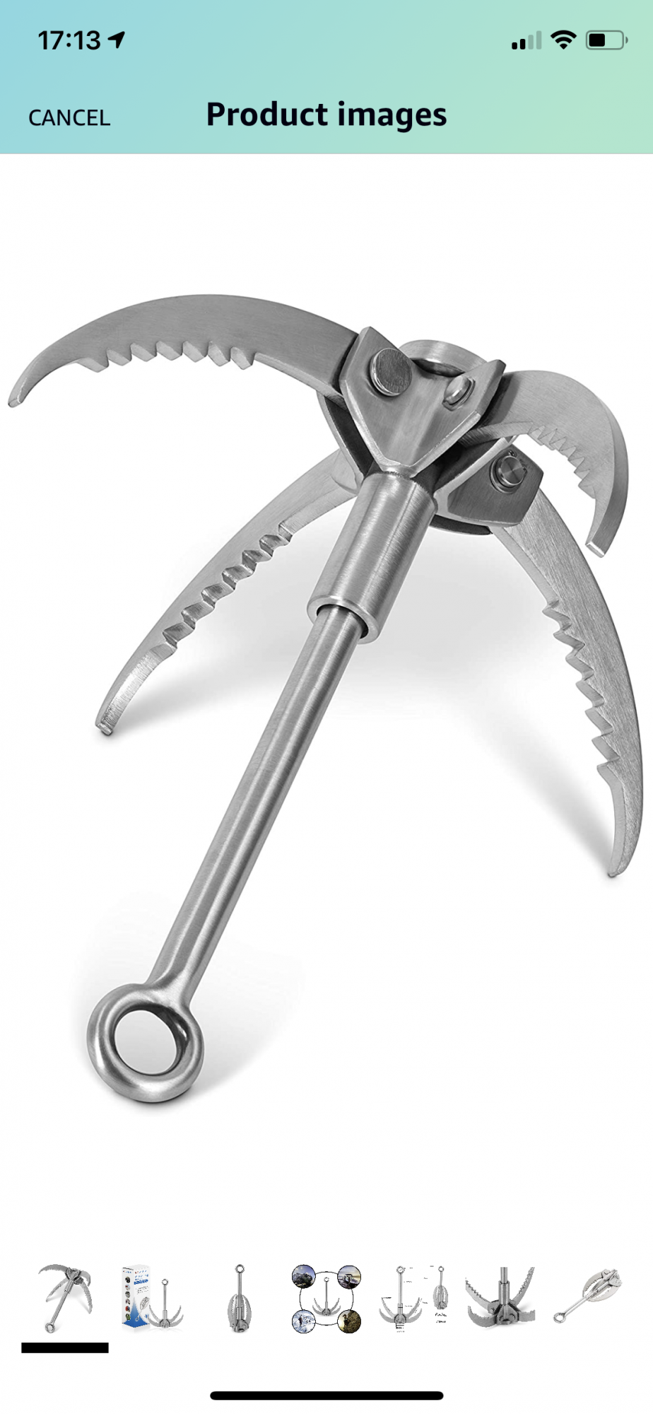

Up in Canadian waters they use what is called “bull rails”. Made from the native fir trees that are so abundant. Fir trees love to leave splinters (the size of small tree limbs) embedded in your dock lines or hands.
To address the lack of cleats and desire to reduce the incidence of splinter infections I have opted for this.
Collapsable, stored below safely awaiting the moment when called to spring into action. Threaded onto the spring line, tossed at the dock, it tenaciously grabs on. The rest of the docking procedure follows along as you see in the video.
You snug up the line at the stern and move forward in gear at idle as the boat snugs up to the dock.
To avoid entanglement with the prop, I keep the bitter end of the spring line in the cockpit. If the toss misses the cleat we retrieve the line and either try a second toss or since we are on the boat, do a ‘touch and go’ and go around to try again. Perhaps not enough speed to get close enough for the crew toss before slowing for the toss. Both with the help of crew or solo the Stern Bridle docking method has worked for me 98% of the time. If conditions are so bad that getting docked is too dangerous one can always anchor out till conditions improve.

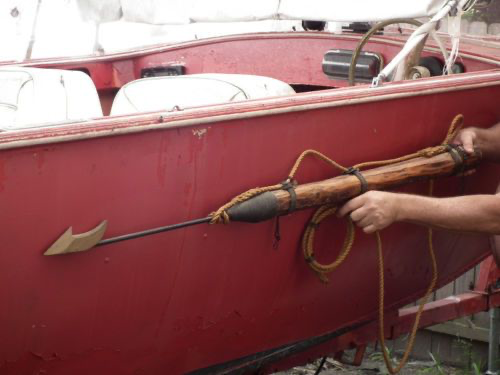

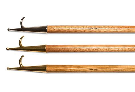

Not much more than spiking it with a Boat Hook and holding on...
Then of course there is the always the old ways of assuring you get to the dock...

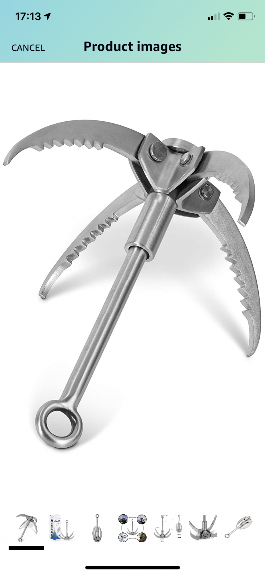

If you threw it over any dock it would work the same way. (All those James Bond movies are finally paying off).
