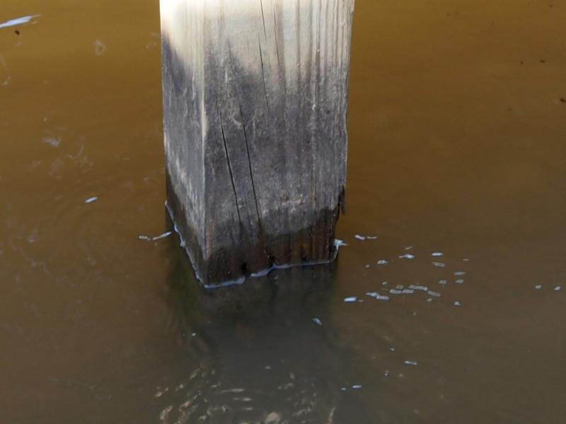

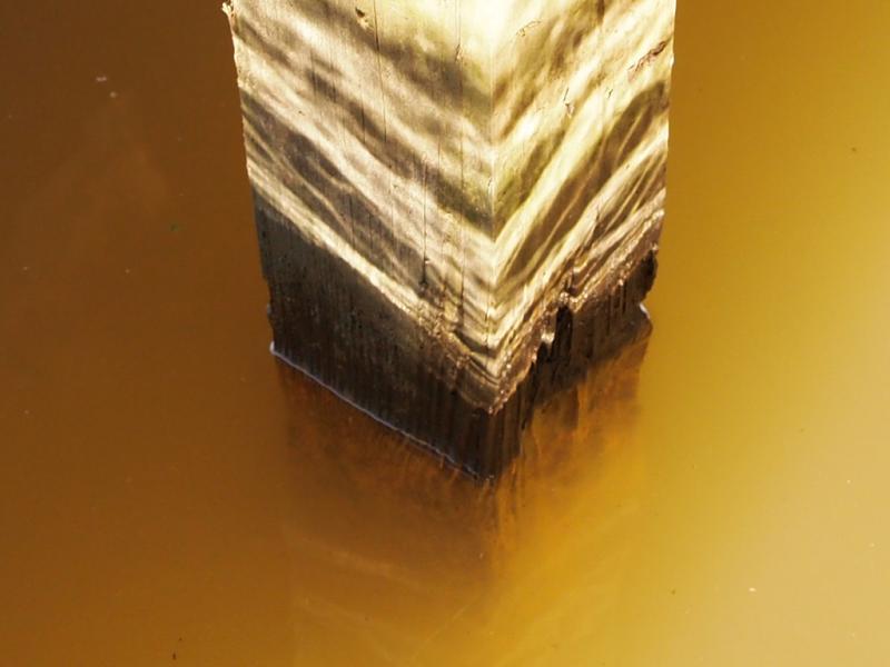

These are pressure treated 4x4 posts supporting my fresh water dock. There are 15 of them and they're about 20 years old. Do I need to start worrying?

You may want to be pro active with changing them. At very least the worst looking ones this year and then the same each year until they are all done.
I would test to see how much good wood is there by pushing a knife or thin bladed flat screwdriver into the rotting part. If you have less than 3" of good wood.... Change them while you can do it from the dock. If you wait it's a bit more work.
About pressure treated wood; Don't use it in water. The chemicals leach out. Fish don't like that. I would suggest a metal post such as galvanised.

Worse
I have seen worse here at docks in Florida and we have round like what you
have and in salt water and yes some have concrete pole and concrete dock pads.
I would say looking at them that they look pretty good and fresh water is maybe less harm than salt water and just keep a look out at them every year

All the docks in my neighborhood were built between 1970 and 1980 using pt 4x4s. The few still standing are beyond repair. A few owners extended the life of their docks by replacing posts, but that was a band-aid at best. It wasn't long before the decking also needed replacement and the entire docks had to be rebuilt. We're in Florida, hot sun and brackish water on a river that feeds into the Gulf. Most folks are wrapping new and good posts that are in the vinyl protective wrap. Another note, all posts do not rot out at the same rate. I had 8 installed at the same time. 7 are like new, I recently had them wrapped. The other is nearly rotted through.

First, the likely area of rot will be at the water / air interface. Submerged wood will last much longer so check around the water line. If I were replacing I'd use 4 inch PVC pipe and fill them with concrete.

When you take the worst ones out take a look at condition of wood submerged in the bottom muck/soil/?? depending on the flora and fauna this can degrade as well.
I like the idea of PVC encased concrete which should be easy to pour especially in fresh water.
If you can add a reinforcing rod down the center you'd then have reinforced concrete.
Good idea to paint the PVC escpecially top and down a ways into the water. Lots of PVC doesn't stand up to sunlight and will crack. Is dock subject to much torque from wind and such pushing on a boat tied up to dock? If so you'll need to drive deeper into the bottom. Driving a PVC pipe might prove troublesome.

Since 20 years ago CCA treating was still available I will presume this posts were CCA treated. CCA treated was suppose to last 20 years and in practice it will last longer but not indefinitely.Today they use other products to treat wood with equivalent results regarding the duration of timber in different different environments. All the procedure was and still is standardize. The biggest decay will be in the zone you have exposition to air and water, under the water the wood will last a life time especially if it was CCA treated. the whole structure will not collapse, you will eventually see one post or another giving in, warning you in advance. I would gradually replace the most affected ones but only the top part making sure to include the water line zone. Always remember pier posts must be flexible to absorb lateral loads.
