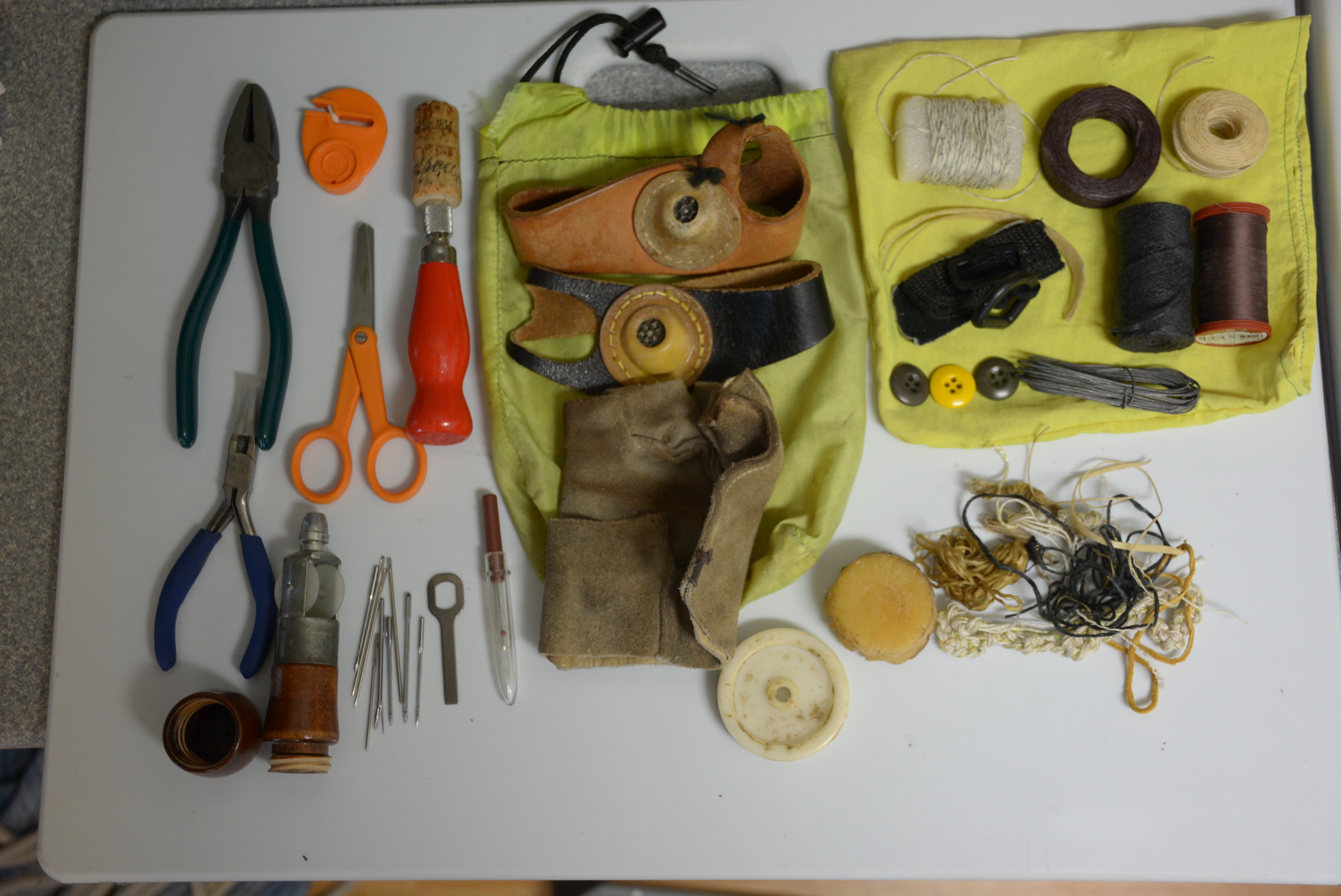

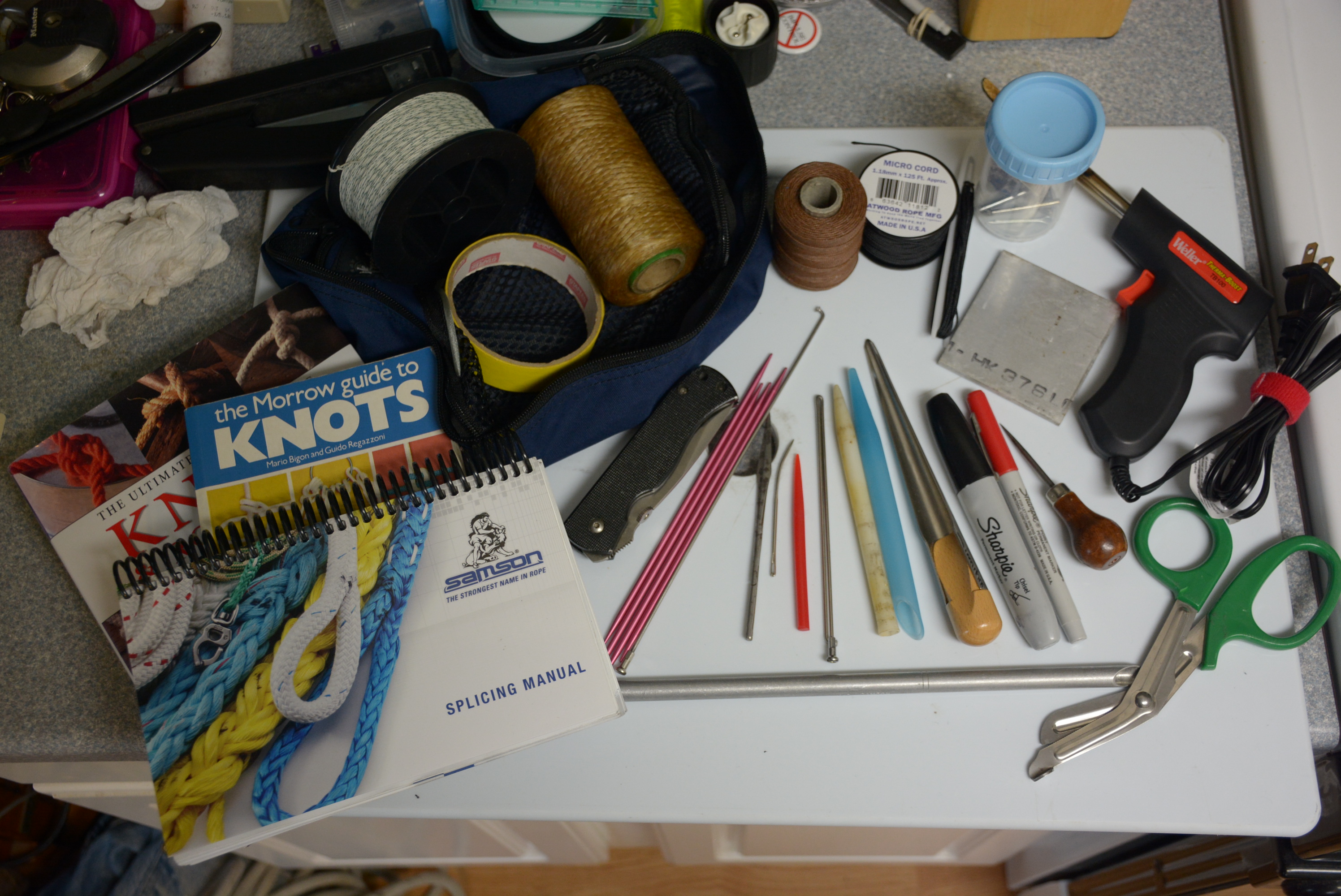

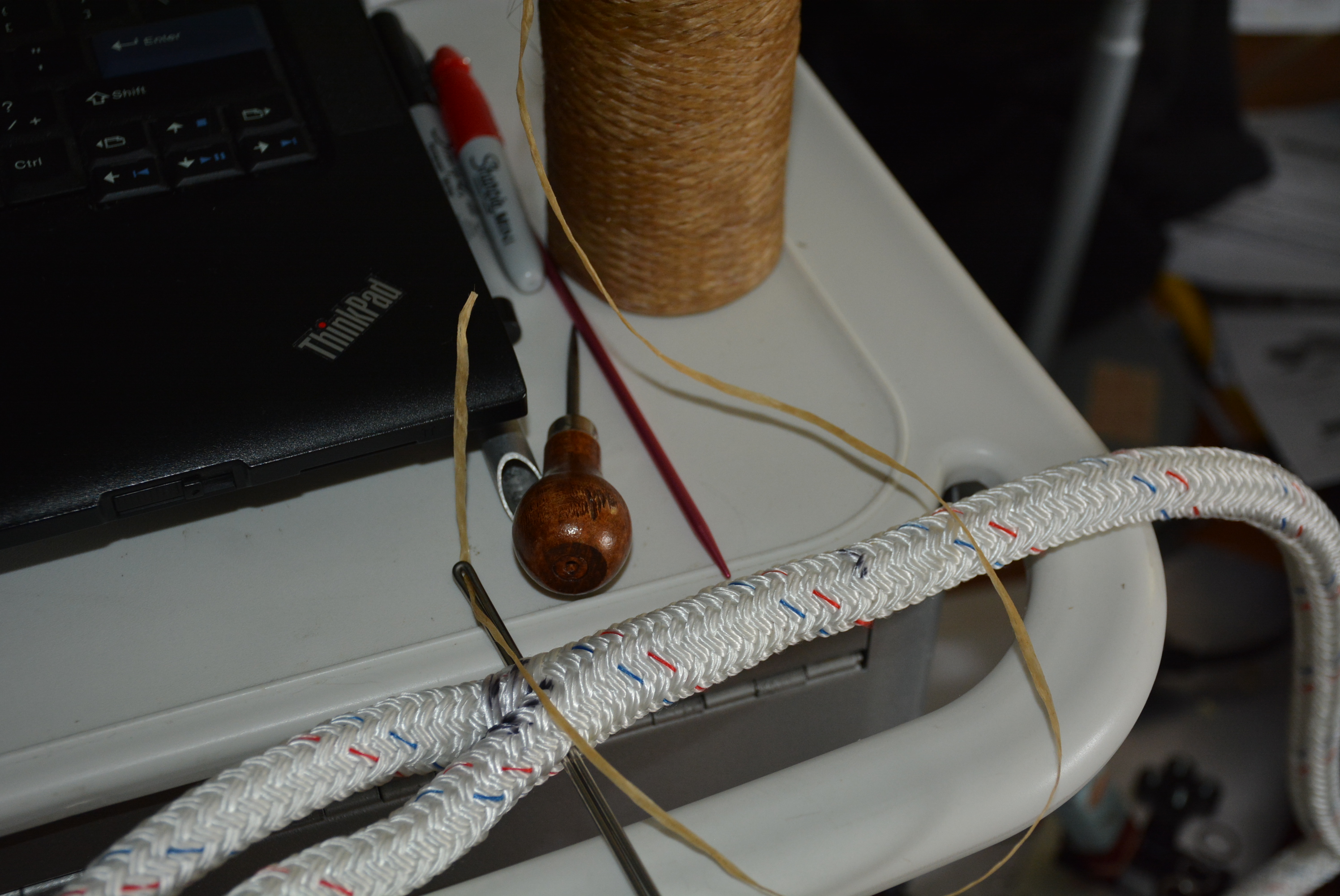

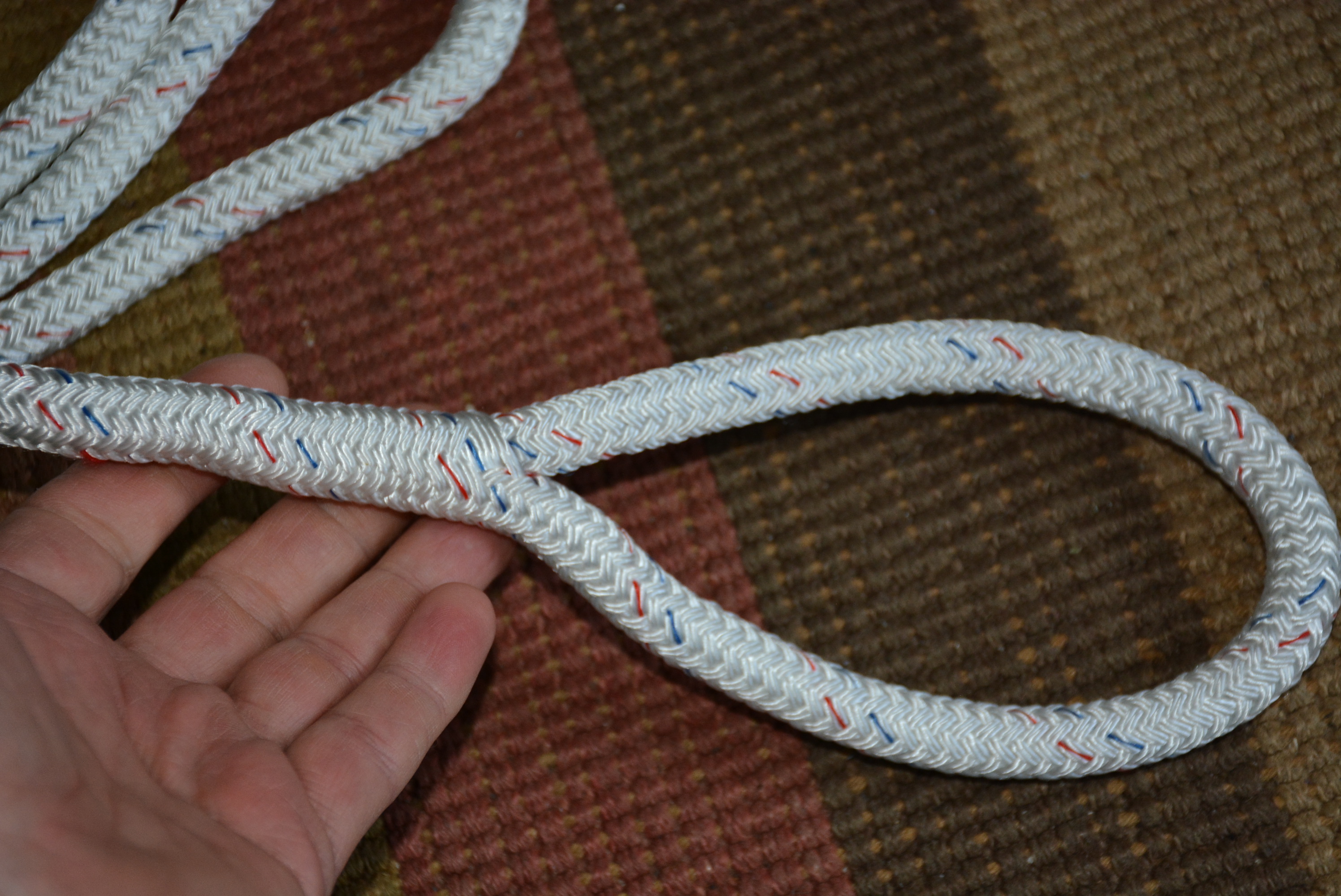

I'm going to make my own docklines. Already did my first ever eye splice in Samson Super Strong double braid class 1... 1/2"
I want to find a source for a 300ft or 600ft spool... I have a Hunter 28.5... hmmm, maybe 2 spools?
Seriously though, the other Dock Dwellers around me want to go in on a bulk purchase.
Anyone here have experience with a purchase like that and do you have a favorite supplier?
Is there a 'rule-of-thumb' for dockline lengths?
I'm going to make chafe guards out of fabric... no plastic tubing. Not really into taking the time to do leather.
What fabrics have you found that work good for this application?
DSC_4165.JPG DSC_4167.JPG DSC_4178.JPG DSC_4179.JPG DSC_4180.JPG DSC_4181.JPG
