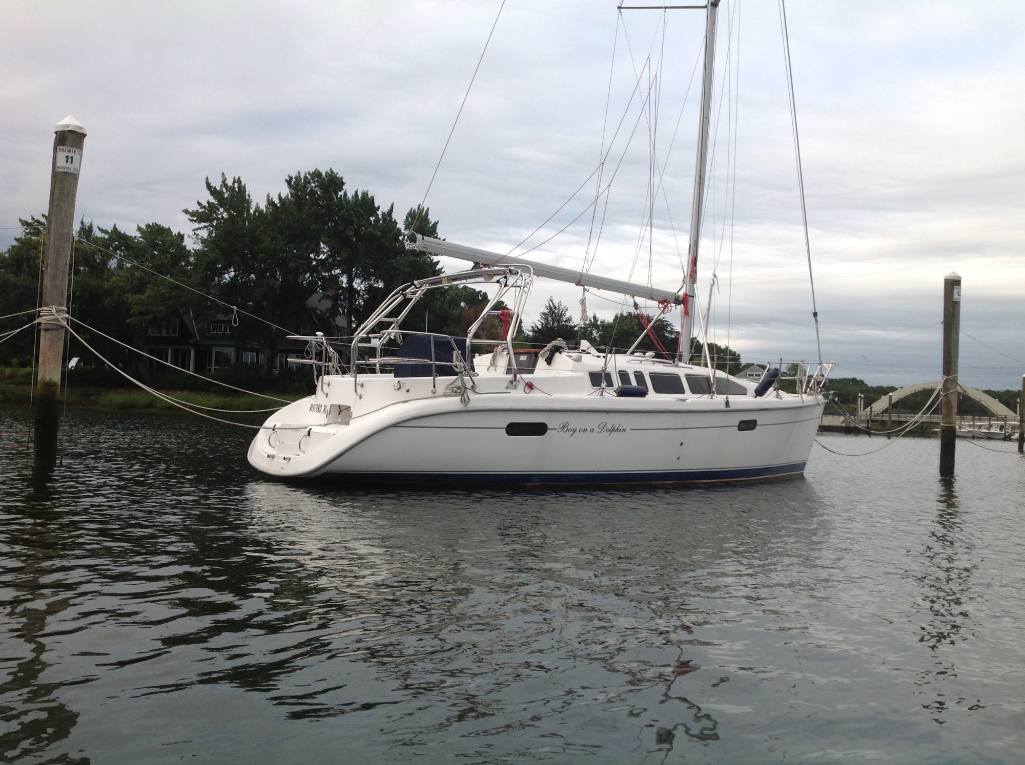

Could you post a photo of your line set up for us? In our case, we are between 2 pilings and I have our lines at about 4-5 feet above the high tide mark. These tend to slide down on their own as the season goes on, but I keep them at the 4-5 foot level above high tide.
What it does for us is keep the forward lines from getting wrapped and tangled in the anchor. Prevents chafing and eases freeing them when we leave the mooring. The aft lines being higher eases boarding the boat, not having to swing lines over our heads or wrapping at our feet.
Higher works for us all the way around. Of course you need to allow extra length in your lines doing this set up.
It also keeps the lines out of the water and collecting sea grass and stuff. Somewhat extending their life.
And when returning it places the lines slightly above us so we don’t need to bend down and reach for them.
My photo below is a little older, we were prepped for an incoming Tropical Storm, so I had slack in the lines to allow for the rise in tide.
I’ll take photos on Monday.
There’s a wooden hook that prevents the lines from sliding.
Looking at your photo I’d say my lines are at the top of the bow piling.

The hook is a great help. If you look close, On my aft piling I use the chain that was left on the pole when the piling was driven in, to hold the lines at that level. I screwed a stainless steel eye hook in the forward piling to hold the lines where you see them. At a moon high tide I can stand on the bow and raise the lines if needed very easily, same in the aft, by standing on the wing seat.
For us, the height removes the stress when returning. All our lines are at convenient positions. More so for my wife, who is at the bow and all she has to do is grab any of the 2 lines and just wrap a cleat. That holds us in and I neaten them up after we are on.
