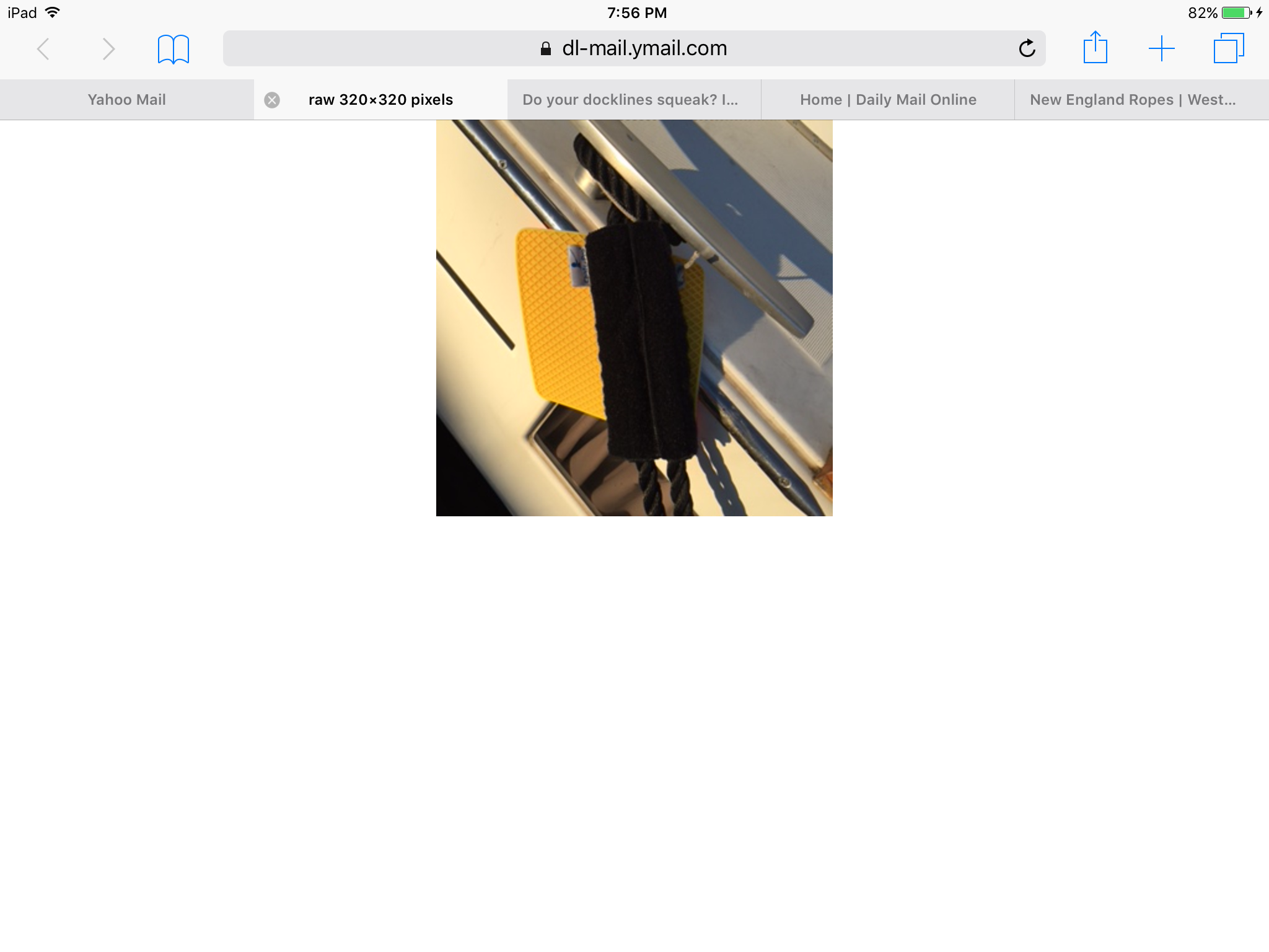

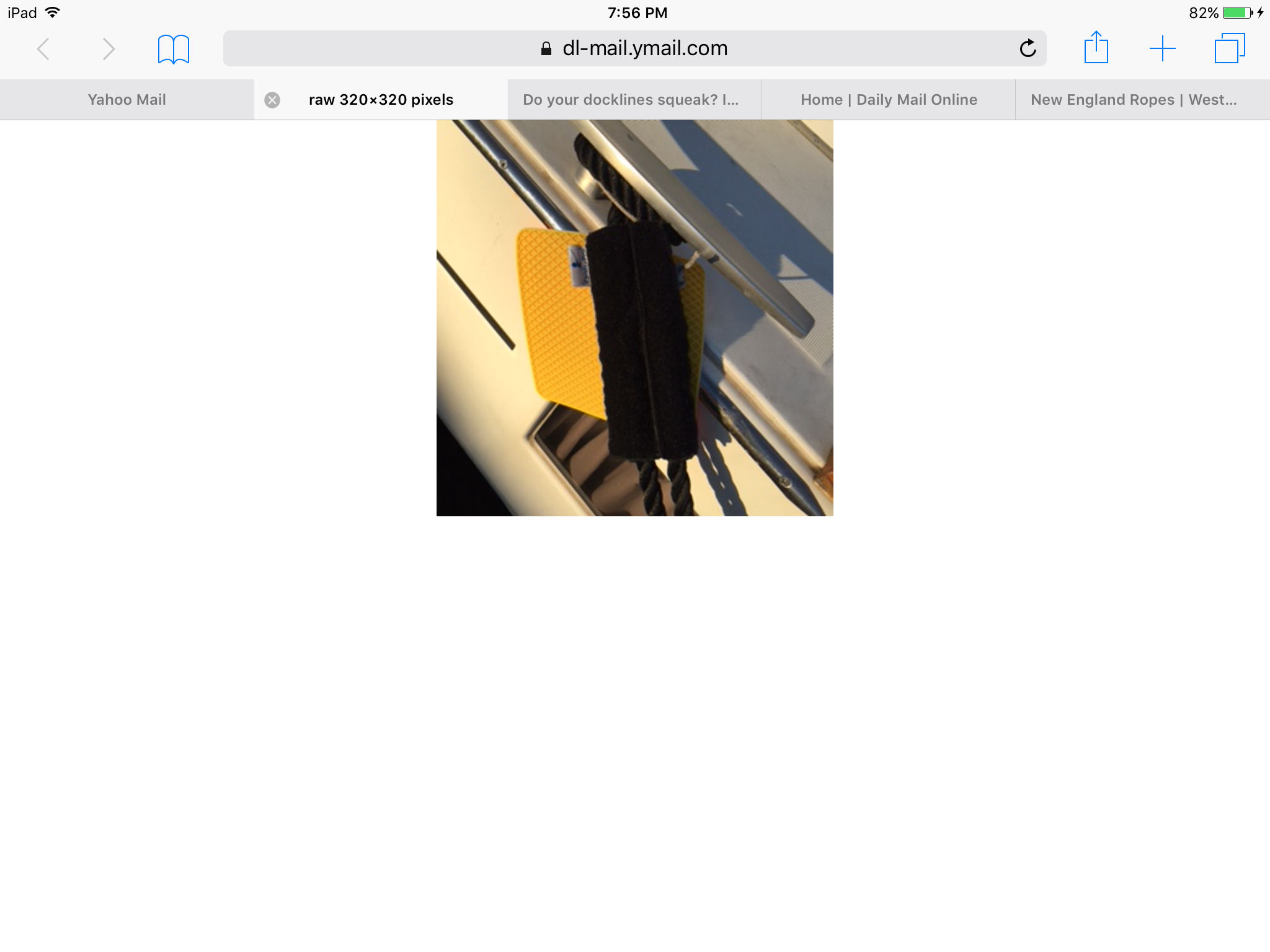

First, I bought new lines, no success. Then I tried chafing gear, no success. I tried soaping the lines, worked for a little while. I tried wrapping a small towel around the line. Worked for a while. My final, successful solution is silicone rubber hot pads. From the Dollar Store. Works like a charm. ☺

a) am I right in assuming the source of the squeak is at the boat cleats ?
b) what is the material of your docklines ?

West Marine (New England 3 strand black nylon, brand new). The squeak is actually at the stainless strake at the corner of the deck/hull. Squeaked as just lines, squeaked with chafing gear, no longer squeaks with the silicone potholder and does not damage the potholder.
