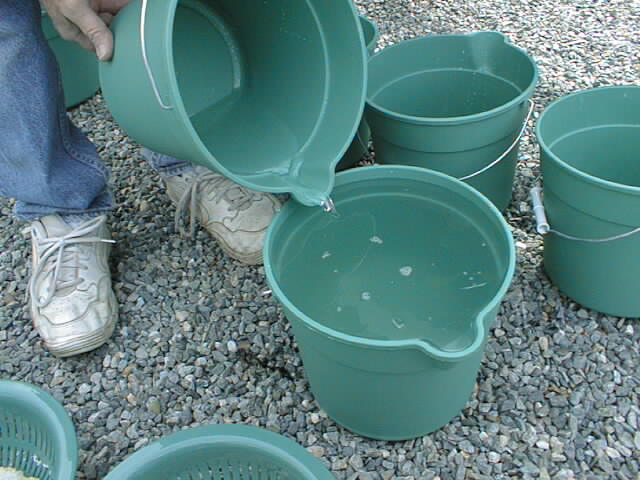

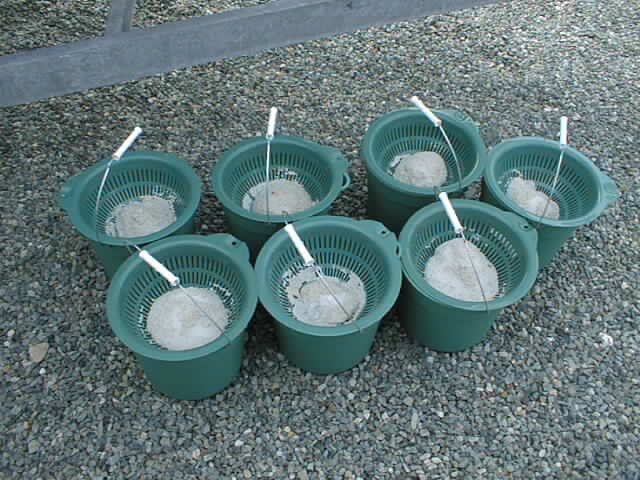

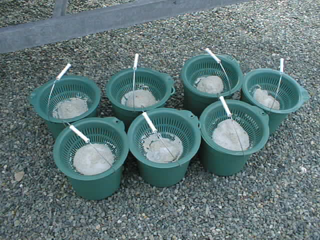

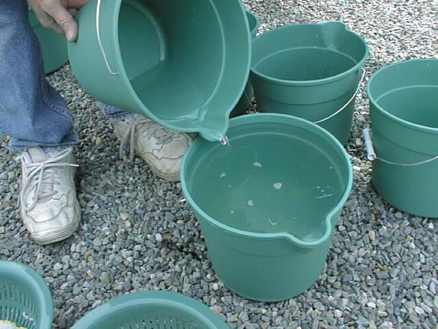

Electric dehumidifiers don't work under 40-50 degrees. As stated above, the humidity is very low in the winter, but rises in the spring. I set out seven buckets throughout the boat with colanders in the top and put a couple scoops of calcium chloride pellets in the colanders. It absorbs the water in the air in the spring and the water drips into the buckets. I get at least a quart of water in each bucket at the uncovering in April.

Seven buckets and matching collanders at the dollar store $14 one time cost. One 40# bag of pure calcium chloride $30. You now have 10+ years of humidity control.
