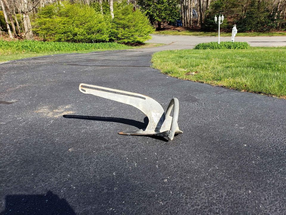

I'm thinking of buying this used anchor as a spare/backup for my boat. It's 15 lb.
  1. Anyone know the maker?
  2. what is that long slot for?
  3. do you you think this will hold my 38', 16,000 lb. displacement boat?
Thanks,
jv

Are you sure it is 15 lbs? That does not seem nearly big enough to hold a 38 foot, 16,000 lb sailboat. Maybe it is 15 kg or about 33 lbs If it is only 15 lbs I think I'd pass on it.

Yea, thanks, since I posted I went back and re-read the ad, I need 15 kg., at least. My Rocna primary anchor is 15 kg., and even that is marginal according to Rocna. 15 lb. won't do it. I'm going to check with the seller on that, too.

See that slot? That anchor is mostly made for fishermen who fish around rocks. The slot attachment allows the shackle to slide down towards the flukes and when pulled forward the anchor unhooks from any rocks it might be caught on. Should you buy that anchor be sure to attach your shackle to the hole and not the slot.

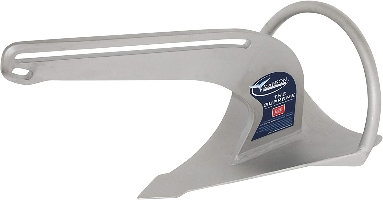

Thank you, @Bob S it certainly does! So, what's your take on a Manson Supreme?
I checked their website and they recommend the 35 lb. version for my boat's length and displacement.

I had it on my Catalina 30, it’s one of the original new generation anchors. It’s a solid anchor. If you search this site you’ll see Rodd had a good opinion of it. Only dragged once in 7 seasons. Anchored overnight outside Cuttyhunk Known for poor holding, eel grass. Woke up to a squall. No anchor would have held.

Yes, a Manson Supreme. I had one for 10 years. Very good NG anchor. No one uses the slot and they'd have been better not to include it; probably the marketing department's idea. But 15 pounds is too small. I had a 35-pound anchor on a 34'-foot cat, and I think that was about right.

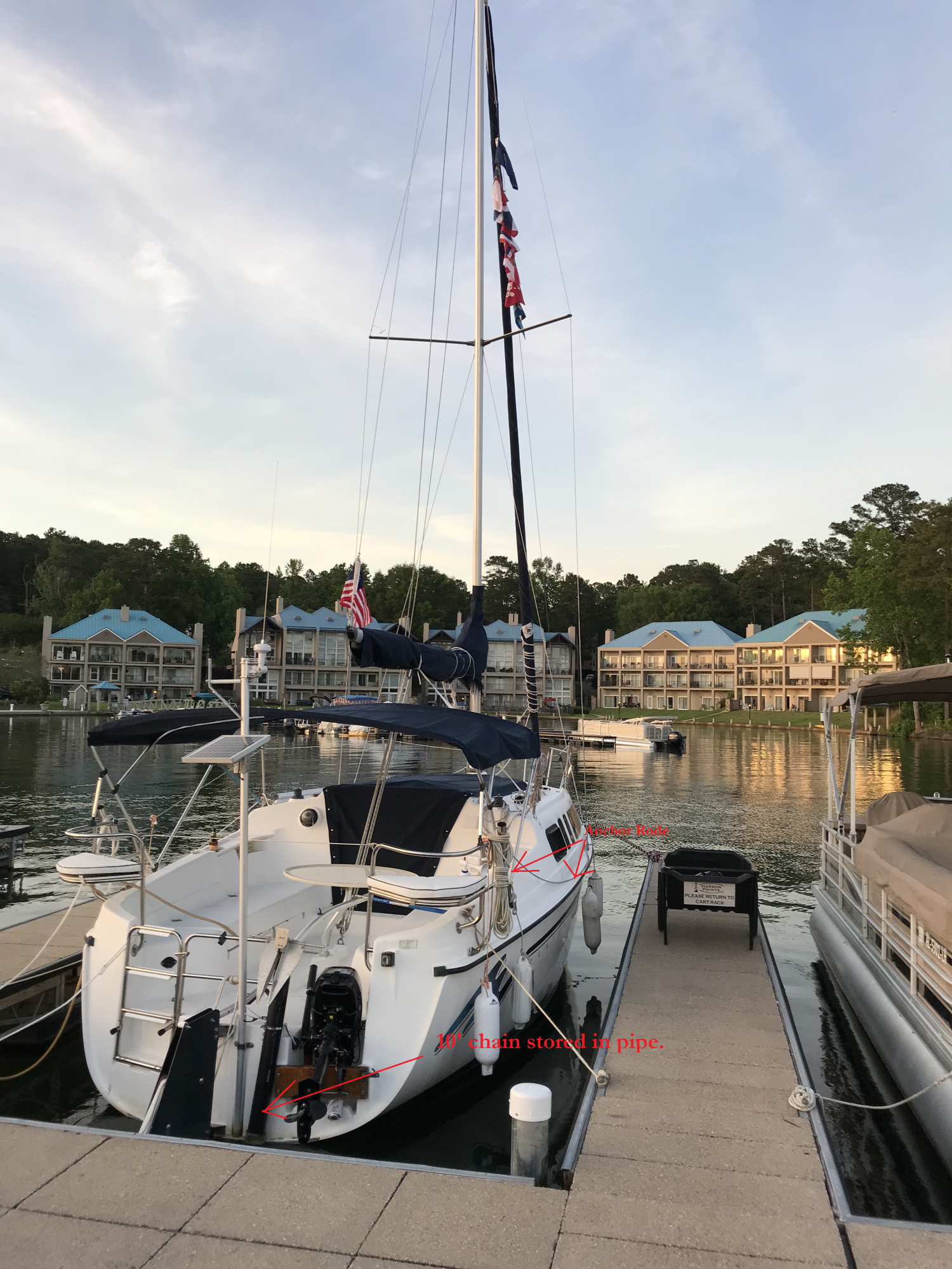

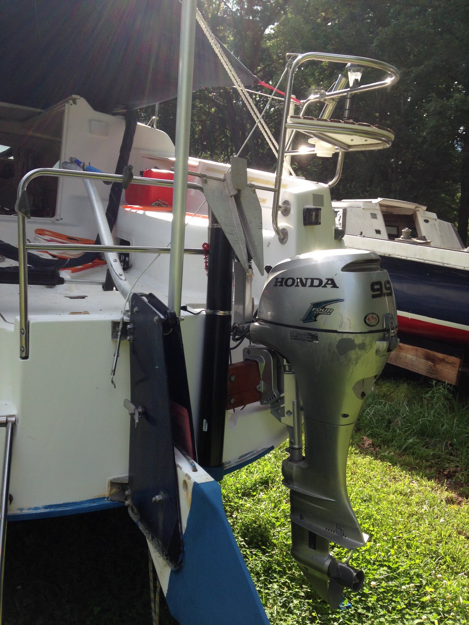

Do you have a stern rail? Although this anchor is a bit small for your boat, it might make a nice "lunch hook" that you can drop from the sern as you enter a cove. I had this set up on my Hunter 26. The rode ran along the outside of the stanchions to the bow eye.... It worked very well... I would come into the cove at about 2 kts and drop the hook over the stern... when it dug in, the boat would swing around. I just used a piece of PVC pipe wired to the stern rail with large hose clamps.
