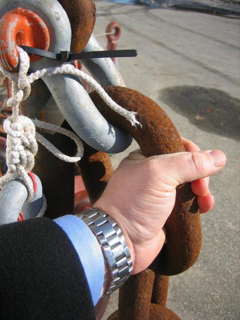

Hi All, Every year in our mooring field, now over 1200 boats mostly sail, we have people break free of their mooring and smash into other boats during blows. During the fall of 2005 our brand new 05 Catalina was hit and cosmetically damaged to the tune of five figures. The owner of the boat, that hit ours, had taken the cheap way out and used inexpensive, Chinese made, imported cast shackles instead of proper forged shackles as he should have. To make a long story short the shackle between his top and bottom chain parted in less than 40 knots of wind and his boat then proceeded to damage seven others before hitting ours.. So the question is this? Do you actually know what is holding your boat where she is moored. Do you know if the shackles are forged or cast? How much bottom chain do you have and how much does it weigh per foot (caternary)? How big is your top chain? How big is your swivel? Could you be the next guy that breaks free in your anchorage or will you rip the bow off your boat before she moves? This is our bottom chain! We have 30 feet of it and use forged shackles. Our top chain is 3/4 inch long link Acco mooring chain and we have a 1 1/4 swivel to Yale 7/8 inch mooring pendants. Is your mooring safe?? What's your set up like?? Can you sleep at night when it blows??

In Salem harbor 95% of the moorings are commercial ,rented. These are inspected every spring and replaced as needed . We don't see many problems with these moorings . The other 5% are private and we see lots of problems with these . People always go cheep and others end up paying . I too have been hit by a boat that broke free and did major damage in the commercial field . When the boat fetched up on the beach ,the pendant was there along with 15 feet of 4/5 year old chain . One other thing of note , in your photo the shackle is moused with a plastic tieback . The black ones may be UV protected but I would never trust one of these . Go with copper wire even if the is a small risk of corrosion .

I actually used Monel seizing wire. That photo was taken before I had fully rigged it and dropped it in the water and one of the boat yard guys knew it was going in in a few days and he tightened everything and stuck zip-ties through it. I went back and found it that way but re-did it to my liking and also braided on my pendant float balls to keep my pendants from tangling in my top chain.. Our anchorage has very strict two year mandatory mooring inspection that can only be done by approved mooring service companies. They also have rules about mooring size but NOT chain size? Unfortunately, there are no rules about storing anchors on bow rollers (which essentially slice through the pendant in a storm), the use of chafe protection or using forged shackles. I'm actually working with the town & harbor master attempting to get some of the rules changed for better safety.
