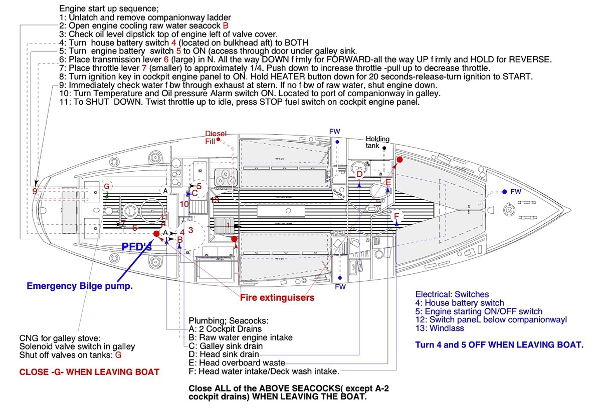

About 5 years ago our son started operating the boat. The boat is a kind of quirky so I drew up a "key" on one page that could be stored in panel right next to the companionway(I keep the registration there as well).
Thinking, what do I need to let an unfamiliar operator know (boatyard employee) to operate the engine without damage. Our boat is not set up for charterers,...And what are the most likely areas to check in a sinking(thru-hulls).

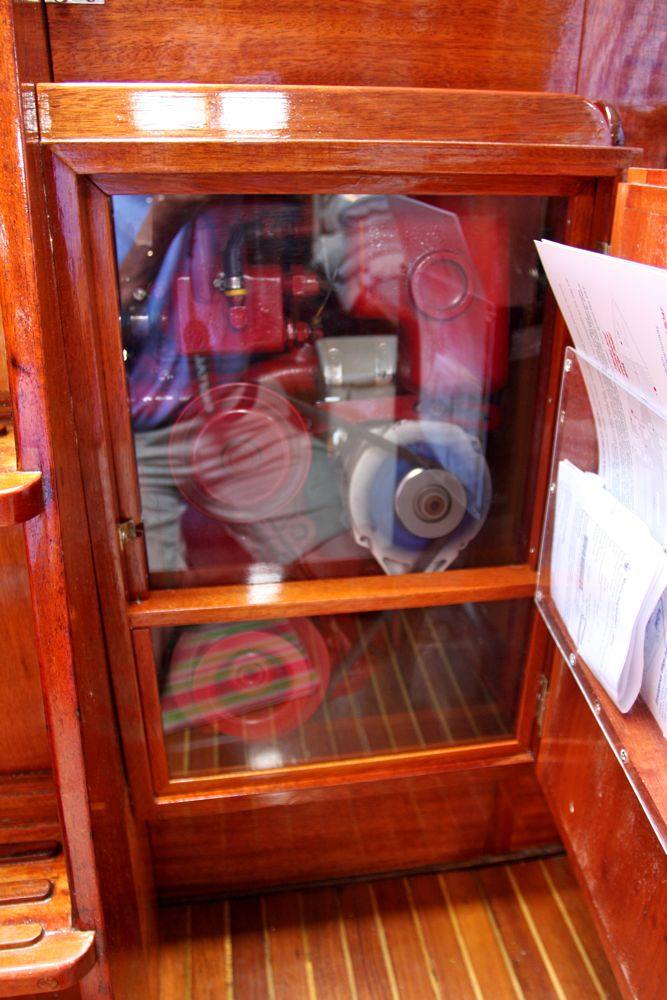

He referred to it whenever he was on the boat. I haven't upgraded it since (a few things have changed)but still the 'key' is there. We bought him his own boat, that is less stressful. :)
