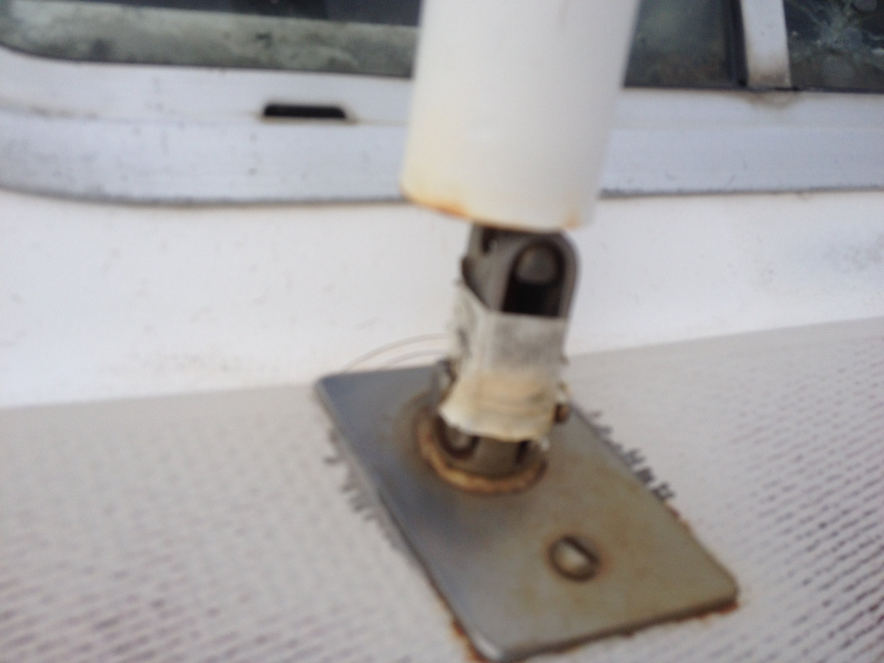

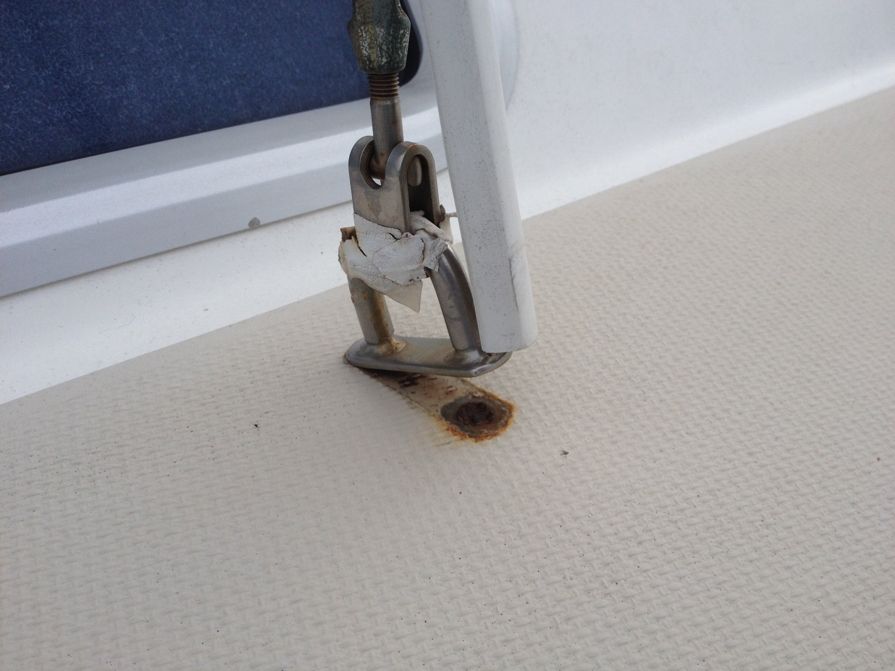

There is a Cat 30 on my dock with a detached lower. I don't know if the owner has spotted it.
Appears to be an early 80's boat.
It looks like the U-bolt was skimpy to begin with, and then it was eaten by years of water intrusion.

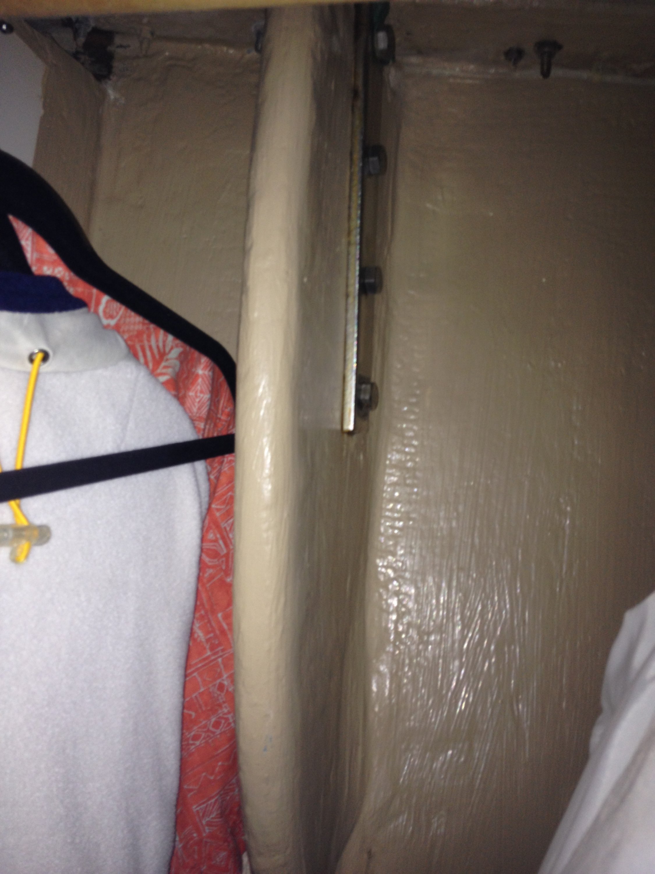

I've included a picture (first pic). Also, for comparison there is a picture of an older Catalina (2nd pic), I think '70's with the hullside nav lights, and it appears to have the rod style chain plates.

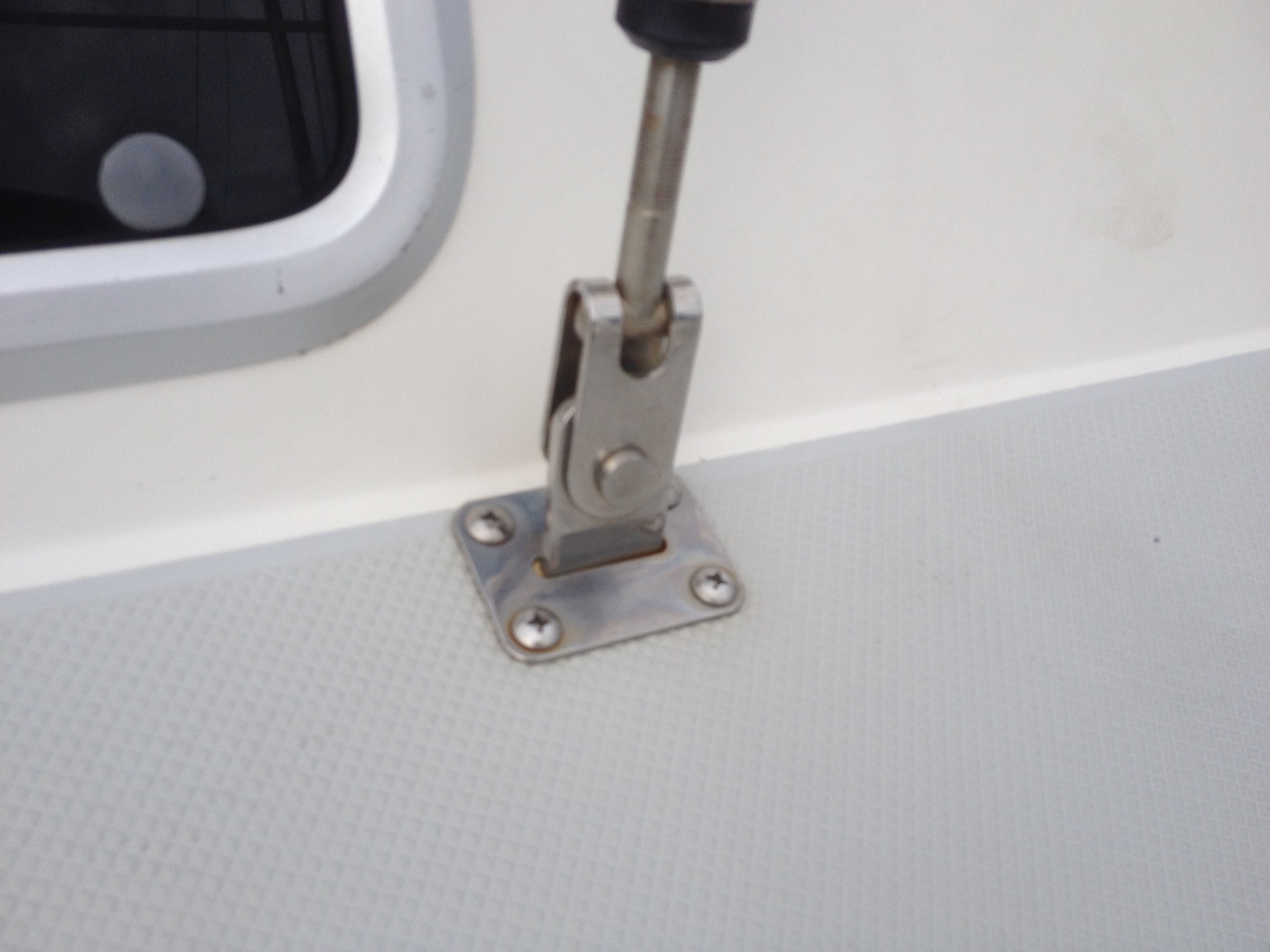

Plus a picture of a Cat 320 (3rd pic) also on my dock, with a proper chain plate on the lower. BTW, the 320 has a surprisingly substantial rig. Very robust.

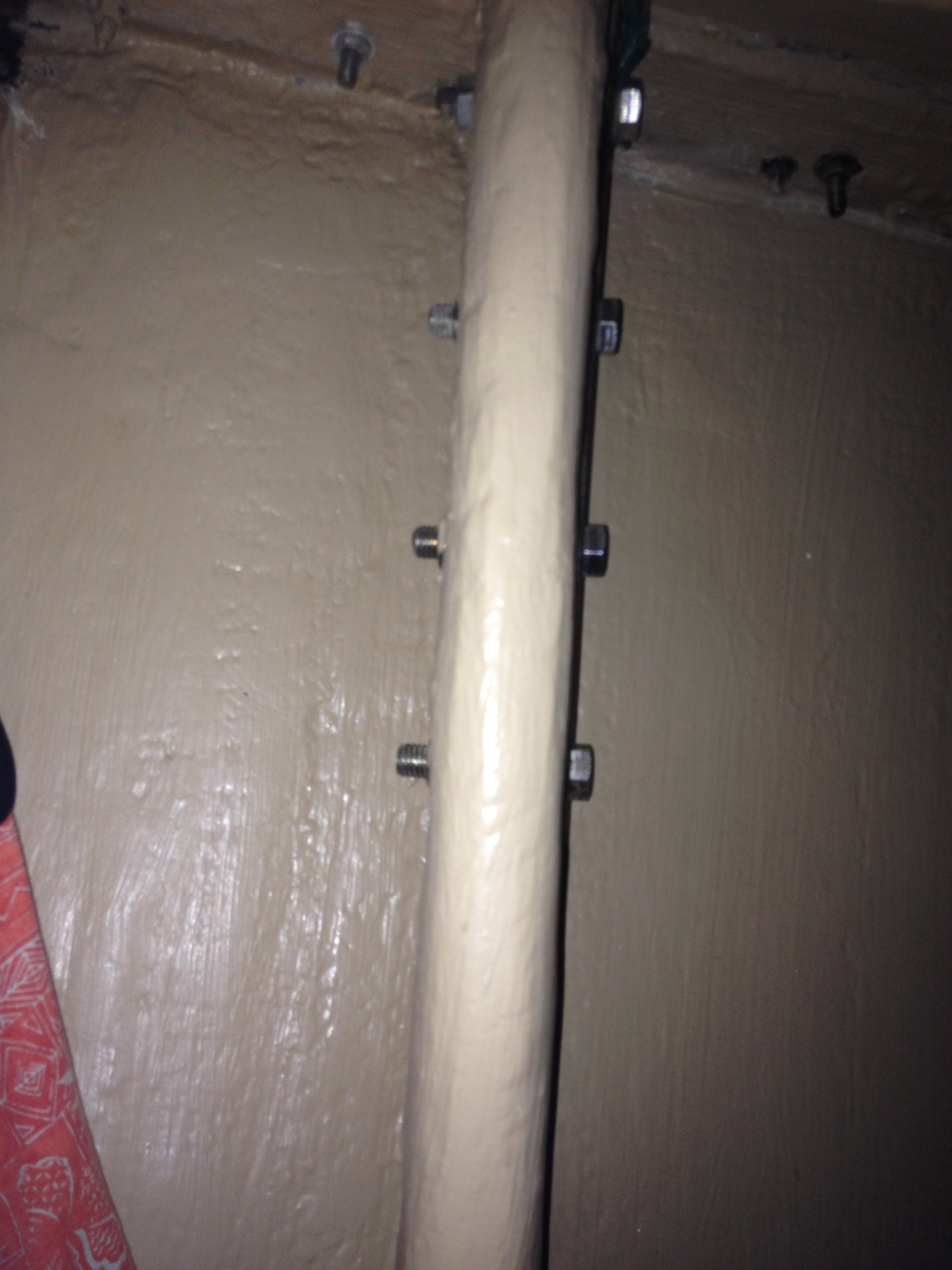

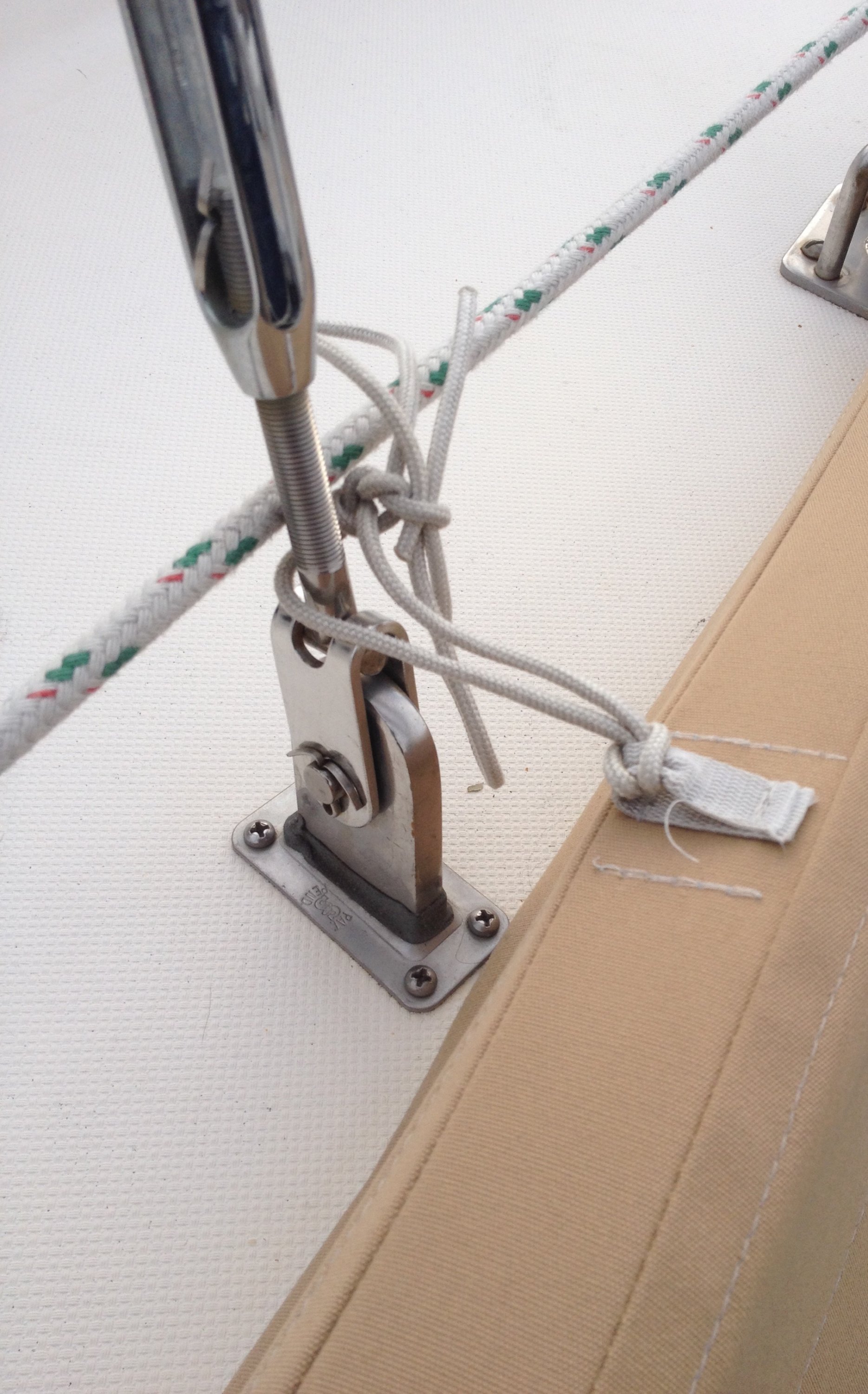

Additionally, I've included pics of one of my shroud chain plates (last pics) mostly because I like to post pictures of my boat, and not because of any relevance :-D
Just a heads up in case anyone can use the observation. ---See something say something.
