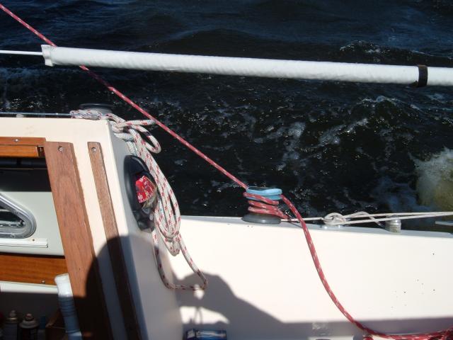

I don't agree with that assessment/conclusion, based on both experience and what's been said. They are not intended to make normal winches into self tailing but they physically function that way because when the wrap builds up, the standing part of the line goes into the cockpit. There's not much real "tailing" required, compared to regular winches. No more than I have to do on our real self-tailing winches by assuring that the end comes inboard.
My experience, linked in a thread above, is that I rarely used the cleats on the our coaming and just let the friction of the built up wraps do (all of) the work.
