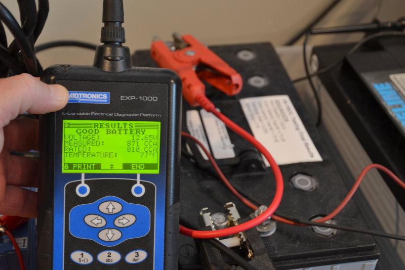

I will get a battery tester so I can do a battery load test.
Through my years of boat ownership I have discovered a few resources to get or improve my understanding of the systems we have on our boats. MaineSail’s articles here on SBO and his website “MarineHowTo” are resources I use to understand or clarify the mysteries of boat electrical systems.
Here is one of his articles dealing with battery testers and the test used to understand battery health.

I start with measuring the batteries again, this time with and without load and see what the outcome is. Following the link from jssailem it appears that battery load testers are not as useful as expected. The ones from China seem to be flat out garbage, random number generators. Oh well, who would have thought that. :rolleyes: But what to do now, as a mere mortal without thousands of dollars to buy battery testing equipment. There may be places where batteries can be tested appropriately. However, that will unlikely be for free and may add significantly to the price of a new battery in the case that the tested battery is bad.
In the end it might be less expensive and labor intensive to just throw out the old batteries.

I agrree (if you can) test all components. But not everybody might be able to do that and testing a battery with the equipment I have on hand might not give me reliable information at all.
24,746
While battery tests at auto shops are good for cranking power and not super for status of health on a a marine boat system. They can give you a data point to help in your process. If the battery is dead the test equipment can indicate this. Most shops will test for free as it is a marketing model to selling you your replacement battery. You can ask the shop about this service.
You can run your own State of Health tests. The procedures are outlined here. How do I test AGM batteries for damage from overcharge?
Or if you can still read the date code of your batteries and your satisfied with the service they have given then head to the local battery store and charge up your system.
