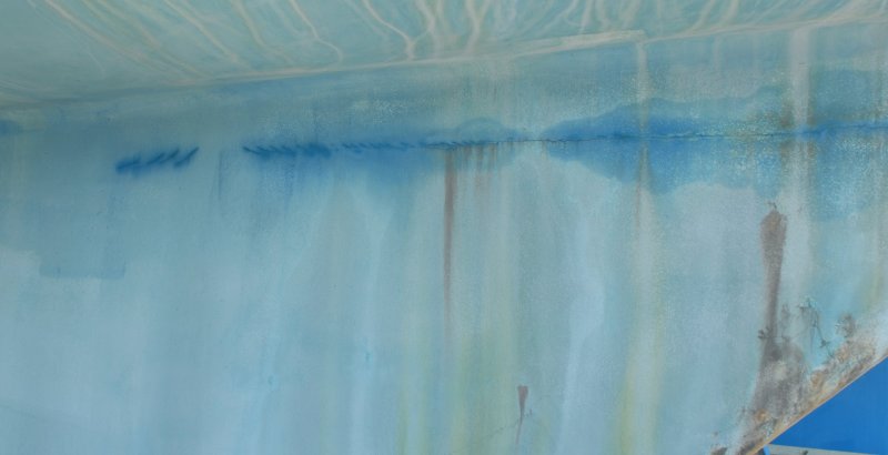

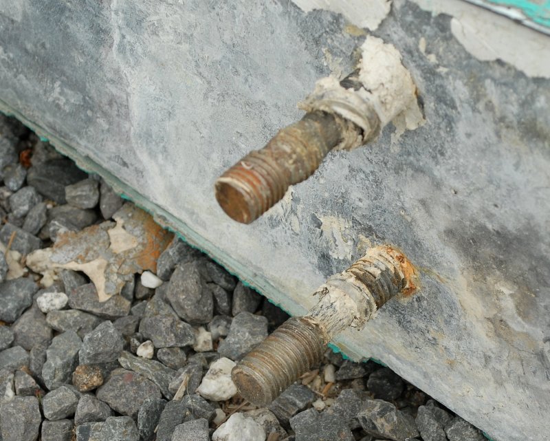

3) If your bolts are loose and you have a visible keel joint crack that leaks water for more than a few minutes after haul out you are running the risk of keel bolt crevice corrosion. This is the apparent melting of stainless from being submerged in oxygen deprived salt water. If your joint is wet and leaking the only proper fix is to drop the keel and re-set it..
Keel joint leak (photo taken in spring after months on teh hard and still leaking):
Crevice Corrosion:
