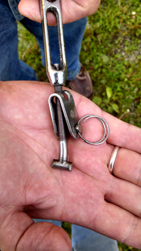

J jfschena . Nov 1, 2012 108 May 30, 2015 #1 Think the answer is yes. Just looking for validation. Thanks

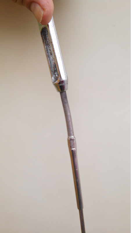

Stu Jackson . Feb 26, 2004 23,544 Catalina 34 224 Maple Bay, BC, Canada May 30, 2015 #2 Yes, but just those parts. If the second picture is the connection of the backstay to the turnbuckle, then yes to the question.
